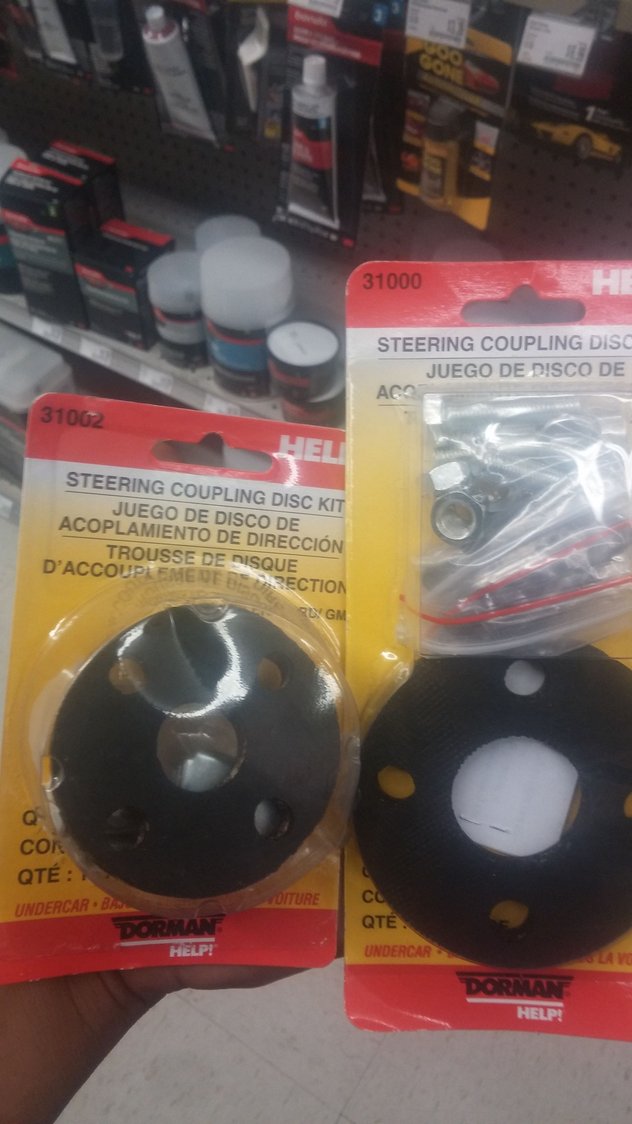

Im in the process of this. I cant believe i didnt see this post before doing mine.
I chose to grind the rivets. Replaced the rivets using 5/16-18 hardware. Then discovered i might end up needing to double them up. That is were i got stuck. Ran outta daylight and the parts house was closed also need to pay a visit to the hardware store.
My recommendation is dont spin the wheel u might break clock spring if u got 1
Ill findout in the A.M

The one on the left.
