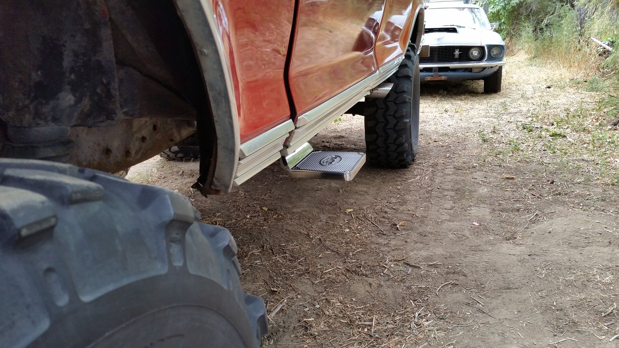

My brother and I were looking for a set of side steps for his '72 Highboy build and we were looking for something clean and simple similar to the TEDCO steps on my '75 highboy. We found some polished aluminum model A side steps on ebay meant for the running boards of the old fords and fabricated a step to mount the polished plates onto; I think the end results looks really nice. Handsome, simple, and not too bulky.
I have not seen this done before but it's pretty straight forward. If I do it again I would try them in aluminum as these stainless steps are probably about 10-12 lbs each. I still need to drill a second set of 2 holes mount another bracket that helps sandwich them to the under side of the cab.

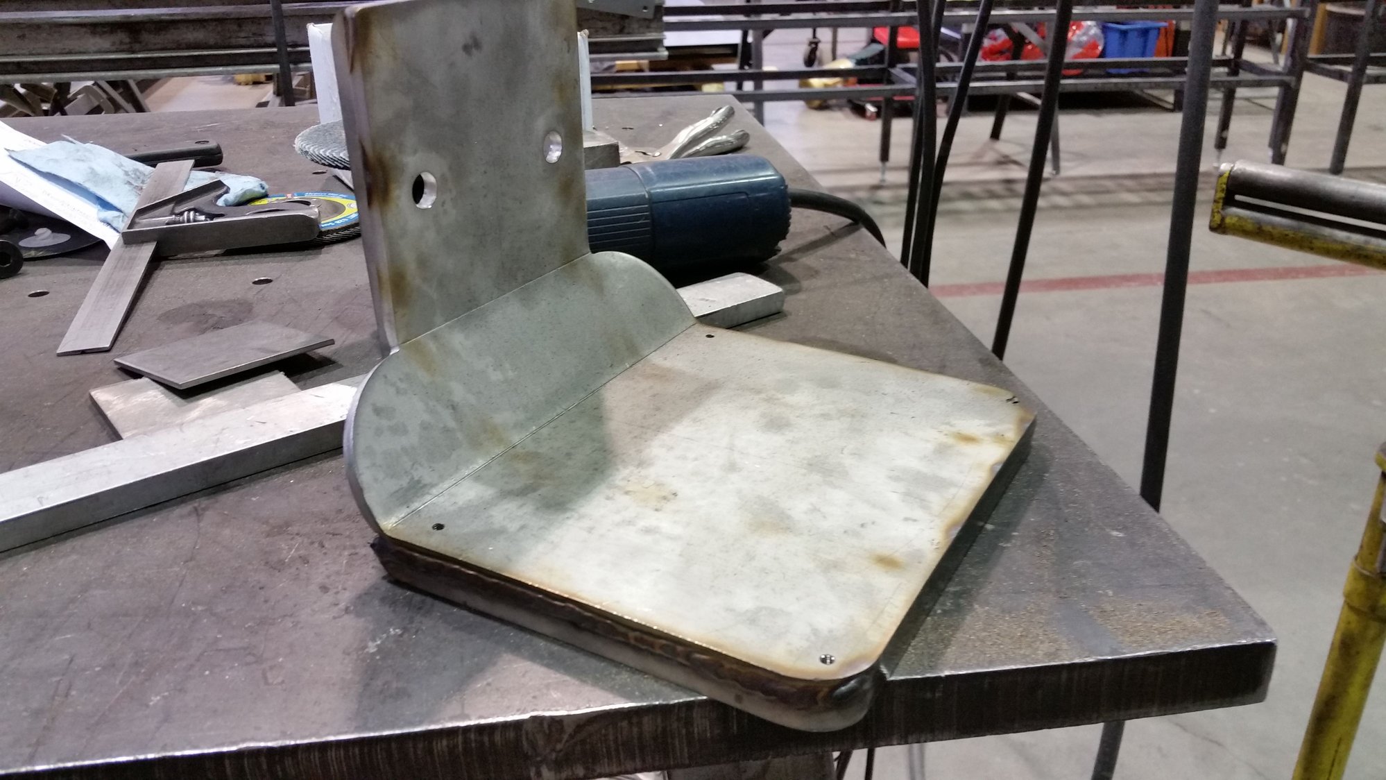

I started with some stainless steel pieces hot off the laser (I love working at a manufacturing fabrication shop!) and convinced our best welder to glue them together.
with bottom skirt added and 10-32 holes transfer punched from madel A plates.

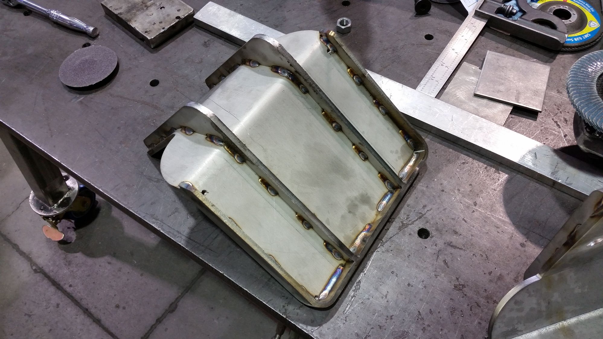

all TIG welded & looking good. The steps had to get flattened in the hydraulic press due to the warping from the TIG heat

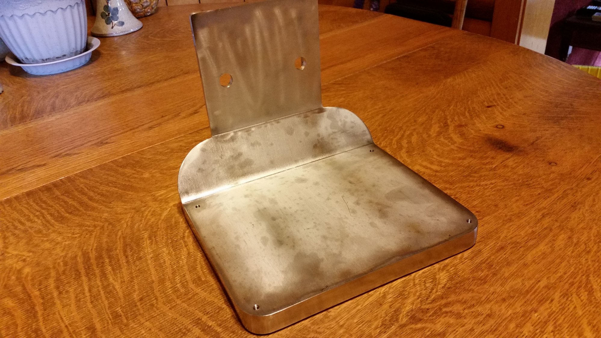

After hours of grinding down weld beads and some time on the Burtex wheel the step base looks like this.
With the step plate attached
Installed on my '75 to get an idea but ultimately destined for a silver '72 highboy.
