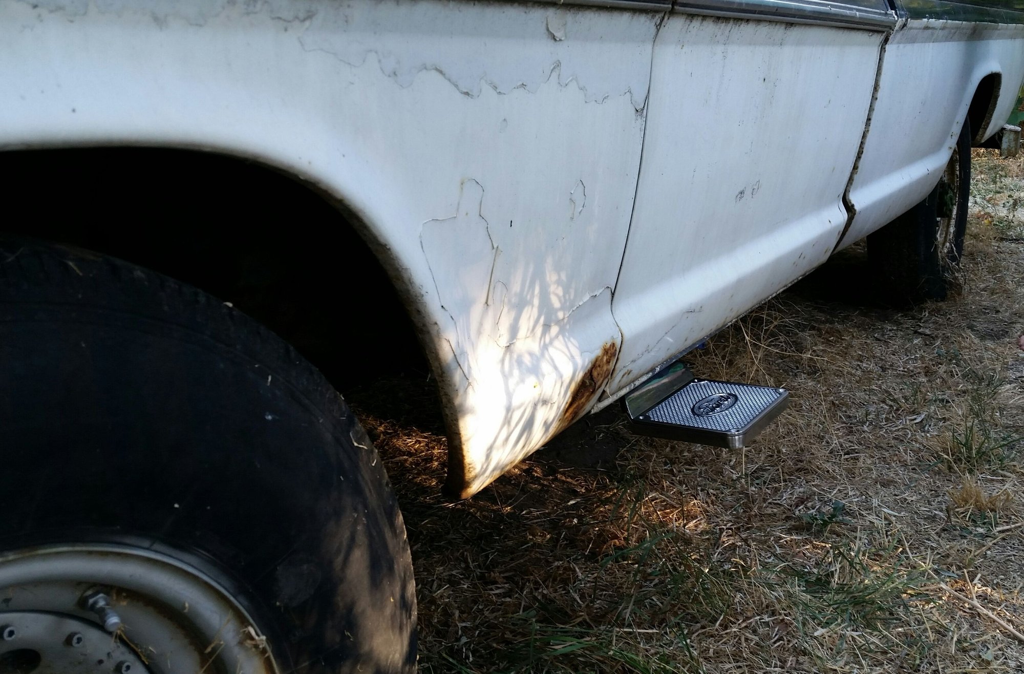

I clamped the step onto the '67 just to check things out. The under cab bracing is different but I didn't measure the differences. The neat thing is you can add a spacer between the step and the under cab brace to adjust how far the step protrudes from the cab/recess the step closer to the frame. It stuck out a little too far for my liking on the '75 so I would recess it an inch or two in that case - not sure what will happen when it gets installed on the '72 highboy.

Very nice steps. I'd copy your idea, but I'd destroy them. My passengers always complain about too tall truck.

I'm going to run an aluminum version through a stress simulation program to see how they would handle fat chicks so that might be an option. If I made more sets they would probably be MIG welded instead of TIG, glass beaded to clean it up, then buff/polish the outside skirt. This set is all 1/4" 304 stainless which is plenty beefy but I'm curious about 1/4" aluminum.

destroy? I know you have the fab skills - you must mean bash them on something? The TEDCO steps have seen lots of abuse and have lasted 40 years, but then again I have never hit a stationary object with them.

1/4" aluminum with gussets would be strong enough.

I would recommend just making the frame and sell the frame and let people buy their own step off lmc or wherever. save you some overhead and a headache. but id deffinatly be down for a set of frames. cus like they said not everyone has a welder or the time.

Alright guys, you've twisted my arm; I will start making additional pairs of side steps for interested buyers for '67 to '79 trucks. I have the pattern done for the '67-'72, and I will have the bolt holes modified to fit the '73-'79 by this weekend. I'm going to have aluminum parts lasered out next week to make an initial set in aluminum.
I can't forecast the prices or lead times just yet but I will post updates to this thread as they come along.
So who likes aluminum and who likes stainless? (powder coated carbon steel is also an option)

Wouldn't a stump, log, or small rock would destroy your handiwork? Nice touch.
Along with the outer floor and door sill area of the cab I think.
They look "great" being all shiney and such, got a nice logo on them too.

What about some sort of side brace to keep your foot from sliding off? While you're out in the mud and muck your shoes will be slick.
