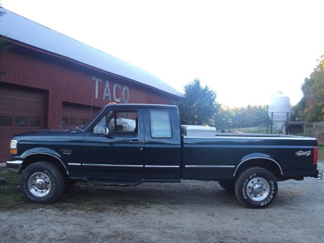

So I came back with this last week, '97 with with now 112,000 miles.
The transmission issue is intermittent and worse on down shift, up shift not a problem. I filled it with Royal Purple today, and though it made gear engagement much smoother and softer, it didn't appear to help the "chunking" when downshifting to 3rd.
It lost about 4 quarts of oil over the 1000 miles I drove, a steady 70-75 for 14 hours. Oil galley plugs on the passenger side need to be replaced.
Also, it appears I will be getting new glow plugs as it is not taking kndly to the cooler temps here in Vermont (plug in the block heater for 20 minutes and it starts right up).. Original owner said he replaced two burnt ones (I found Autolight 1111 in the glove box) I hope he didn't only replace 2 because he couldn't get the others out. I'll be ordering the Motorcraft ones and likely new valve cover gaskets and pig tails while I'm at it.
Overall, very happy with the purchase, steering is super tight, no interior rattles, and as I said it loved the high speed cruising. The body has a few dings but not one speck of rust on it, sheetmetal on the bottom is clean and like factory.
