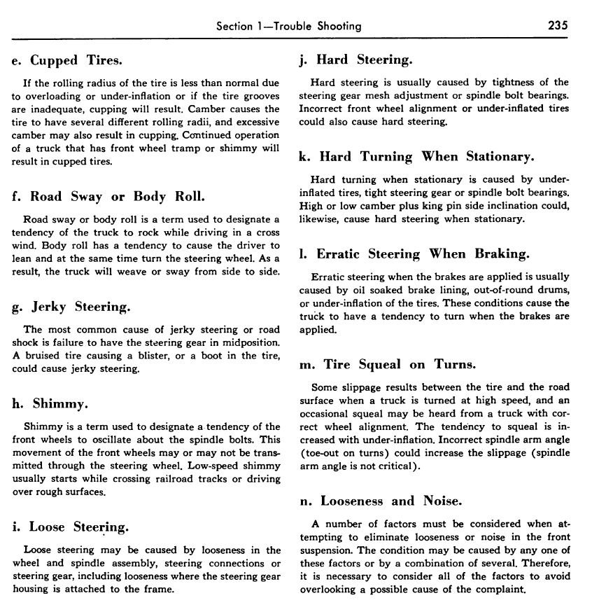

From page 235 of my 1956 manual. Shouldn't be much different than your '54.
Ford F100 Steering Problems
Thanks for the info...been looking for a good repair manual. I think next year will see power steering!
