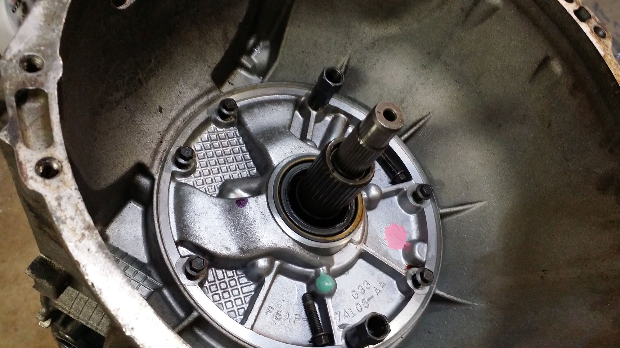

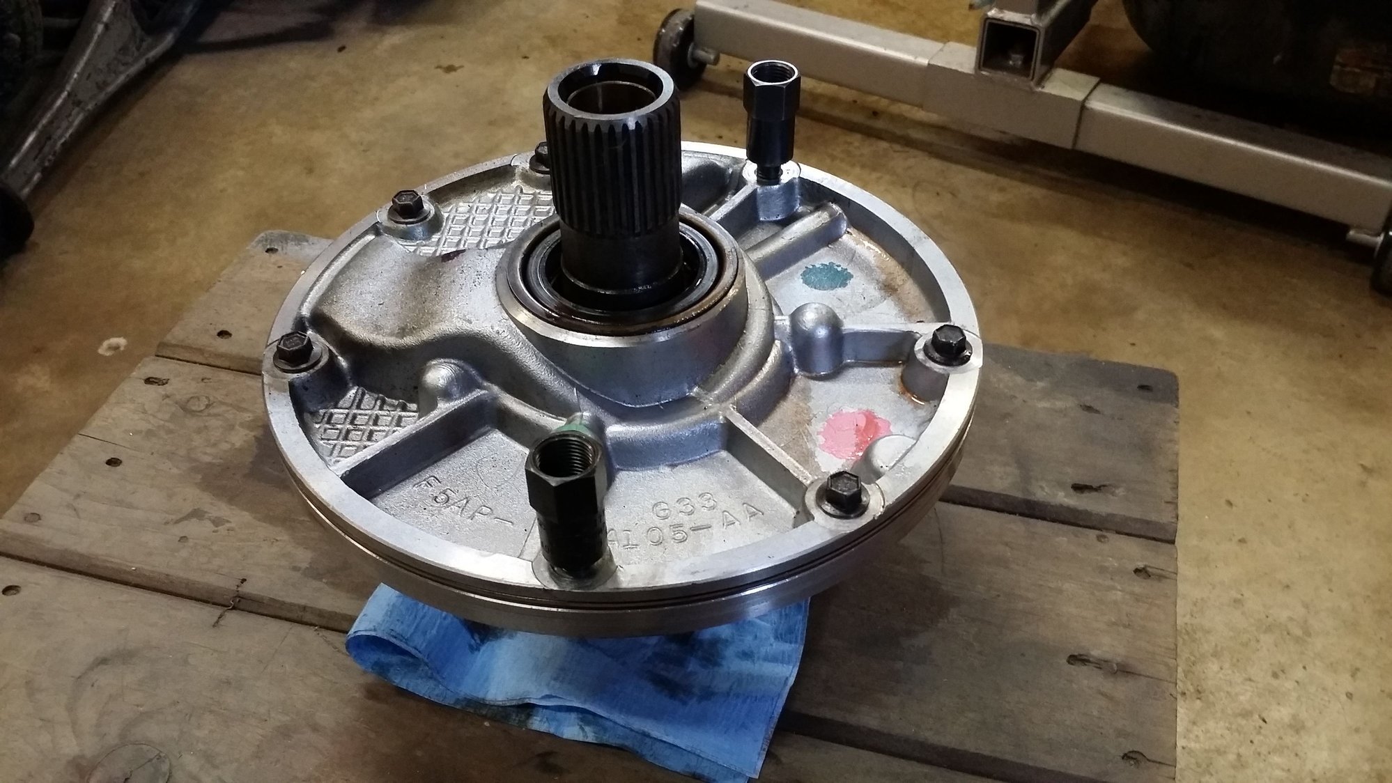

.....this isn't a C-6 (it's my 4R70W) but, there are two threaded holes in the pump to screw some slide hammer adapters into, to remove the pump from the case.
A few bumps with the slide hammer on each side and boom! It's outta there.
If you're going to pull the pump, it only makes sense to replace BOTH the X-ring pump seal and the gasket, as well as the torque converter seal. Otherwise, you're just asking for trouble. --(X-ring because it has square shoulders whereas an O-ring has rounded shoulders).

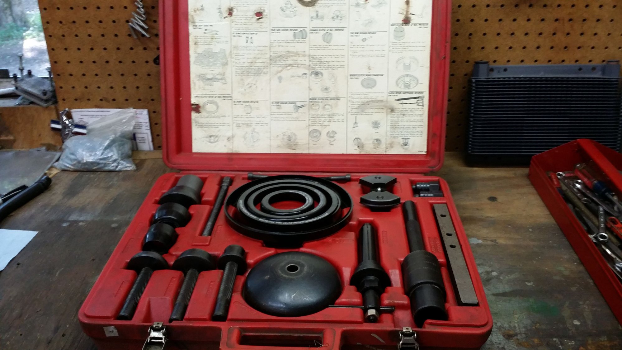

I have a Rotunda AOD transmission service tool set (works with AODE and 4R70W transmissions too) that has the seal installation protectors to keep the seals from being torn/gouged. They are the various black plastic rings seen in the center of the tool set in the following photo.
You can install the pump without seal protectors but, you'll need to be very careful. Lube the seal with trans gel or Vaseline before reassembly into the case.
