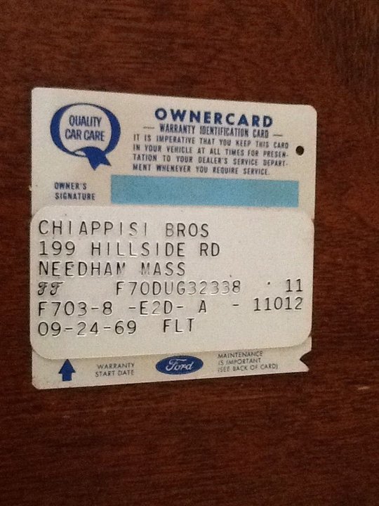

I also have this owner card if it helps:
Old Sep 15, 2015 | 11:04 AM
NumberDummy's Avatar
NumberDummy
Ford Parts Specialist
Posts: 88,826
Likes: 785
From: Simi Valley, CA
G32338 = 1970 (1970 F100/750 serial number range: G30,001-J70,000).
Where is the booster located, on the dash (firewall) or on the frame rail?
