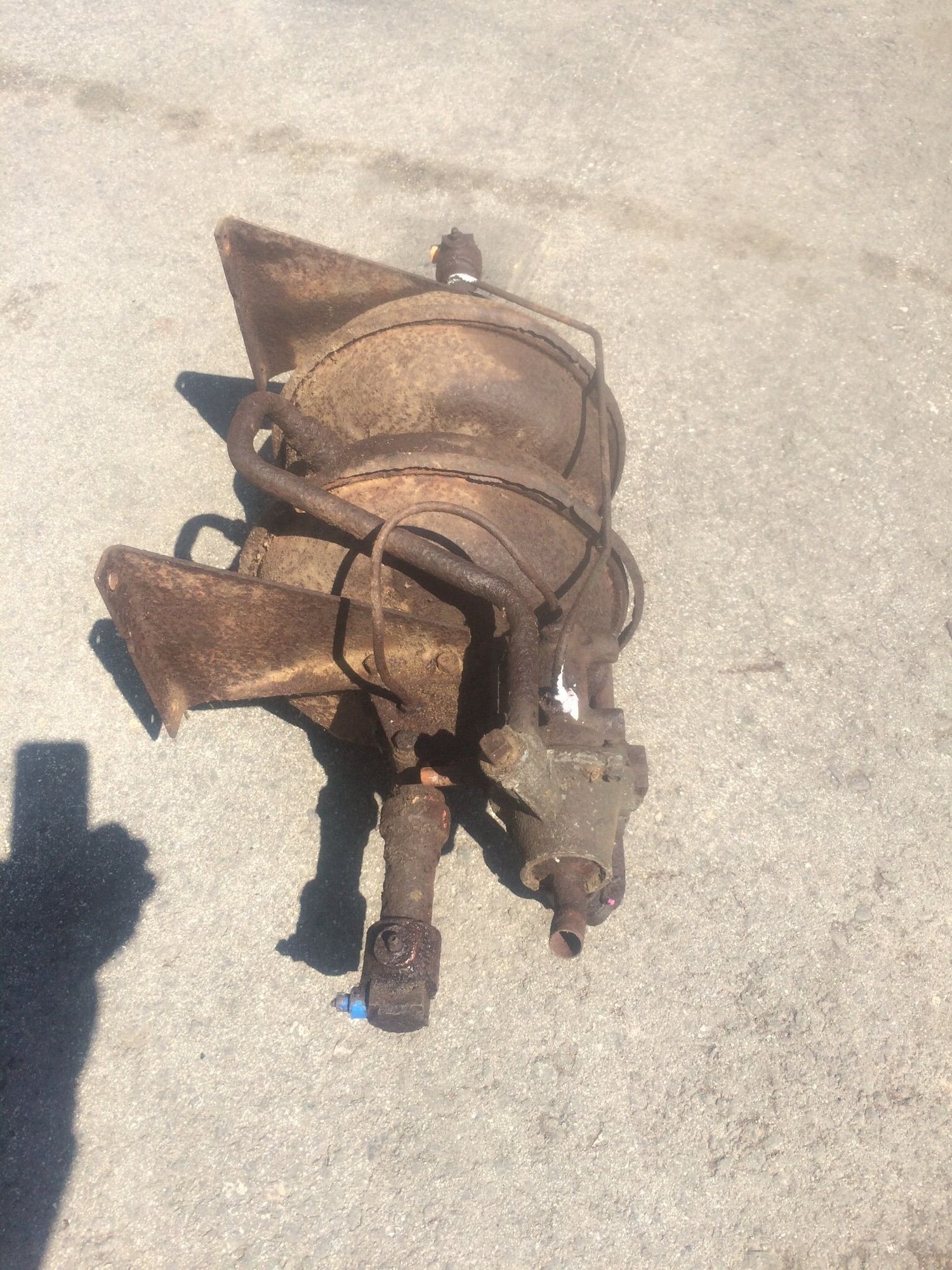

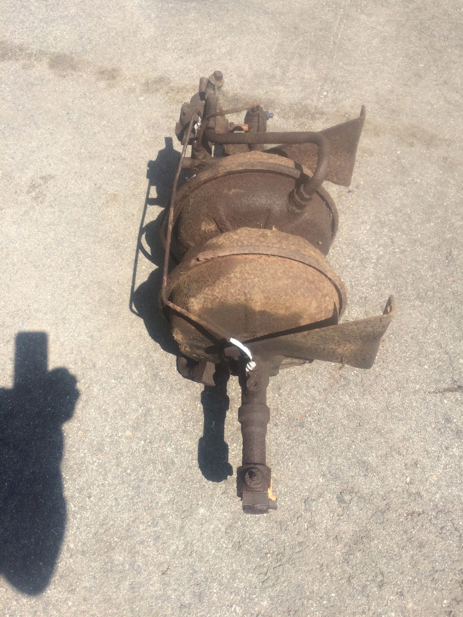

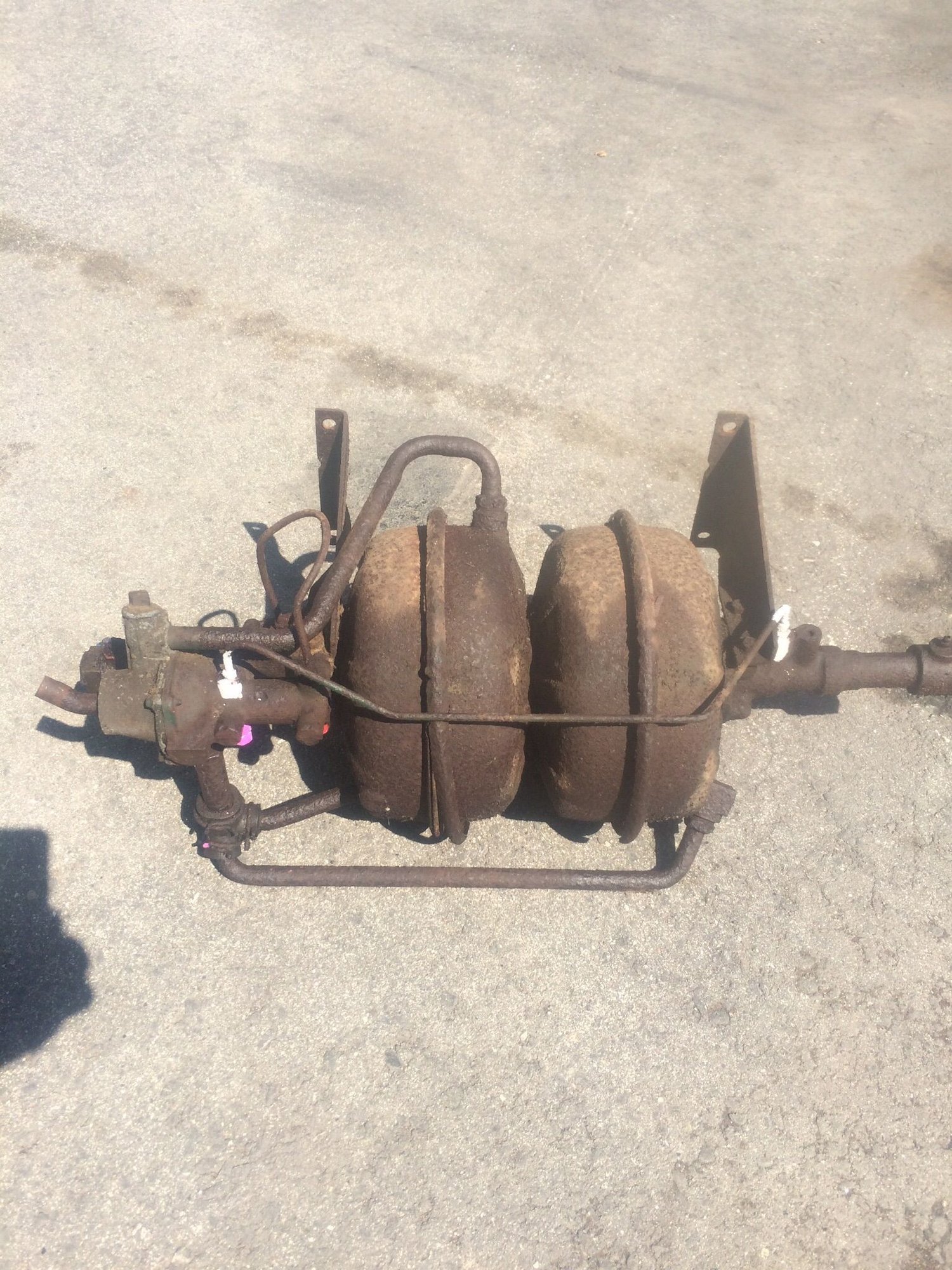

Goodmorning,
Do you have any illustrations and or parts lists of the boosters and master cylinders on lines 113-118?
Bob Allen Ford said there are none in the country and I'm still waiting for response back from Klimesh.
If that falls thru I'm trying to figure out what booster or even two single boosters I can use to replace this:
Thanks for your time.

BENDIX 2509140 Vacuum Booster
REBUILT
Description: Pbr/fdf, 68-73, DUO-VAC
  • Item SKU: 24109659
  • Unit Info: BENDIX 2509140
Vander Haags Inc
3809 4th Ave W
Spencer, IA
877-242-5030
Email Us
View Map
Price: $553.29 with exchange*

El Jeffe: 1970 F700 with split hydraulic brakes, frame mounted booster.
The booster for lines 113/114 was replaced by C9TZ-2005-F / Lines 115/116/117/118 & 123 also uses this booster.
Yep. I did look at your parts book page post. A lot clearer than my fische. I just Googled the Bendix number you posted.
