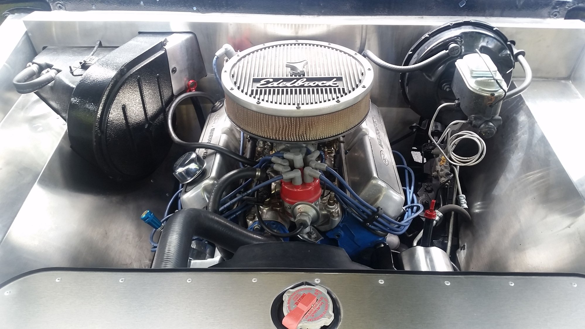

Here are some pics. Just for Fun!

WoW, very nice looking truck.

That is a very interesting looking (and sparse) engine compartment! Firewall, inner fenders, rad, etc. wrapped in .... stainless steel? Hiding all of the wiring and hoses?

Nice truck, nice color, nice eng bay. Sounds like a carb/vacuum or possible elec issue, and you are on the right track to find it. So you do not need a heater huh?
And since all the a/c lines and the heater is not hooked up, you might as well removed the complete box...and really slicked the firewall up.

The engine bay I am assuming was done to hide everything. Kinda makes troubleshooting difficult due to it being riveted on I bought it thinking if the paint and the engine bay are in this good of shape, the person that built it must have taken very good care in building the engine as well.
