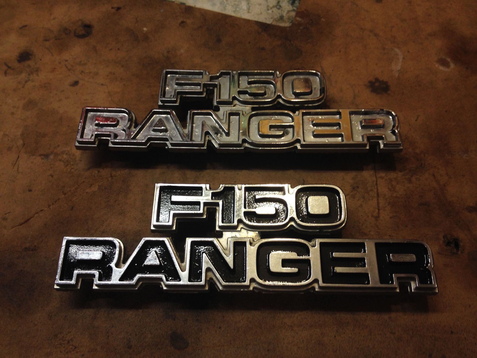

On mine, I just spray painted the black part and then wiped the paint off the high points with acetone.

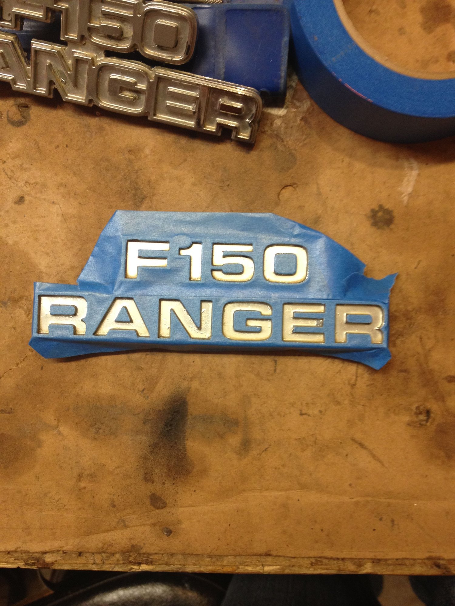

I used painters tape and cut out the letters with a razor blade then used black spray paint.
