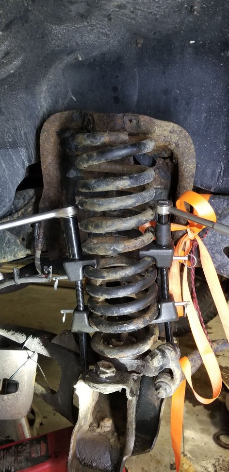

Update time! Didn't have a whole lot of time to get stuff done but I got the old coil bucket out and the new one installed.
I didn't realize how rusted the old bucket was until I took it out. Took my time compressing the springs because the bucket was so weak. I hit the frame with a wire wheel to clean all the flaked rust. I also used 3M undercoating, this stuff is my favorite. It's asphalt based so it's thick and tar-like. I sprayed the frame and the new brackets with this stuff.
To remove the rivets I just use a combination of air hammer with chisel and grinder. Probably take longer than a set of torches which I do not have. I did have to drill one rivet out that would not budge.

That is fun to see!
The before pic on your shock mount just makes me quiver. I can't imagining seeing that on my Bronco.

ooftahhh! that wholy bucket.

Yeah that scared me, glad I stopped driving it.
So I also have a question, I have adjustable Moog Camber bushings installed, they are probably 6 years old with a little surface rust on the inside. Should I completely replace these as well or just leave them and clean them? I suppose if I replace them I could match the position of the old one and have it checked again when I get new tires + alignment.
