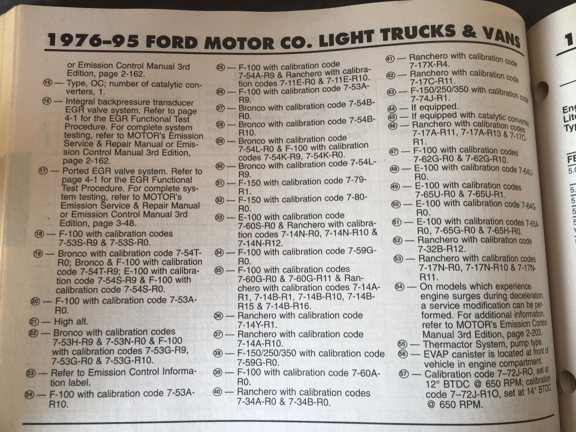

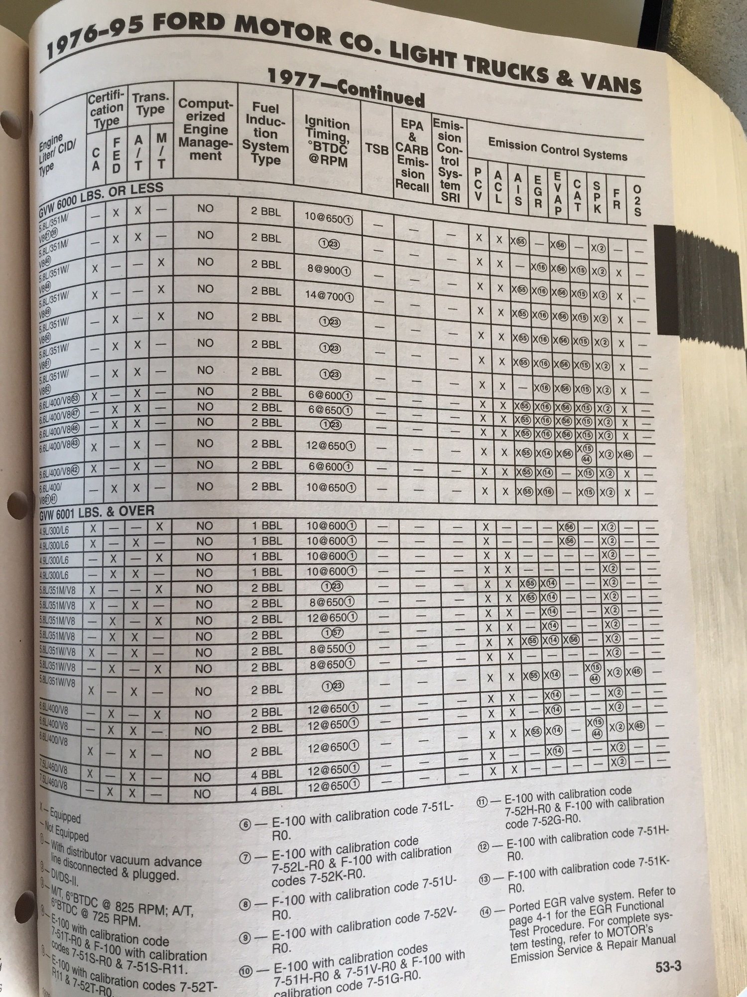

If the truck did not have Thermactor Emission, these pics were redundant, so parts guys ignored them.
Any other questions?

THANKS, I WAS JUST LOOKING AT THOSE PHOTOS IN THE PARTS BOOK. THANK YOU ALL. I GUESS I DONT NEED THE EXTRA STUFF.
