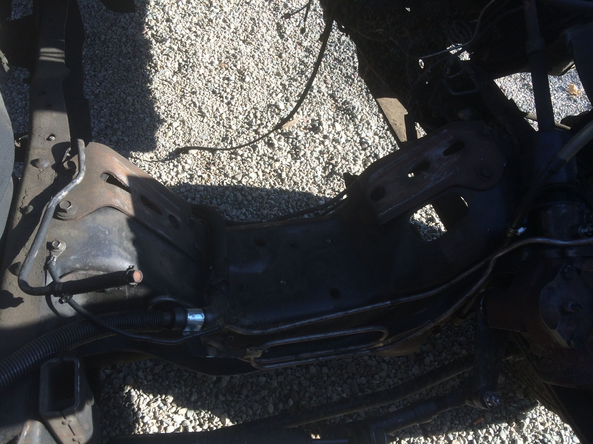

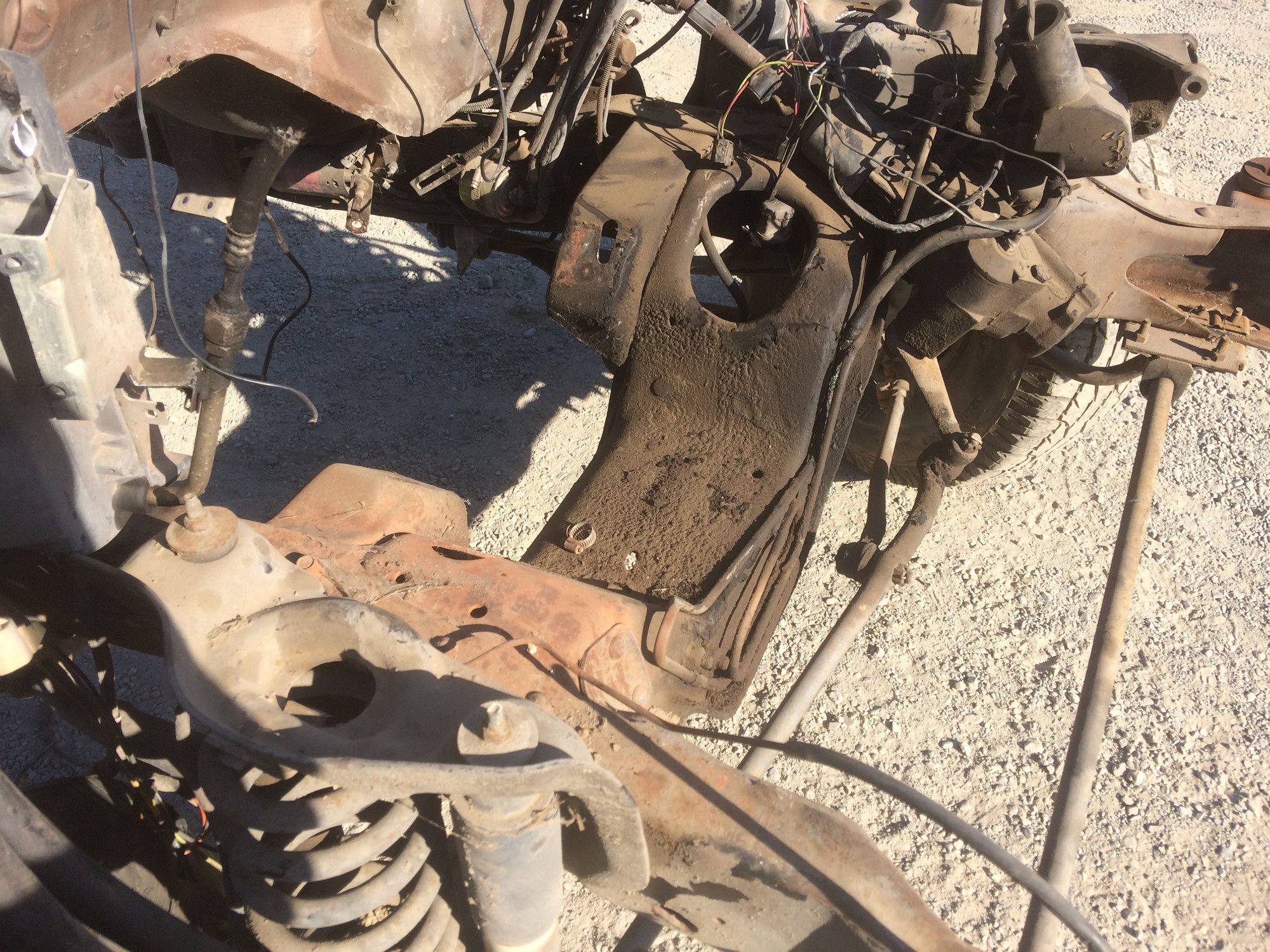

also, heres a few pics of a bronco i just tore apart, you can see the rear 2 pieces that are riveted, that need to come out.

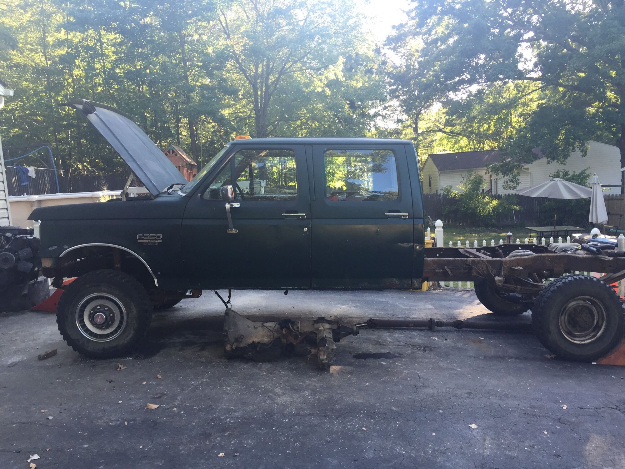

and a pic of my 87 F350 with the lower pads mounted on the cross member, this is what youre looking to achieve.

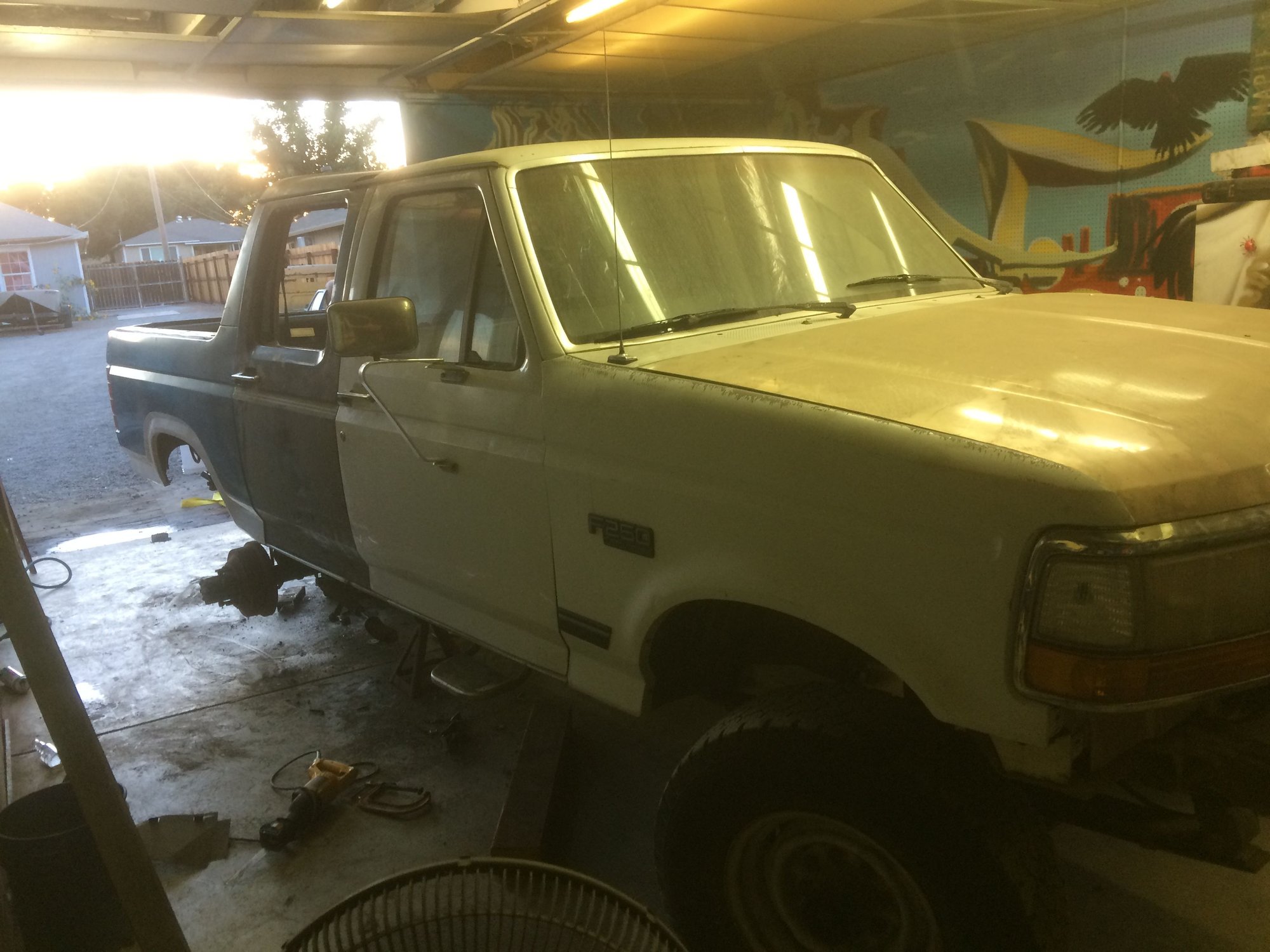

Some before pictures
Originally Posted by Funchiemonkey
So I stopped off at my buddy's house and he handed me a bin full of wires a computer fuse panels harness's and ect . I was switching to avoid all the electronic bullcrap and now I'm in for more then I had before . Apperantly I need all of this to control the transmission or it will not shift and I cannot find those brackets anywhere I did see what I am missing . Diesel stuff is very hard to find in a junk yard and well you guys know the rest I suppose I will keep ( plugging ) away at it and hopefully I will be satisfied with the end result

thats an odd crossmember for a 88 F350.
my 89 gasser frame is exactly like my 87 diesel frame.
