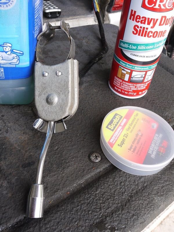

Decided to remove, disassemble and clean up the switch if it looked usable. It was pretty crunchy feeling and the bulb and lens is missing from the stalk.

Not much to it but, pretty dirty inside.
You can see the rust and funk.
I carefully pried the tabs away from circuit board base.

Soaked it for maybe 10 minutes, rinsed it with a garden hose, brushed the heavier stuff and it looks like new.

The difference is night and day.
It even came clean down in the socket on the end of the stalk.

I gave it a baking soda rinse, let it dry and then shot some silicone on it to protect it from corrosion. Re-taped the wires and put it back together. Found a bulb and new bulb cover on line for it.

I'm very impressed! Did that Prep & Etch remove the paint too?
