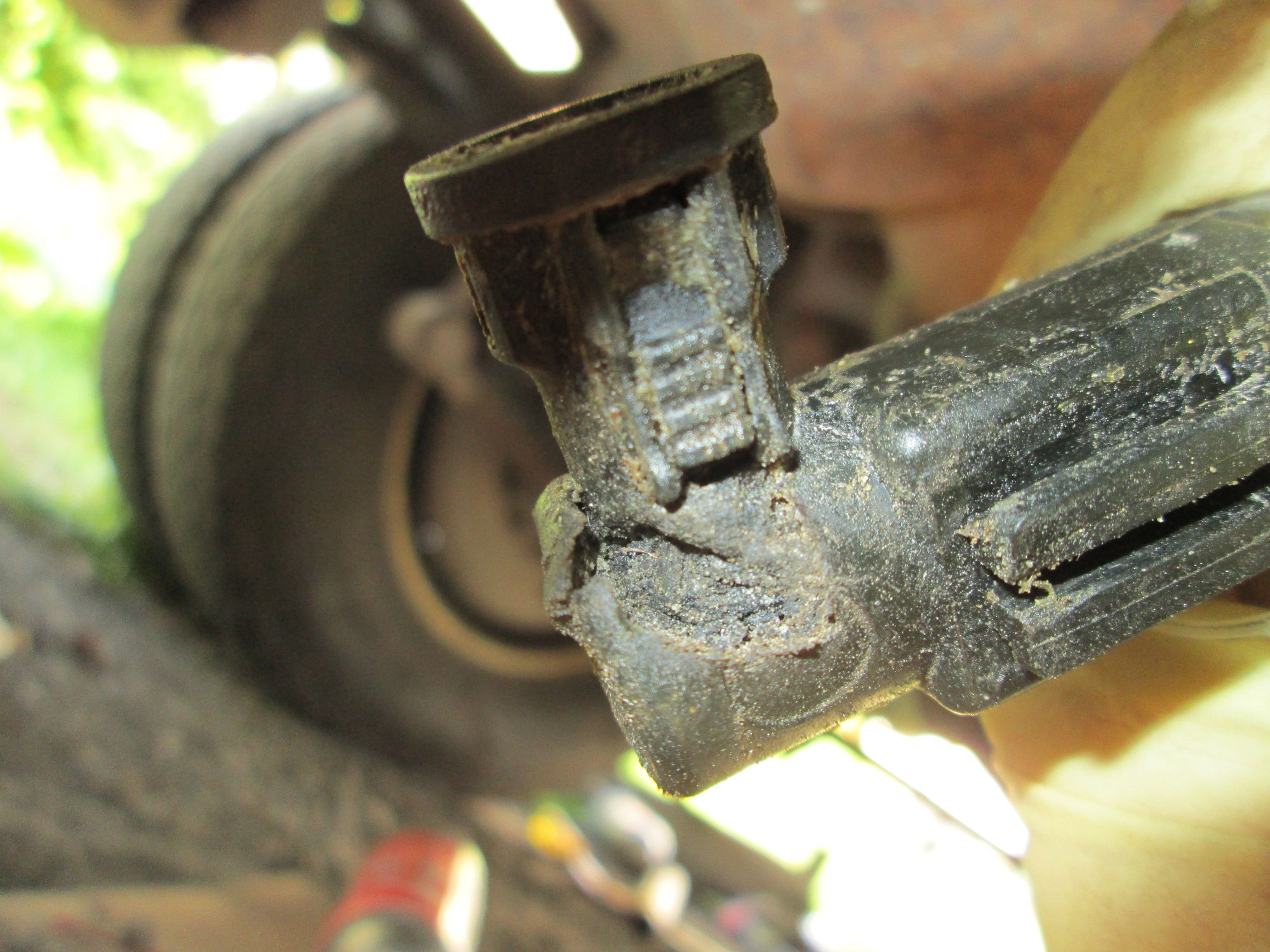

well I may be on to something here...
I noticed heavy crystallization on the "line to pump" connection. This could be why (see pic)
PS- 190,000 miles and its a 2011..
Hm.. doesn't look good!
Nope... There were some sort of gooseneck rails in the bed at some point. (previous owner) Looks like maybe a drill bit caught it..... The strange thing is, I think this would have happened when it was new or close to it !
Wow, that connector looks BEAT..!!!
Now that I think about that, same damage happened to another forum member, maybe even on a different 6.7 forum idr. But he ended up getting the hitch company to pay for the fix that Ford did. IIRR the repair cost was huge, but the hitch company finally paid. He had pics up that showed almost the same type of damage.

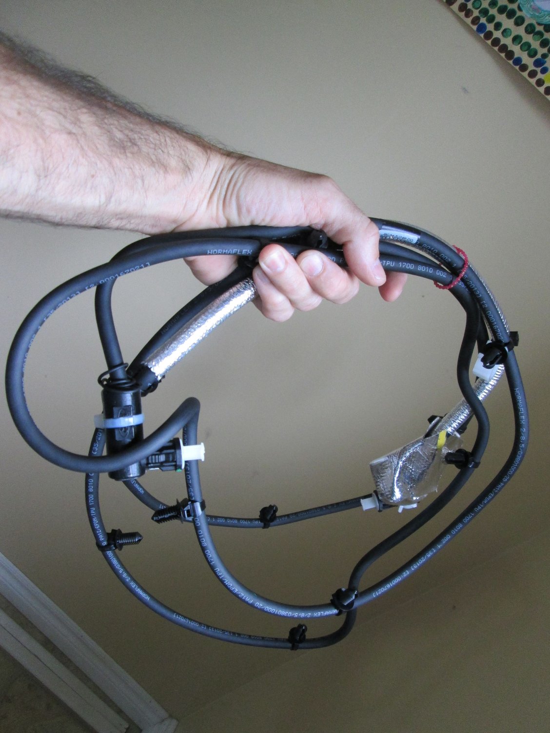

Well... $400 (Canadian $$) later, I have this. Sure hope this is the only faulty part !!
