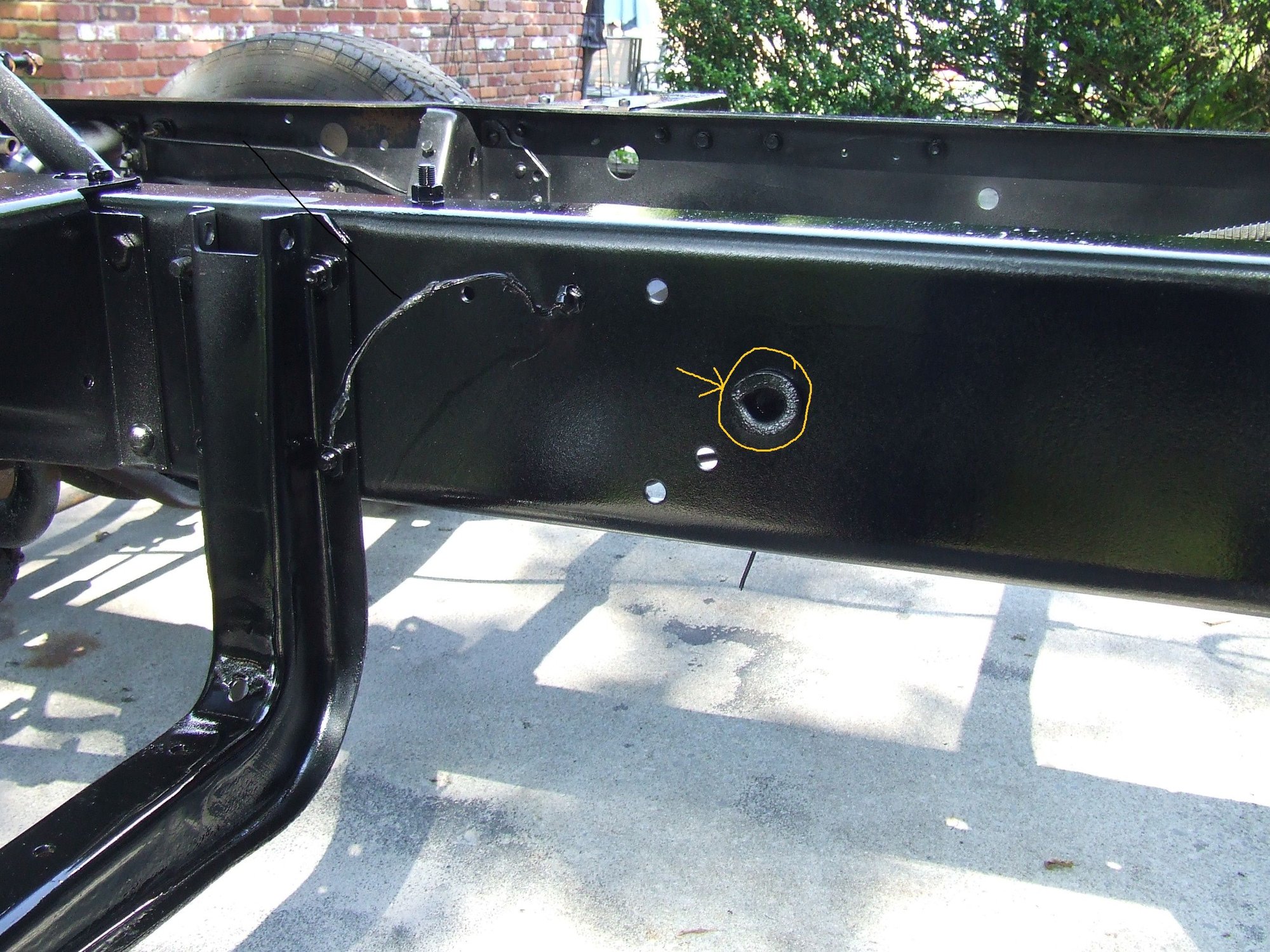

When I was cleaning and blasting my frame I noticed on the drivers side near the gas tank was a hole and grommet near the tank but no line or wire running through it. I looked through all my manuals and illustration guides and find no reference to it's use.
I find it odd that its so close to the outlet of the gas tank yet all reference material I find show the fuel line running above the frame. Anybody know it's use? There's one on the passenger side frame rail also.

I ran the gas gauge wire through there.

My fuel gauge wire came from there.

Ford drilled/punched all the same holes in both frame rails even if only was used on one side i.e. steering box mounting holes and pitman shaft hole. I suspect the holes were punched while rails were still flat before being bent into a left or right.

This is the grommet I was referring to. Both sides a grommet in them but nothing running through them-

In my experience, on the '53-'56, (passenger side) this is where the battery cable runs through to the starter relay. And (driver side) where the fuel level sending unit wire runs through to the harness. Both of the '53 trucks I've owned were original.
