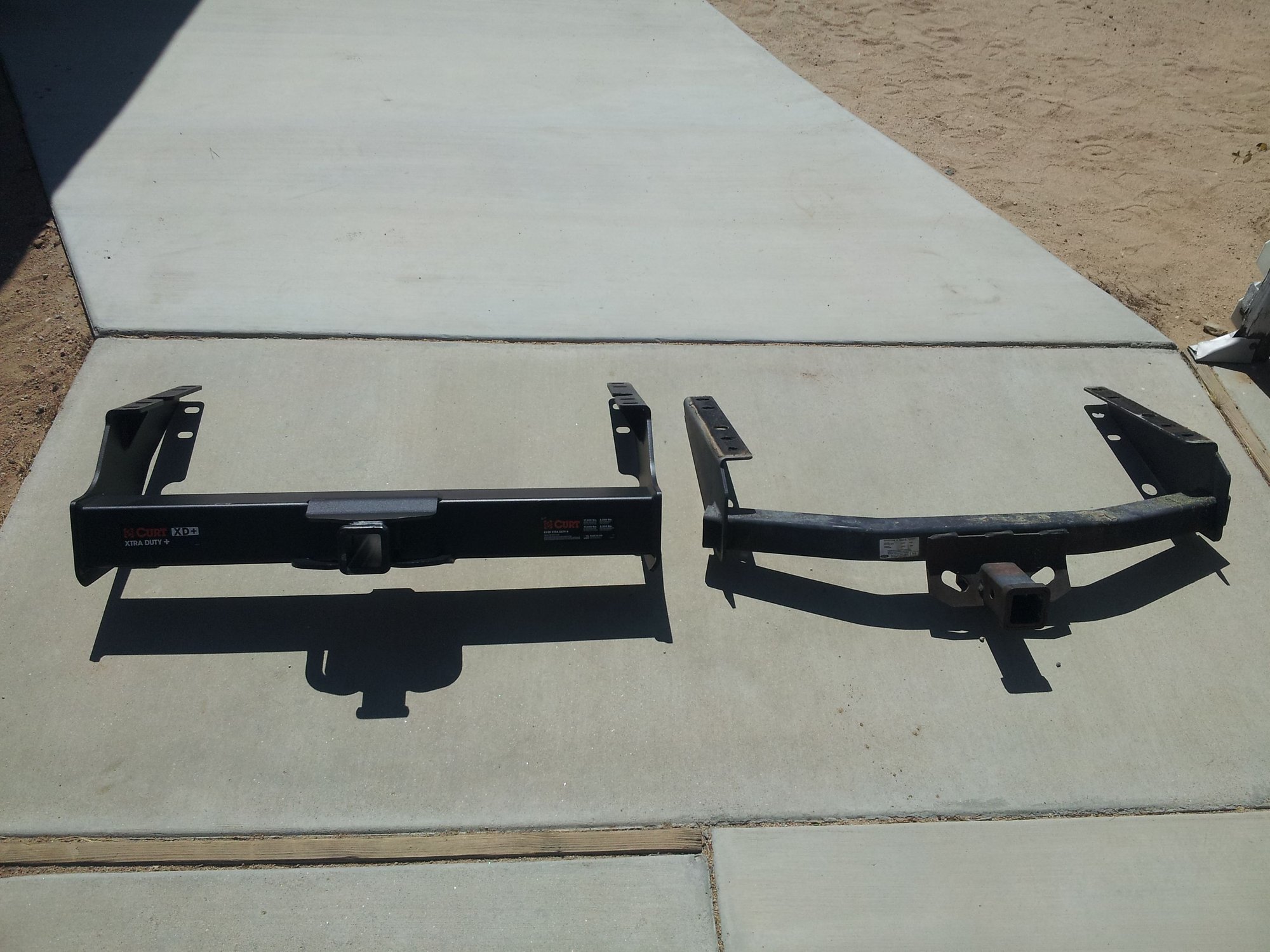

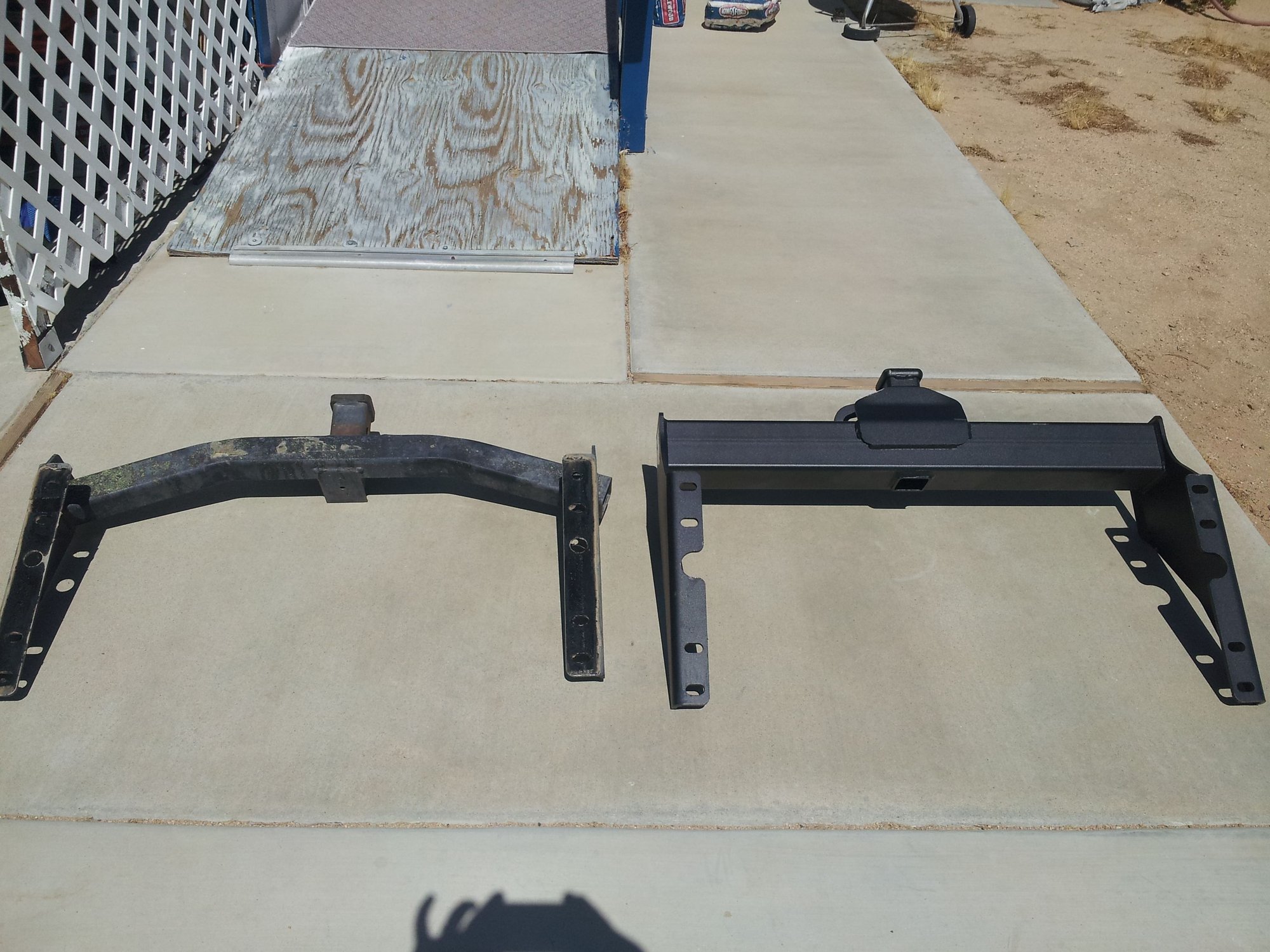

I just today replaced the factory hitch on my '99 F350. The factory hitch was the 5000/500 weight carrying, 10,000/1,000 weight distributing hitch. I pull a 3-horse bumper hitch, with a GTWR of just under 10,000 lb.
I looked around and finally bought the Curt Mfg. 15410, which I believe fits all Super Dutys with less than 20" spare tire. Cross-tube seems to be 4" square, and the side rails are 5/16" thick I believe. Bolted on to factory frame holes. I liked it because of the high weight carrying rating (17,000/2,550). Also liked the price on Amazon, as well as the fact that it's a 2" receiver hole, so ball mounts should be easier/cheaper. As was mentioned before, I'm now limited by the truck, rather than the hitch. Here's a couple pictures comparing the factory hitch.

I put the same Curt hitch on my last truck, nice product for sure. My 18" spare rubbed a little but nothing to worry about.
