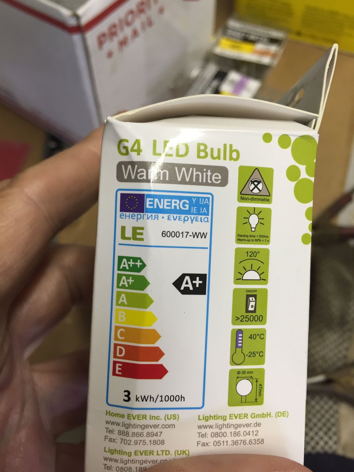

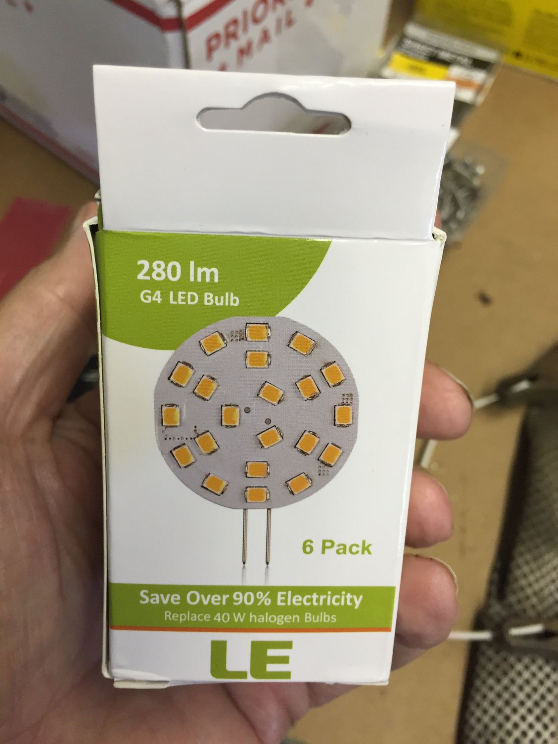

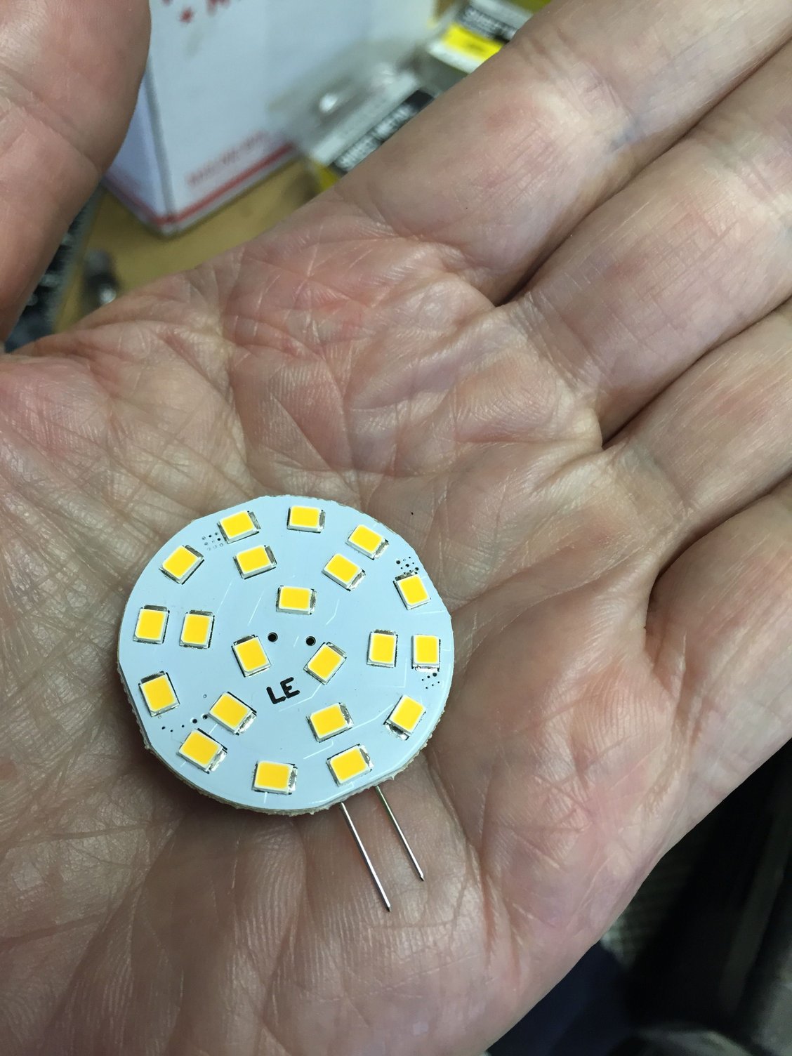

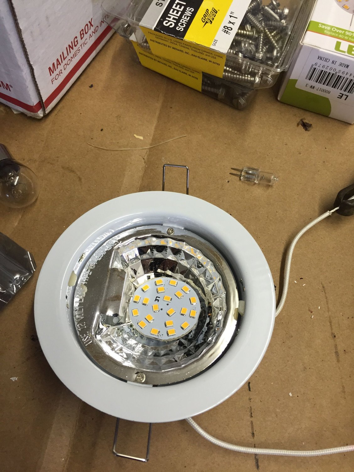

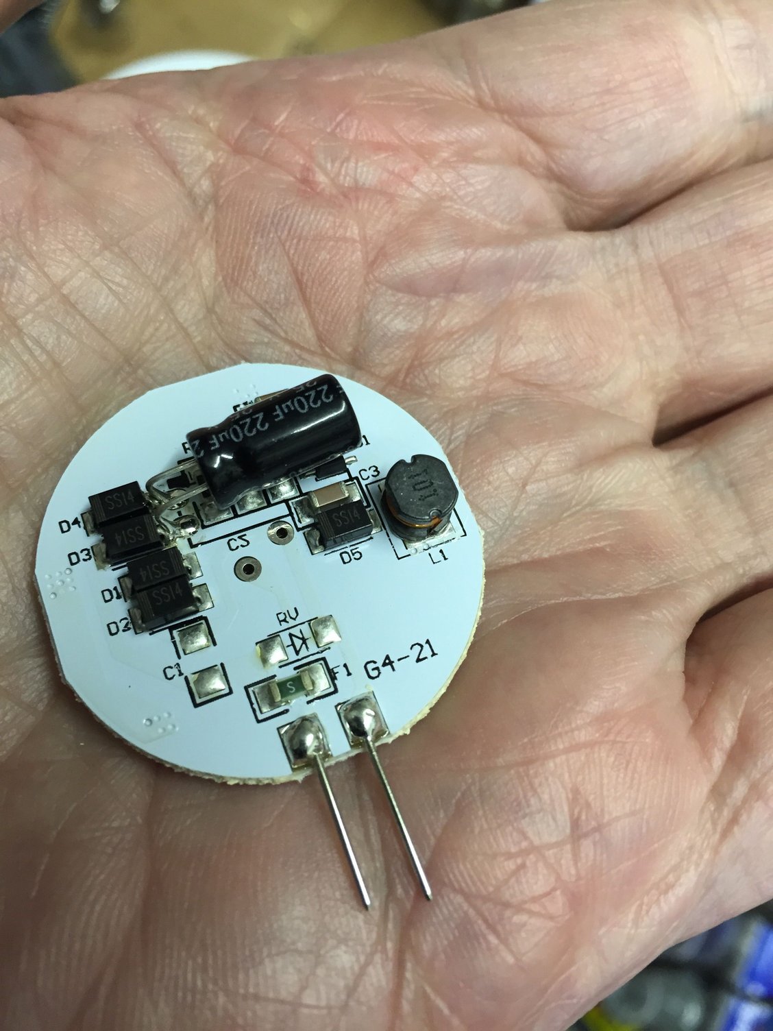

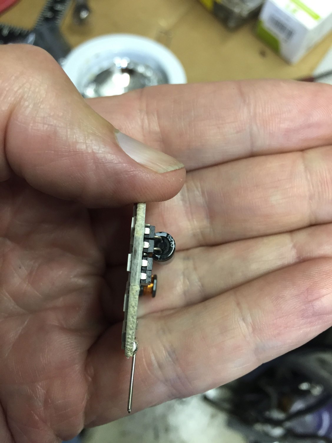

I figured I would kick this off with a link and recommendation on LED replacements for 12v Halogen lights..
My purpose was not so much from the perspective of energy consumption - but more from the perspective of reduced heat, better light and reduced replacement frequency.
Here's a link to the product that I used.
They are 40w equivalent.. You can read my review along with pictures as well..
LE® 3W G4 LED Bulbs, 40W Halogen Bulbs Equivalent, 12V AC, 280lm, 120° Beam Angle, Warm White, 3000K, G4 Bulb, Bi-Pin Light Bulbs, LED Light Bulbs, Pack of 6 Units - - Amazon.com LE® 3W G4 LED Bulbs, 40W Halogen Bulbs Equivalent, 12V AC, 280lm, 120° Beam Angle, Warm White, 3000K, G4 Bulb, Bi-Pin Light Bulbs, LED Light Bulbs, Pack of 6 Units - - Amazon.com
I have more LEDs on the way for the normal ceiling lights (1056/1041 replacements) and will post that later in this thread.
Along with purchasing a new awning LED string -
I also replaced all my external lights with new LED and will gather that information up and post it here as well...

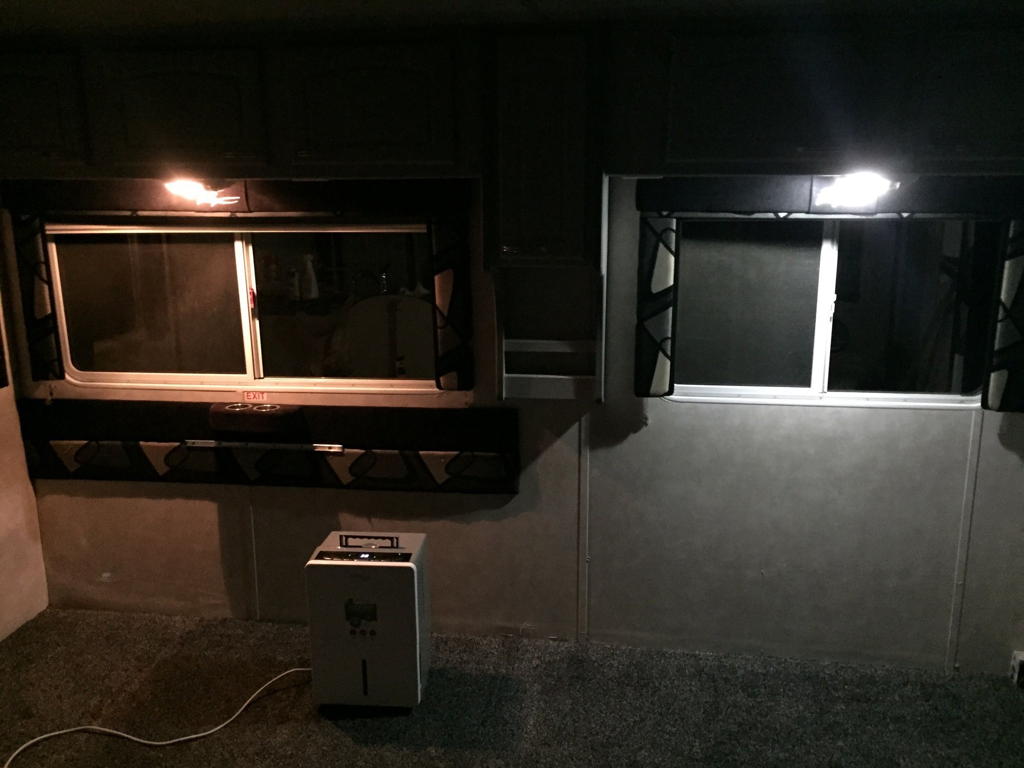

I just installed one of these tonight and took this picture..
The light on the right is a single LED unit. The one on the left is the standard incandescent..
It looks pretty bright to me. These were the only lights on in the camper.
Well other than the dehumidifier thatwas running in there..

Not too bad, but color balance in pics is hard to tell sometimes too. I bought an LED reading lamp some years ago. It had this spooky arc welder vibe to the color.

I agree Ted.. And if I hadn't taken the picture myself, I couldn't corroborate the image to the real thing.. There is slightly more flare to the LED light in the picture, but the color is remarkably spot-on..

What you see in Big-foot's picture is how mine look.
Wife says they make it like daylight. These are "white" lights. Some of the LEDs are a soft white, or "warm" white, which are more like the bulbs that came with the trailer.
