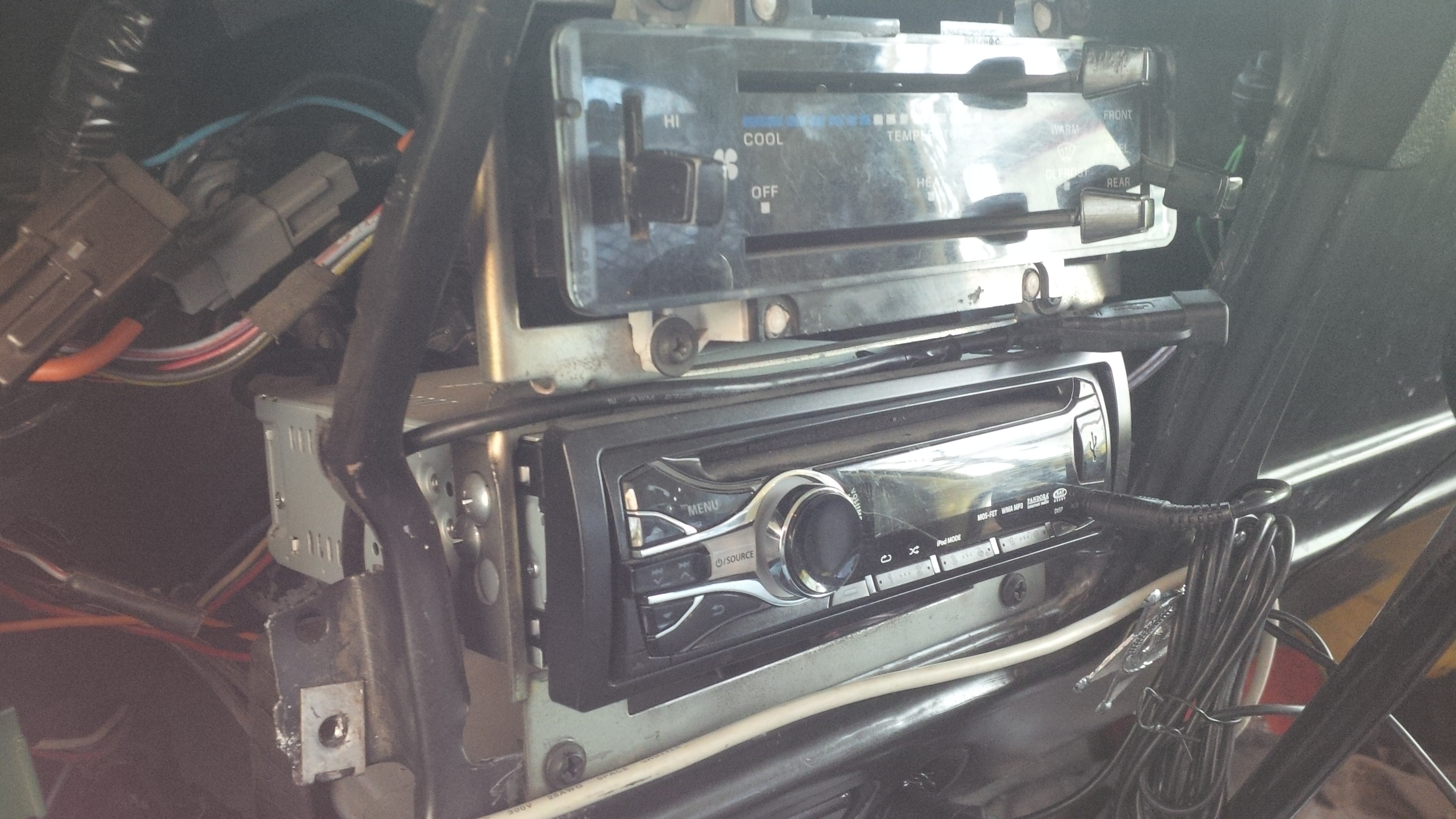

Your parts selection for a heater panel can include the newer trucks. I snagged this heater panel out of a newer truck, and slightly modified it (the four plastic mounting posts needed to be shaved down) and re-wired the fuel tank selector switch to follow the Front/Rear labeling.
