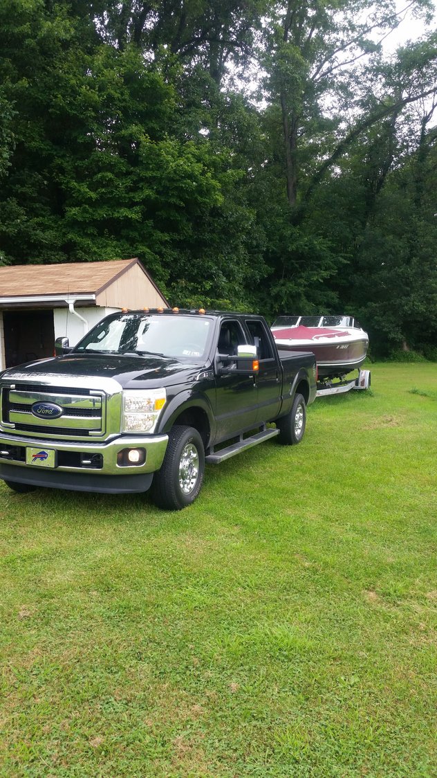

I have a 2012 F-250 lariat crew cab with a 6.2L, just bought it about a month ago and wanted to give it a little 2 or 3 inch lift with bigger tires. I know with lifting the truck comes with stress to the front end. Wanted some suggestions
