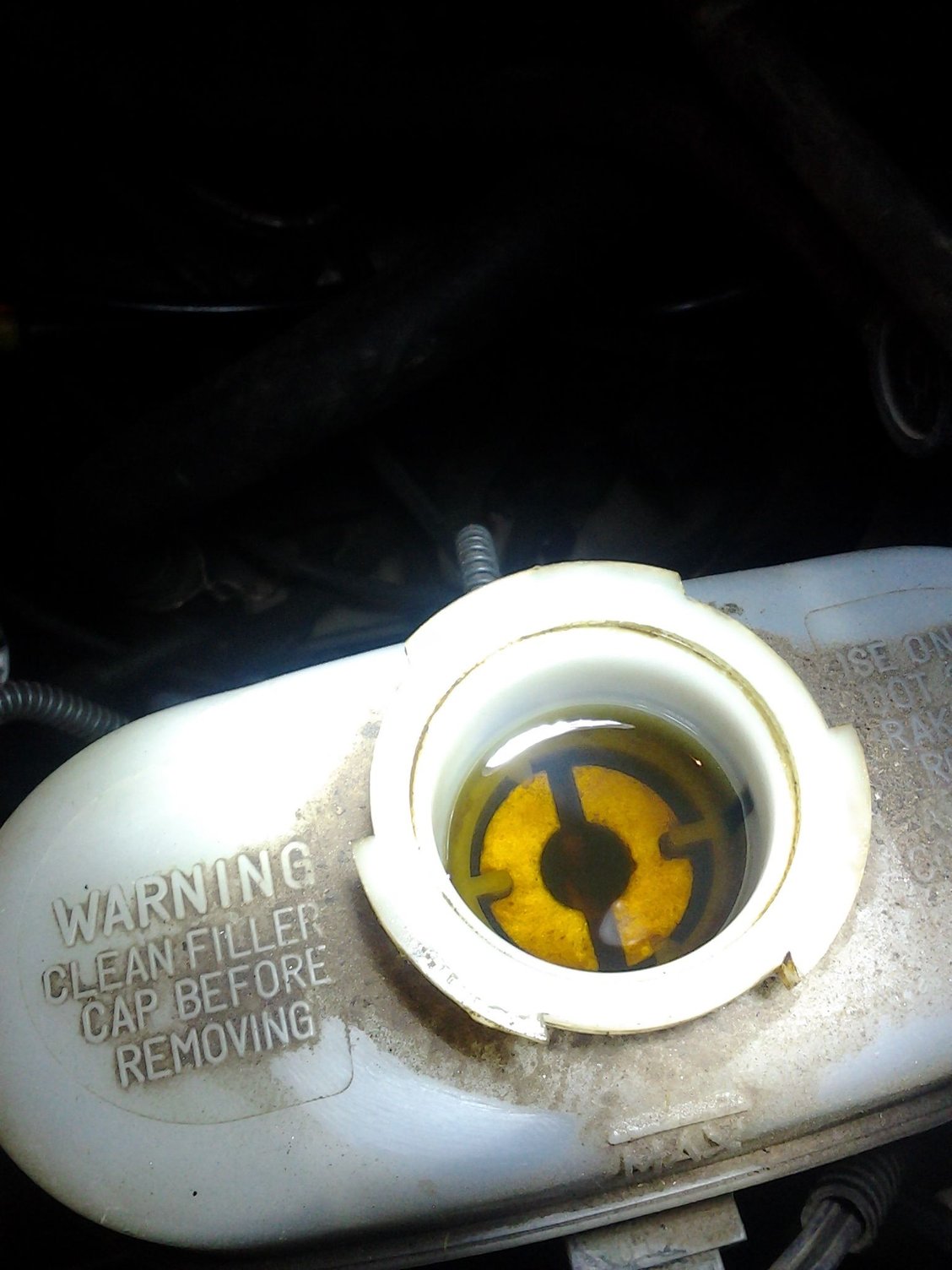

Ive never had to refill my fluid due to any leaks. Level is where its always been. HOWEVER....i just checked and the fluid looks like a clean motor oil color. Thought it was suppose to be white.....i will take a pic meow

Also just so yall know i did the whole adjust rear brakes thing where you reverse and slam on the brakes......the brake fluid wasnt this color a few weeks ago. Couldve just did it now that i tried that reverse thing. They worked a little better too. Should i flush my brake fluid completely........
Actually, brake fluid SHOULD be changed ANNUALLY- it is hygroscopic: It absorbs moisture form the air- and this contaminates it... This is what SHOULD be done: I don't think I've ever heard of anyone actually doing that on a regular schedule!

That's probably a feature though, not a bug. If brake fluid didn't absorb water, then brake line would eventually freeze solid in cold weather.
You're absolutely correct however it is supposed to be flushed periodically and replaced. I think every 2 to 3 years is one schedule. Hardly anyone does this.
Nooo.. That is NOT a "Feature": that water will STILL freeze. It is an UNDESIRED side effect of the DOT3/4 mineral based fluids... And they WON'T freeze...(At least not under normal winter conditions) Water in your brake fluid is a BAD thing- it rusts the system from within, and the water CAN freeze & block passages in the system, as well as fracture pipes if enough accumulates in one place and freezes(water expands when frozen)
Synthetic brake fluid(Silicon) does NOT absorb water- BUT- if moisture DOES get into the system, it concentrates in low and slow sections, rather than getting carried within the fluid as an inclusion...
Moisture can get in if you have a low reservoir vented to the outside(as they all are). Condensation will build inside the reservoir above the fluid, and run to the bottom of it...
Scott
