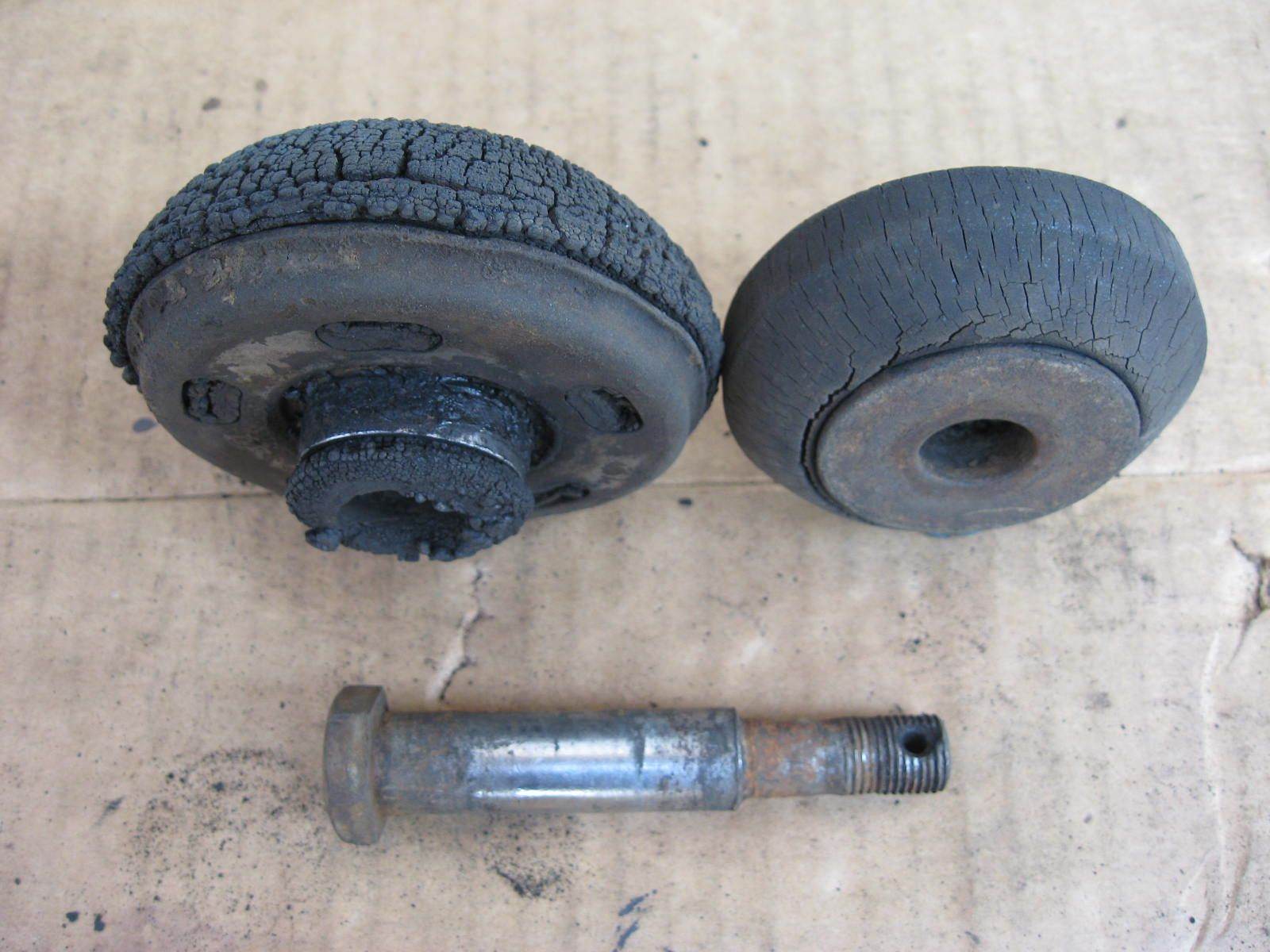

Ross, the numbers for the NAPA mounts are BK 6021177 and BK 6021178. Those are for '51 and earlier. They don't look much like the ones on my truck, but possibly could be used. If your '52 mounts from Carpenter are still holding up, I'll probably take a chance on them. I had one of my mounts off last week and took some pictures. Can they be posted here, or do you have to store them somewhere else and link to them? - Bob

.... I had one of my mounts off last week and took some pictures. Can they be posted here, or do you have to store them somewhere else and link to them? - Bob
You can insert them in the Quick Reply dialog box by clicking on the "mountain" icon.

Thanks, Ross - hope the pictures work. One shows the front motor mount off of the truck and the other shows it in place. To keep on topic, the new exhaust pipe that I built last week is shown. I run a single exhaust with a glass-pack and and a "turn down" tail pipe just short of the rear axle. It rumbles a bit, but hearing the engine speed helps to shift the 4-speed. - Bob
