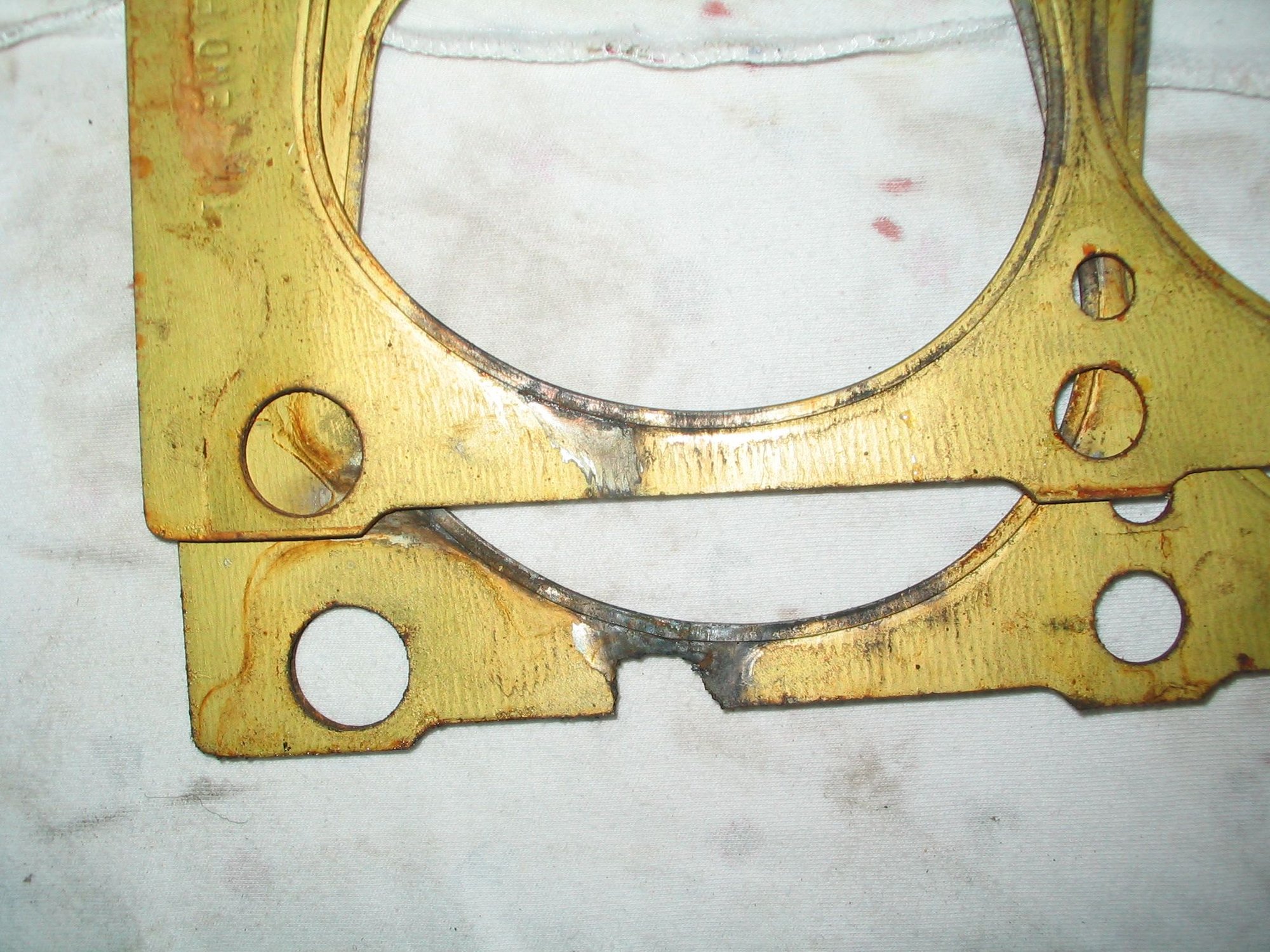

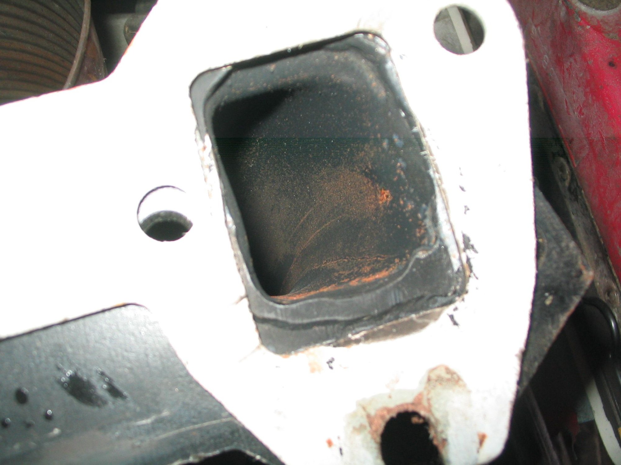

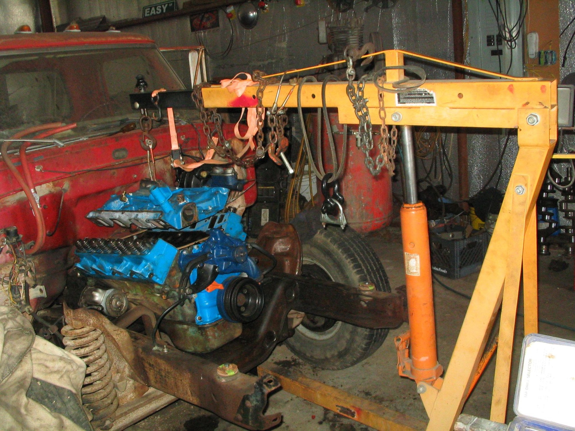

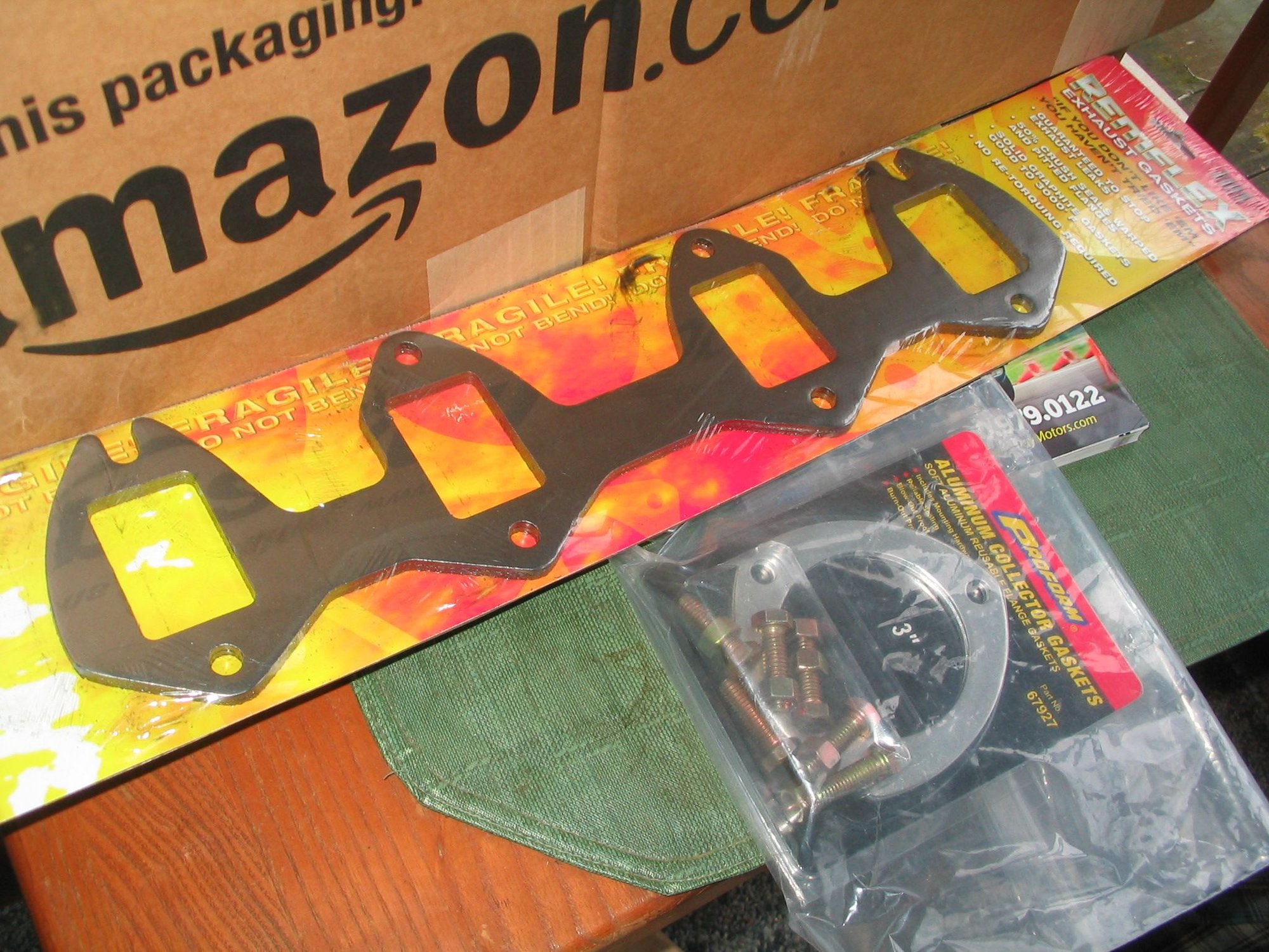

well i guess i should update this thread too... after i got the engine running it ran good for about 30 mins..... then i was adjusting the carb and kept feeling coolant spray.. well i found the leak it it was behind the alt. . like the dummy i am when i put the heads back on i used a gasket set that i have had laying around since the 80's.. let me tell you now dont ever use old head gaskets.. well after getting the heads back off i went ahead and cleaned up a set of heads that i had on a old hot rod many years ago.. they matched the ports on the 64 t-bird intake alot better.. i have most of it back together now.. i decided since the engine only ran for 30 minutes and the gaskets that came with the header started leaking already i would change the gaskets to the remflex header gaskets. i hope they are worth the money.. i also pulled the steering box off after i started the engine and was bleeding the steering system it started leaking. so i ordered some new seals for it.. here are some pics of the progress again..
this is what happens when you use very old dry rotted head gaskets..
the gaskets that came with the jr. headers didnt seal very well at all as you can see
i will try these to see if they seal better
they sure do look better.. i also got some aluminum flange gaskets so maybe they will do better than the cheap ones that came with the headers
i am getting old i guess..it is getting harder to manhandle these FE intakes
maybe the engine will run longer than 30 minutes this time around.. i am not sure if i will use the chrome valve covers or the original ones.. i may clean up and paint a set i have on a 63 galaxie 352 engine.. would be more of a match for the 64 model; intake.. the valve covers would be solid because the breather tube is on the back of the intake instead of the valve cover

time to update this one a little bit.. i have been busy on the 71 f100 'ole rip' project and the 84 f250 4x4 the past few weeks so not much progress on the 72 f350.. i did start the engine back up yesterday so it is getting back together a little at a time.. i had to weld up the wallowed out clutch linkage's and the z-bar holes, take a 1/2" out of the z-bar and modify the fork to get enough clearance for the headers.. i installed the new remflex header gaskets that i think will seal better.. now if i can get the sheet metal back on, and a few more details worked out i may be able to start using the f350 'flat-bump' to do some work that i have got way behind on..
fits the headers a lot better and are thicker so should seal good
the gaskets that came with the new headers.. did not seal very well

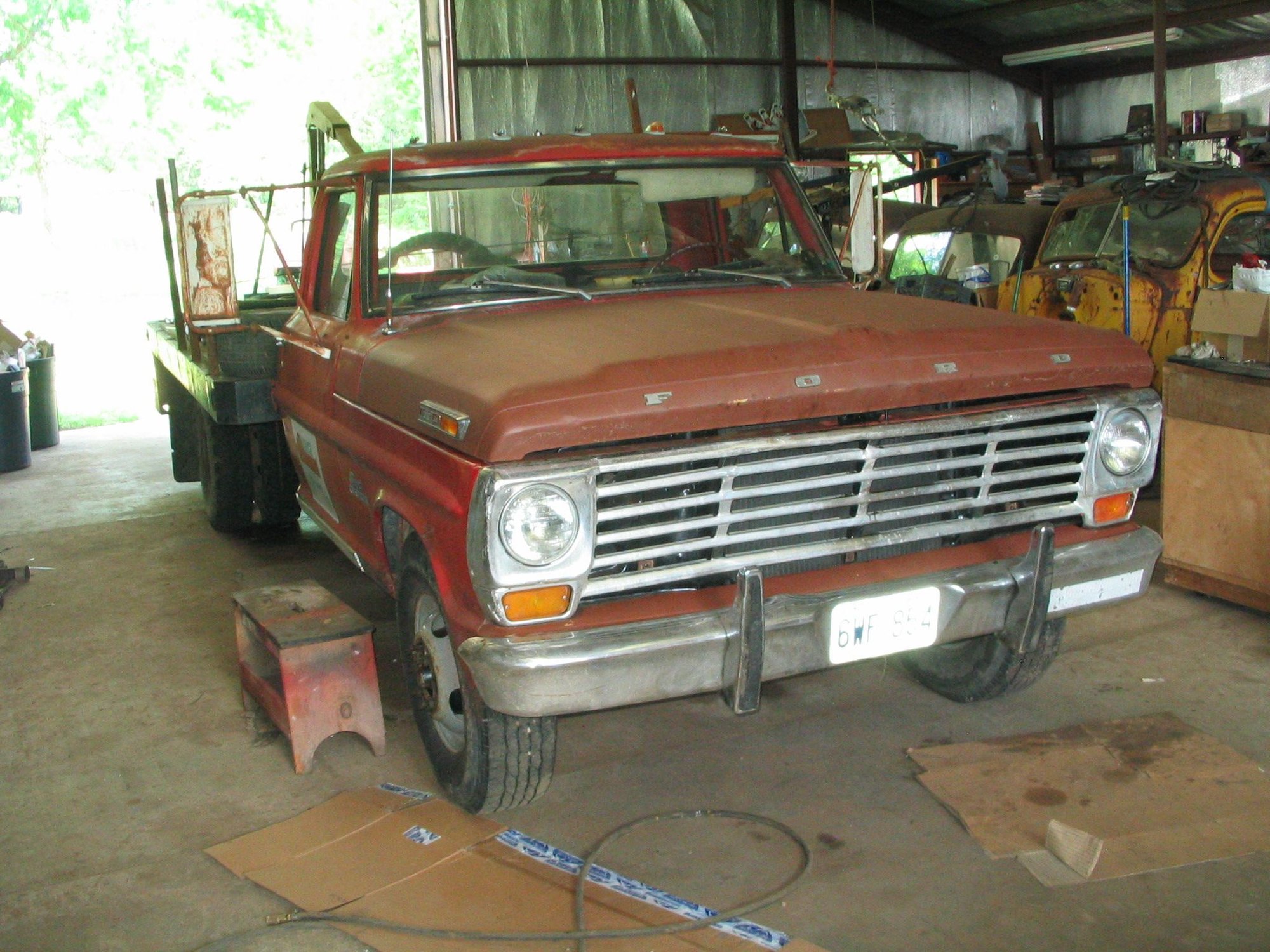

a update..i got a few more things done to the 72 F350 "flat-bump"... i am still doing body work, getting all the lights working or replaced, then build some kind of exhaust to quite it enough to get the truck legal and roadworthy until i can afford the new complete exhaust system .. i have been using it some around the yard and a few short trips.. it has plenty of power and is real handy to have around..
got the hood and valances primed till i get time to do a complete paint job
tried to hammer most of the dents out of the grille

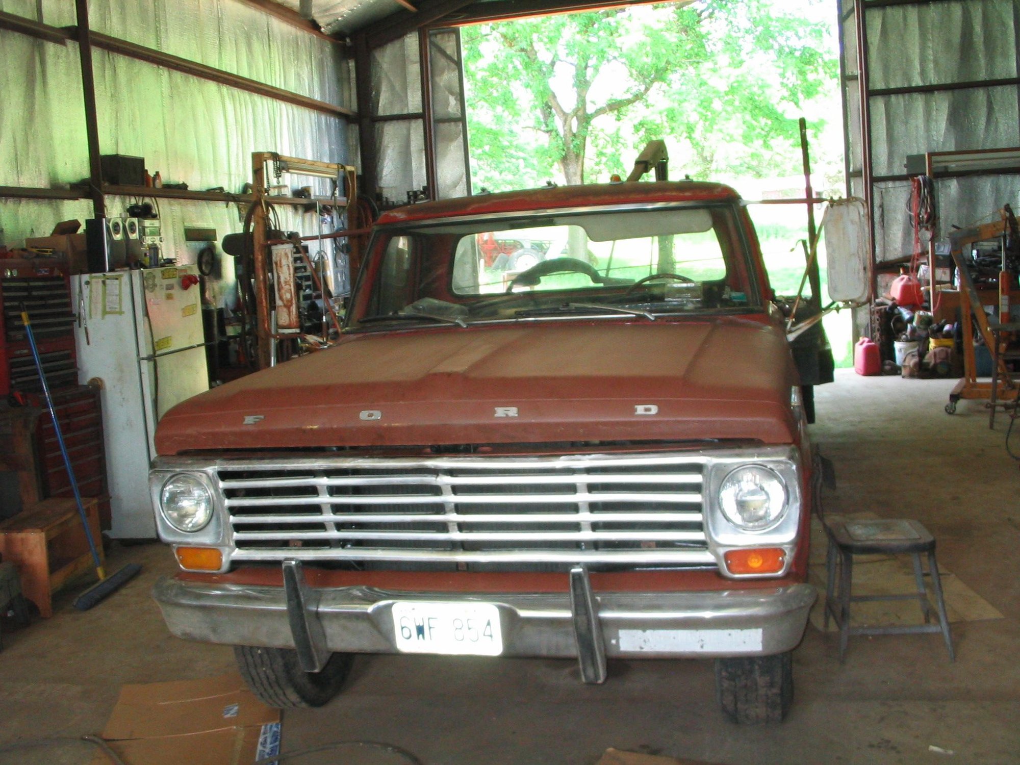

i have worked a little on the 'flat-bump' today.. got most of the lights working but will need several clearance lights on the bed... and will need some new cab light len's most of mine are cracked and broke.. may have to just buy a new universal set....
hammered on the old 72 grille shell till i got tired of it.. got a 67 grille off another one of my old trucks and lower valance..it looks better i think anyway.... i dont care if it looks original anyway.. just as long as it works.. ha ha ha ha ha
