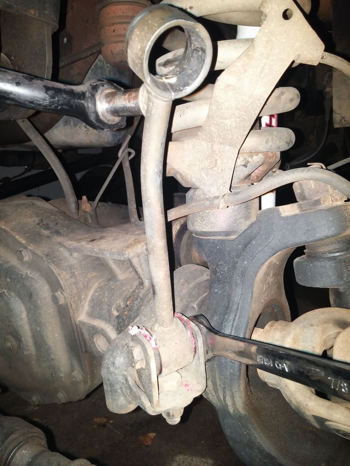

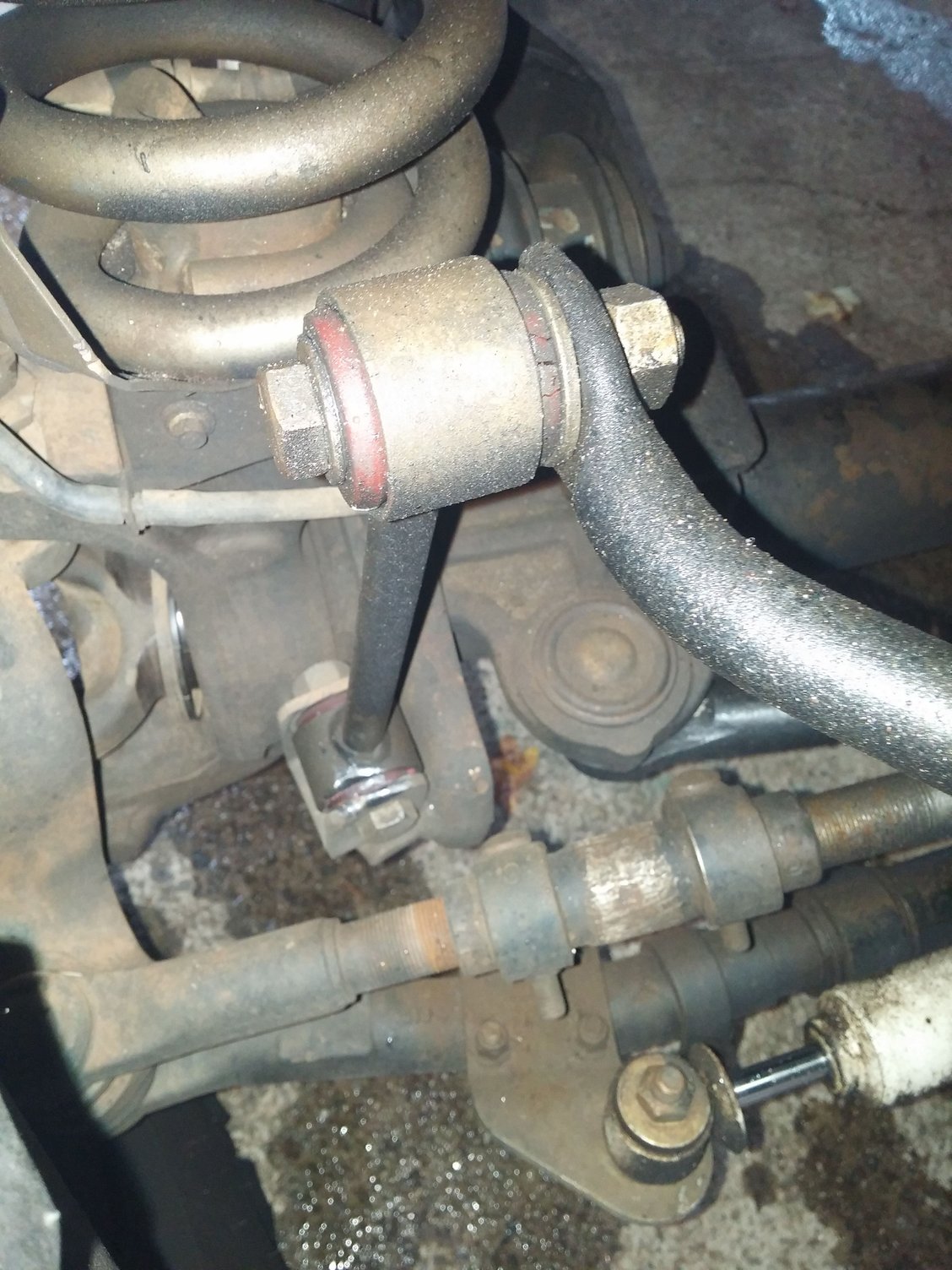

New to FTE. Great site and I've found a ton of valuable info and ideas along with some nice pictures. Need some help getting my 06 F250 back on the road. I cannot find this part for the life of me. I do have a 8" rough country kit but this part is not included and they tell me it is stock. Ford tells me is it the stabilizer bar link (6C3Z5K483AA) but their picture doesn't match. I need one asap so if someone know what it is and where I can have one overnighted it would be much appreciated.
Passenger side ( good one for the moment)
Drivers side (bad)

Summit racing has them, just put in 2006 f250 front sway bar end link in search bar, they have several brands.

The catalogues that we look up parts on usually won't match. They are just for us to get base part #'s from. Your local dealer should be able to get them overnight for you unless you live way out.
