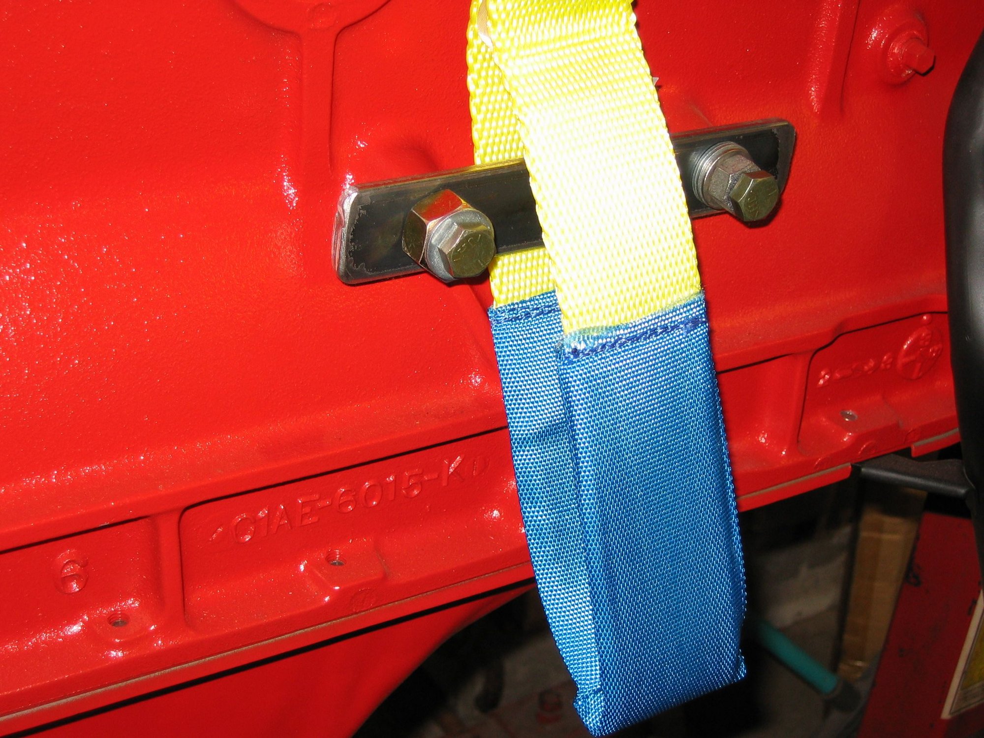

Old Aug 22, 2015 | 10:40 AM
P38fighter's Avatar
P38fighter
Joined: Jan 2012
Posts: 396
Engine pull and replace
I used a sling which I ran through two 1/8 straps bolted to the side of the block. The balance was pretty good but I added a nose chain just to be sure. With the sheet metal removed it was a piece of cake to drop it in.
