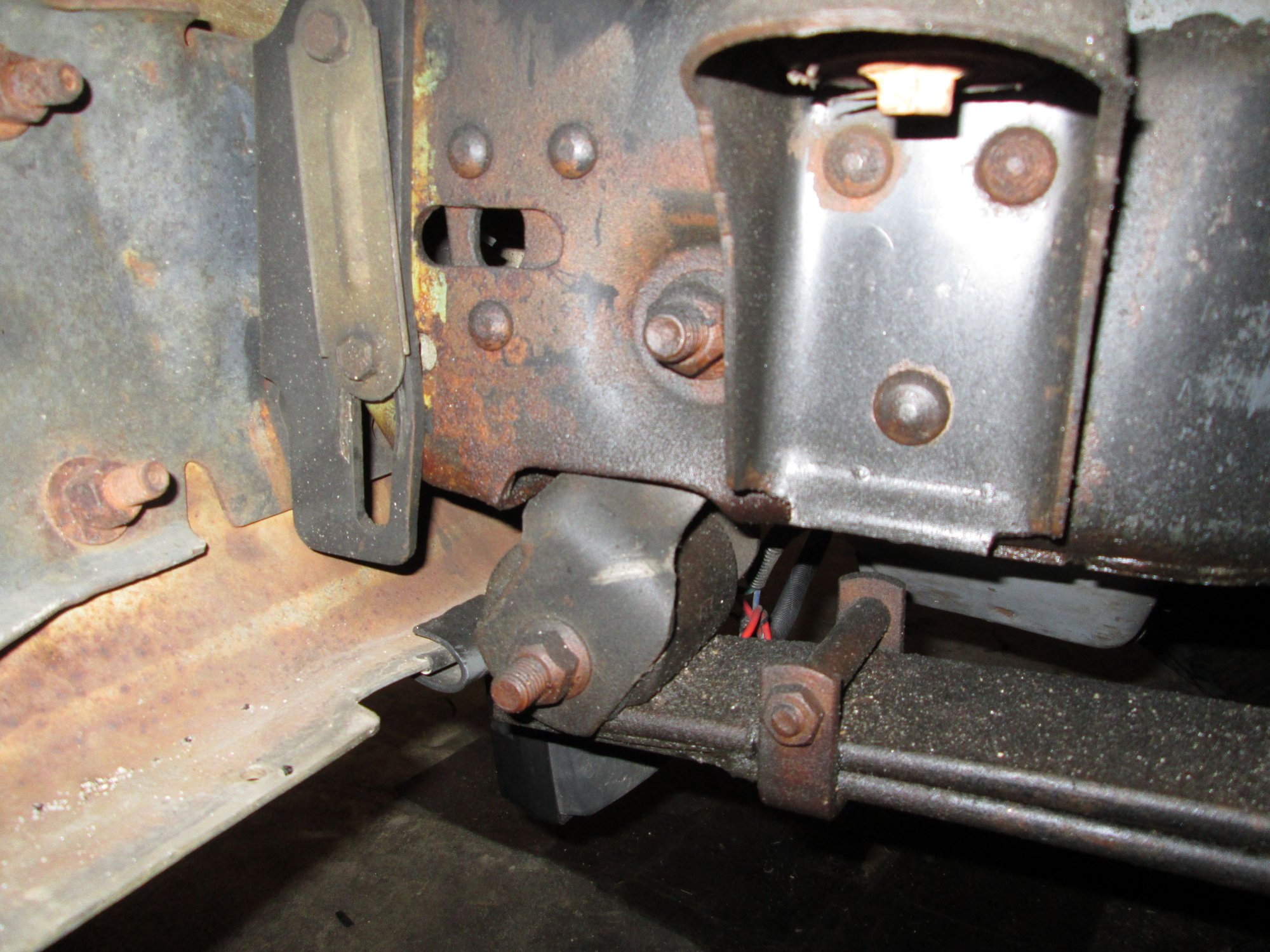

Pics of the suspension
pass side front axle rear hanger (old bushings seemed tight)
front shackle pass side (new bushings, new hardware) One that hits the frame.
front driver side shackle, never been touched.
driverside front hanger, never been touched.

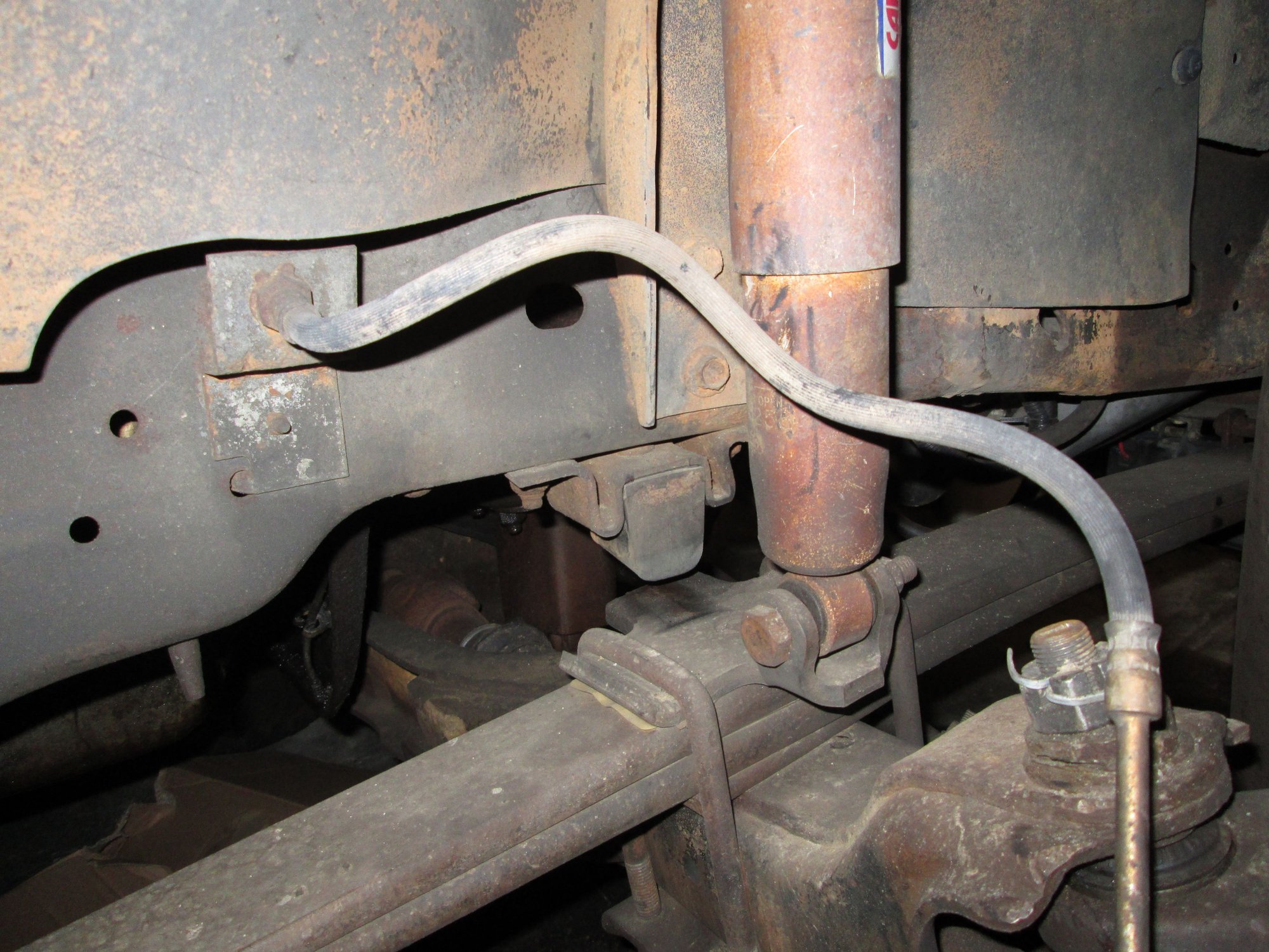

bumpstop clearance driverside
pass side bumpstop clearance (idk what the deal is with the brake hose, its not twisted)

It looks like your bushings are bad....I'd start there.
it is quite possible your springs are simply worn out and the sag is causing your issue.

I thought that meant you did them all. Yes, I agree with 89F2urd. Replace all of the spring and shackle bushings and you will be fixed. Most likely the bushing in the rear of the spring is worn letting it shift forward pushing the shackle into the frame.

i would have to agree with worn springs and bad bushings don't forget to change the bushings in the shackles INSIDE THE FRAME.
everyone forgets there are bushings up inside the frame, they replace the ones down bottom in the springs but never do the upper bushings.

Ok, I'll finish what I started , I already did the shackle bushing (in the frame) and the Eye bushing, used tons of polyurethane lube.

replaced that rear bushing on wednesday, rides and steers so much nicer. The outer wrap on the spring was hitting the spring hanger, that bushing was shot. Thought about this. If the spring was shot, and was sagging too much, it shouldn't be hitting the hanger, it should have pulled it back some from the end of the frame, being the straight eye to eye distance being shorter. A flatter spring (spring eye to spring eye distance being greater)would push the shackle closer to the frame.
