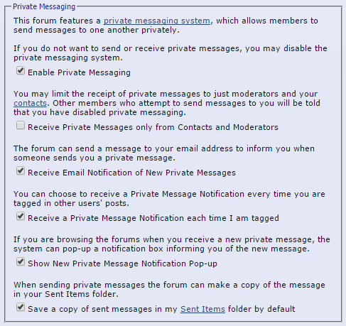

I may have found your forum PM gremlin. Clicking all the boxes on the PM settings is one click too many. Here are my settings:

Thanks that's great. Except I don't have access to change anything. I havn't changed any settings, and don't know how. My profile page has no settings like that. Thanks for the info though.

Ya, so looked around, can't find any access to any settings. I can't PM period. I don't even have access to that settings screen. I guess you have to be a paying member to PM. That's ok, I can post for everyone to see. I'm not shy. lol

Upper left corner of any page on the forum when logged in, "User CP", "Edit Options".

Yes found that in my search. Unfortunately, under private messages it does not have any options. I have two choices, open my messages, edit folders. That's it. I have no settings or private message options. Tried all the other options and private messages are not in there either. Under edit options at the top, that window you showed does not exist. The other windows are there, but no private message options. It must be because I'm new. The gods will let me pm some day. I don't care, I just want to fix my truck
