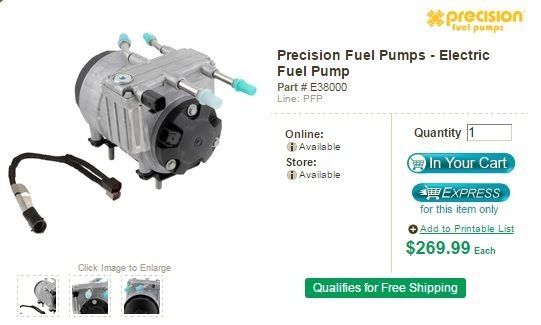

Oreilly auto has it for $270. and ficmrepair.com has the OEM motorcraft one for $337.
