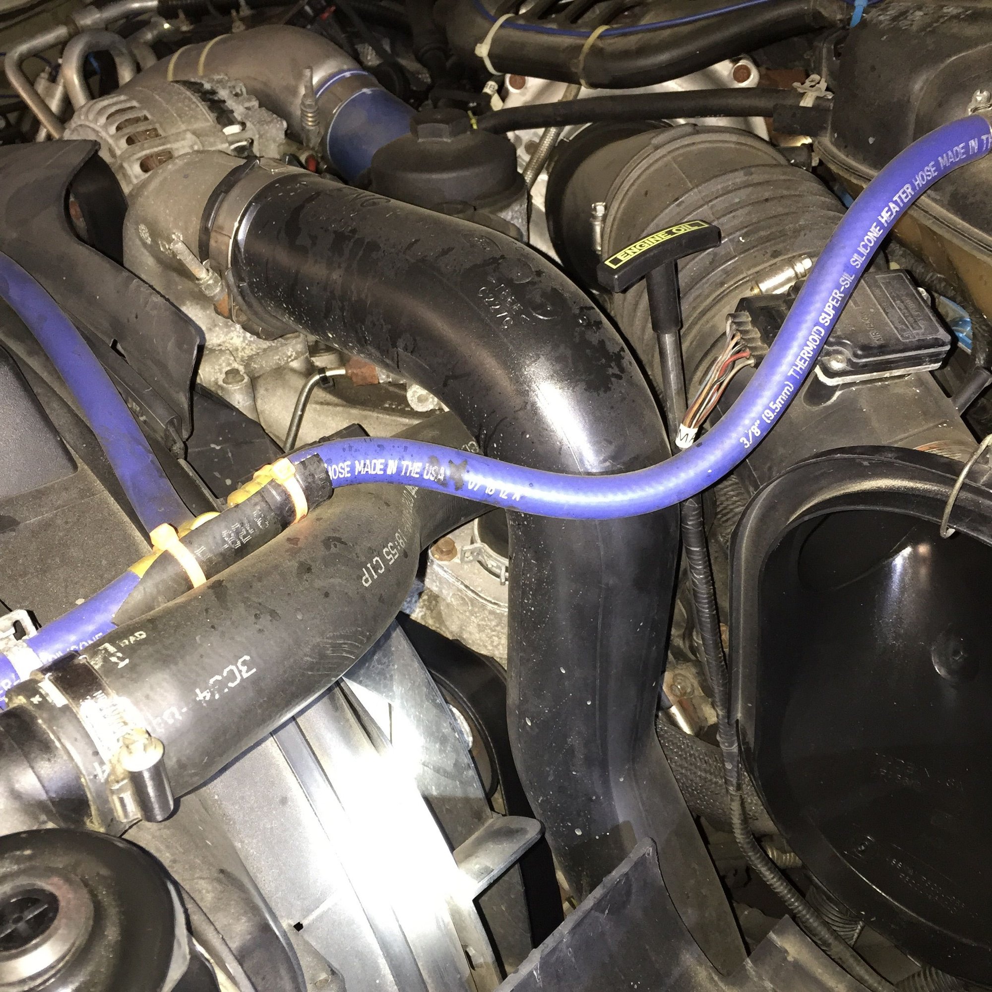

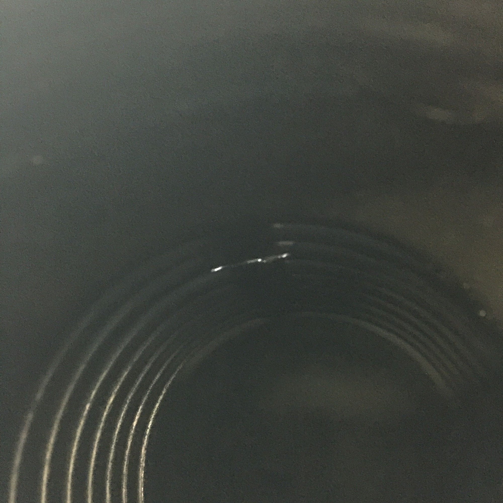

The next morning, opened the hood and started to inspect. Hmm, a sligh wetness on the edge of the airfilter, a little oil mist right above on the hood. A little oil on the side of the radiator. I took the flashlight and inspected the cold side plastic intercooler tube - yep, also a little wet but just around the corrugated area as it connects to the intercooler. I moved the tube around a little and could see the crack that had developed - the tube is finito - done - a leaking pease of crap.

Below are pics of the new tube just because and also a video that I hope will spawn some thoughts.

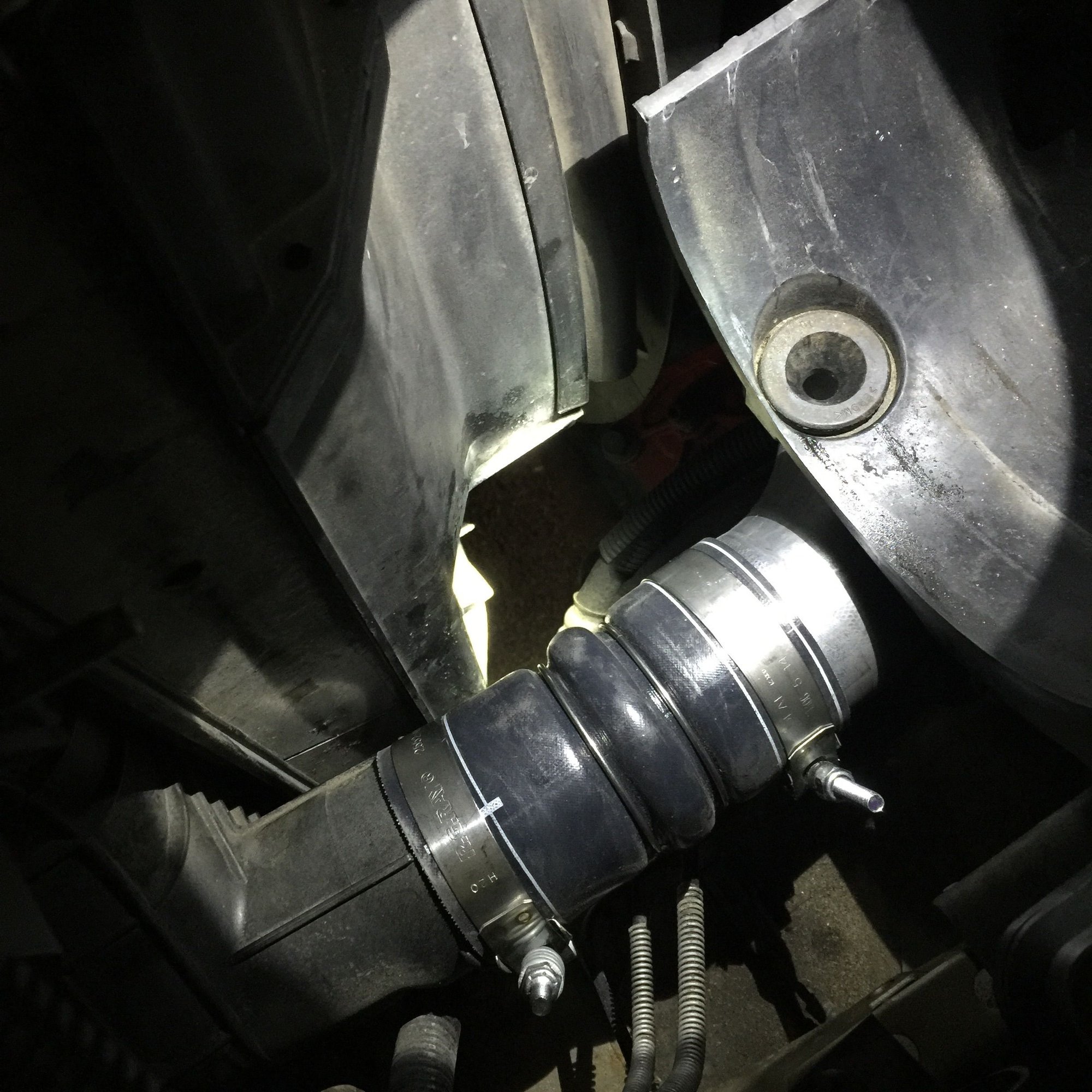

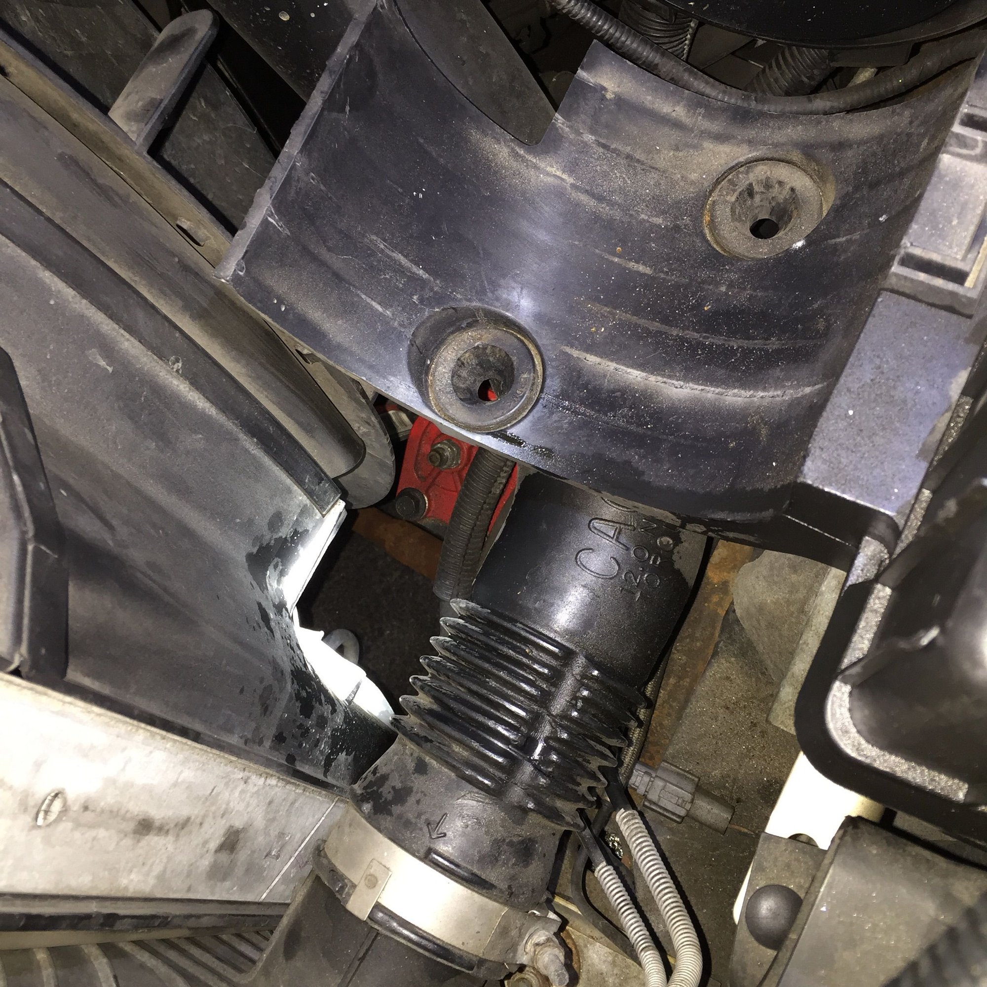

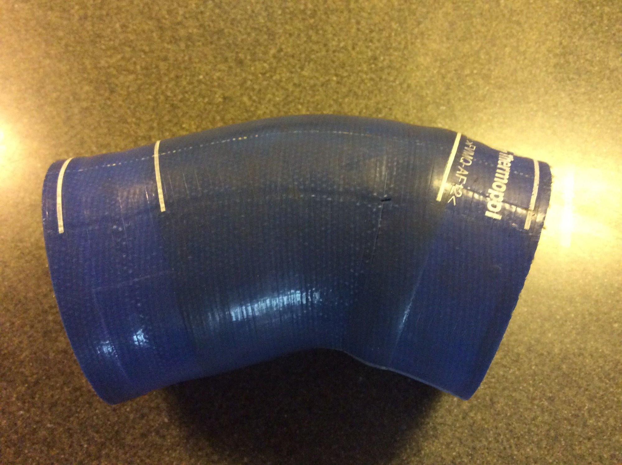

TD - you were onto something. I believe my less than a year old hot side boot is shot. I'll get new ones on Monday at the dealer and will find out for sure. You may very well have saved me an unnecessary spend of $1200. Who would think that an OEM part would go bad so fast.

Looks like the culprit!
Slap a new boot on and you should be good to go.
Glad I was able to save you from an unnecessary $1200.

Old Aug 16, 2015 | 08:59 PM

That looks like a poke damepaged it? But yeah, definitely the culprit.
I know - looks like someone took a small flat screwdriver and punched each side. Sure wasn't me. However, there are also a ton of smaller pinholes throughout that same "seam" - I think this is a manufacturing flaw that shows.
It actually is, that's one of the reasons why they revised that part.

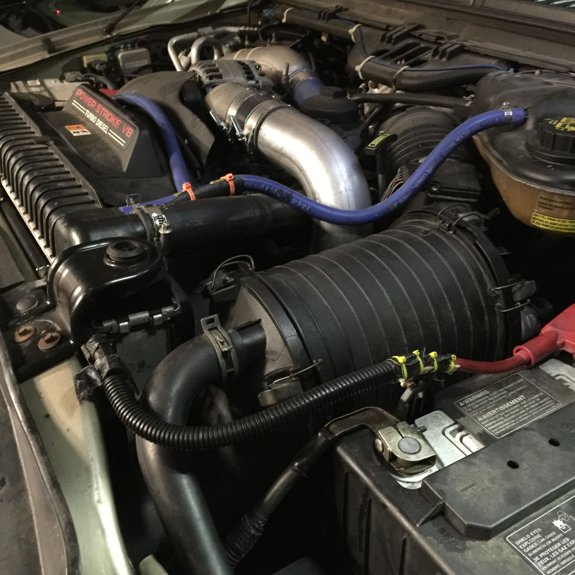

Here is a pic of the nice clean new boot.
I would check the right clamp on the new and shinny boot in the picture to make sure the bolt is not touching the coolant hose going to the degas bottle. Its hard to see it in the picture on my phone. Found out the hard way that hose is about $20.
