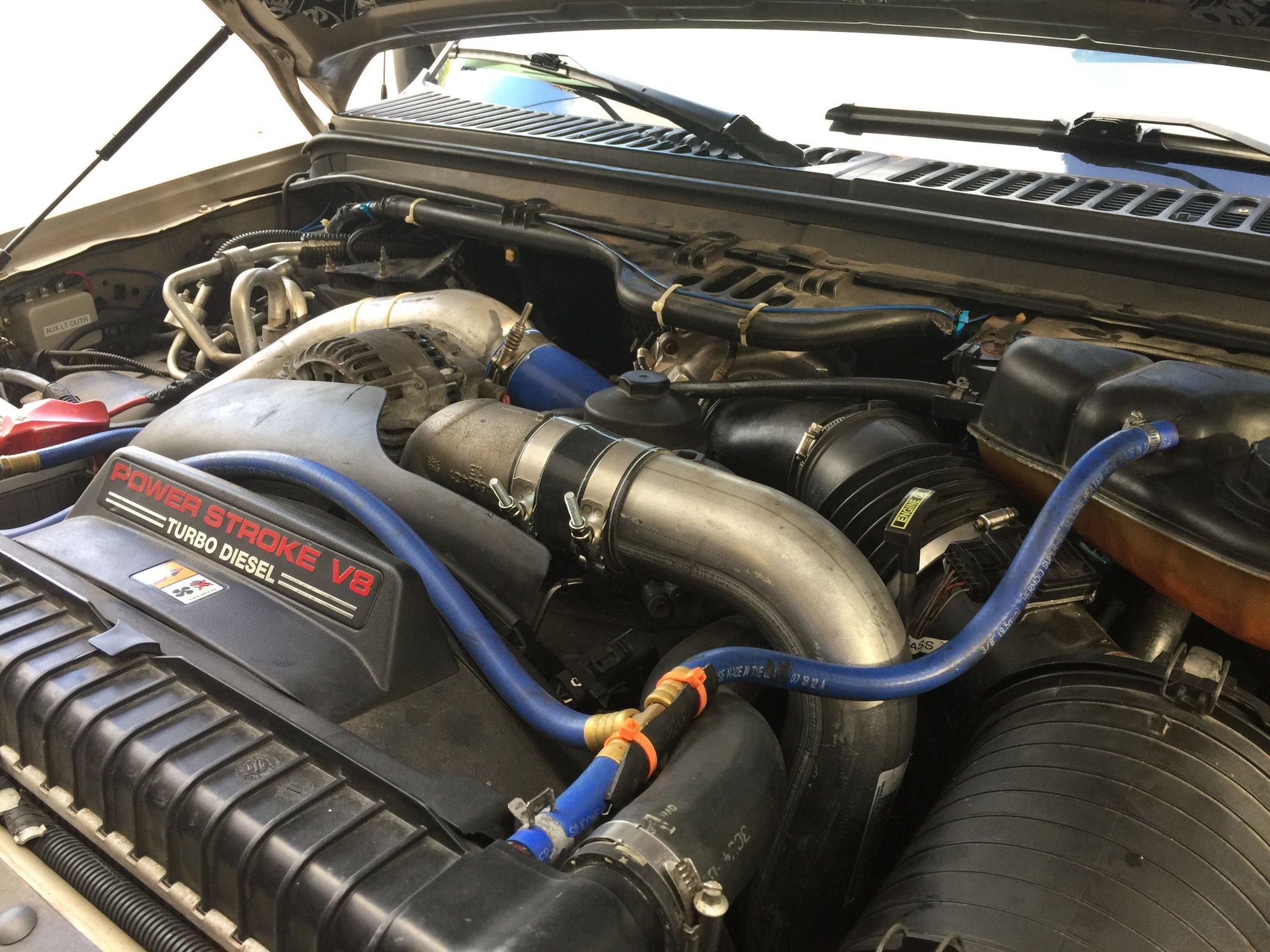

Originally Posted by Jerky's_06 F350
I would check the right clamp on the new and shinny boot in the picture to make sure the bolt is not touching the coolant hose going to the degas bottle. Its hard to see it in the picture on my phone. Found out the hard way that hose is about $20.
Excellent advice! Thanks.

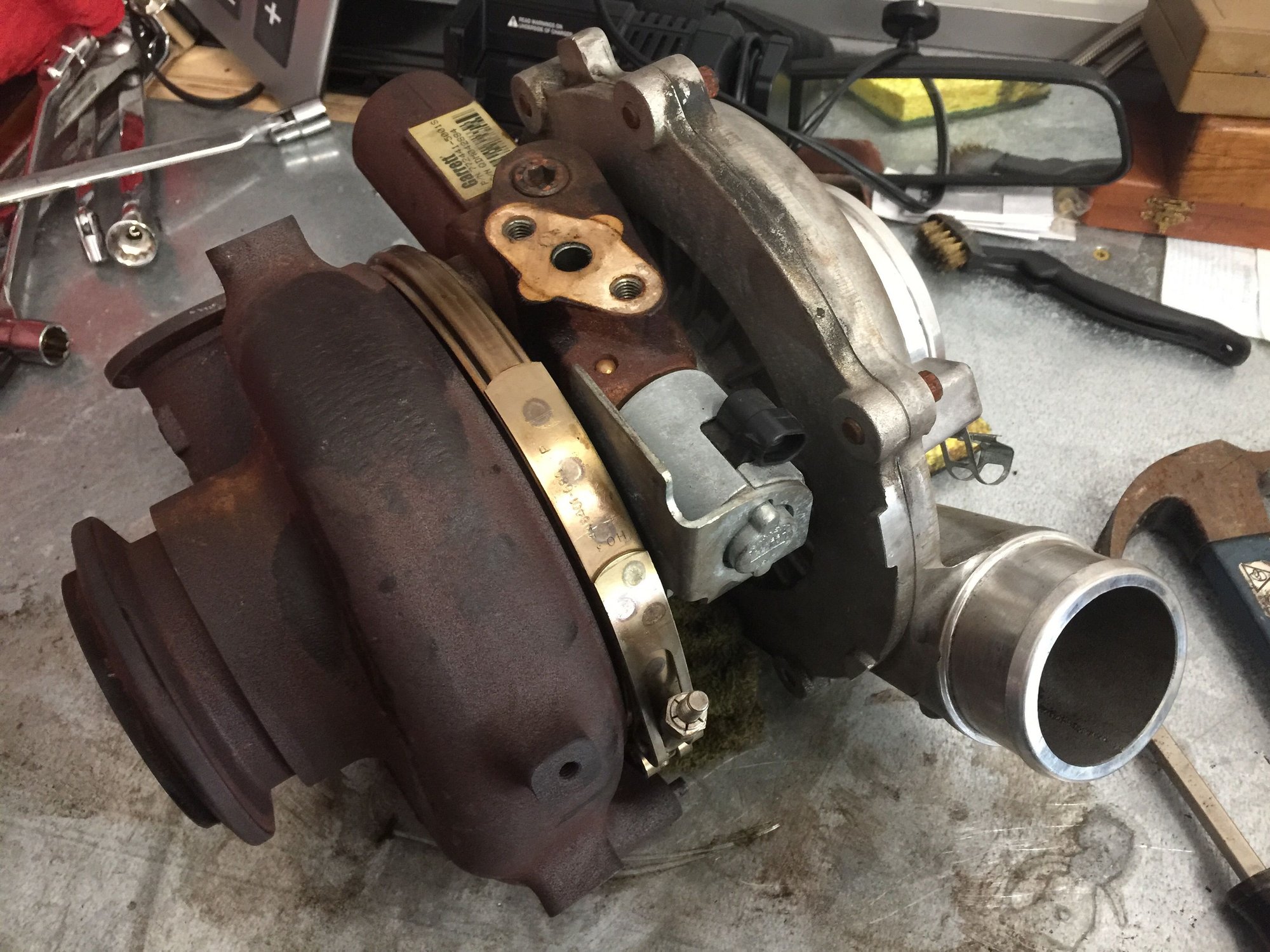

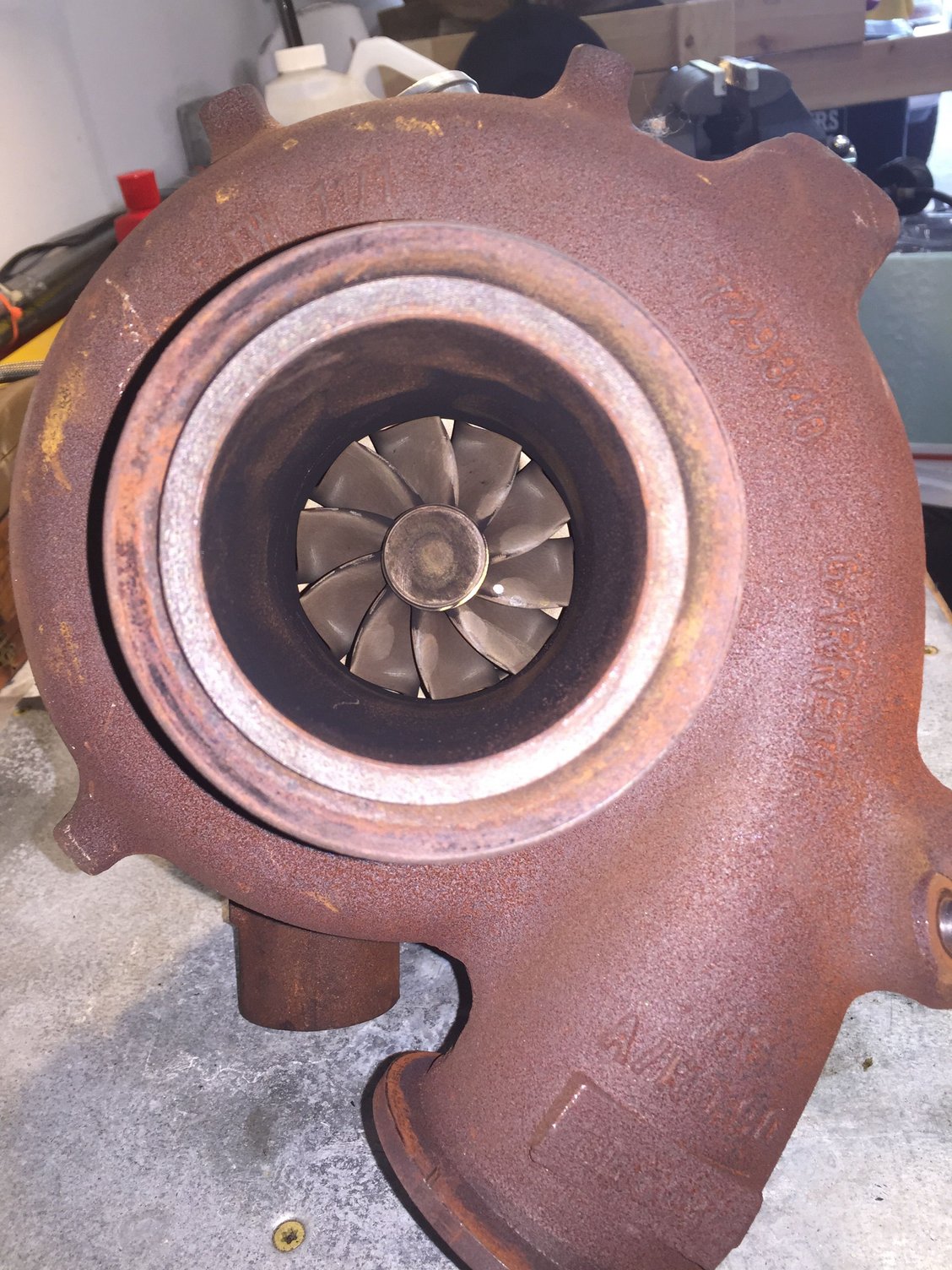

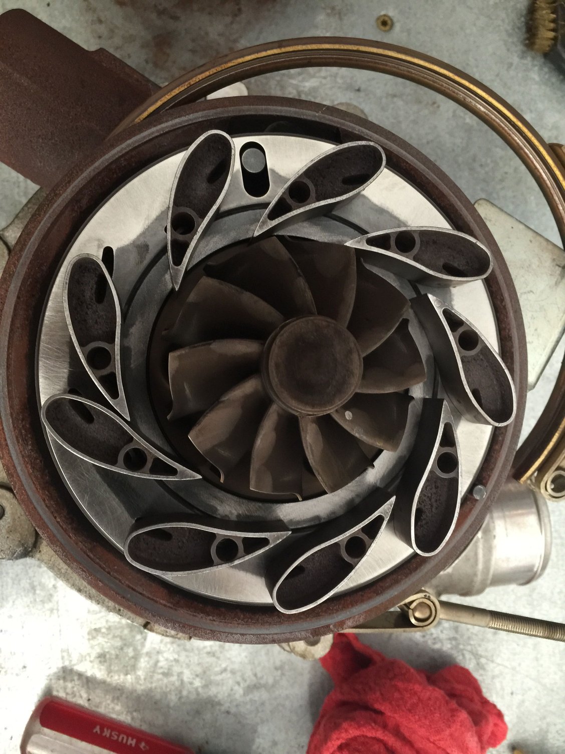

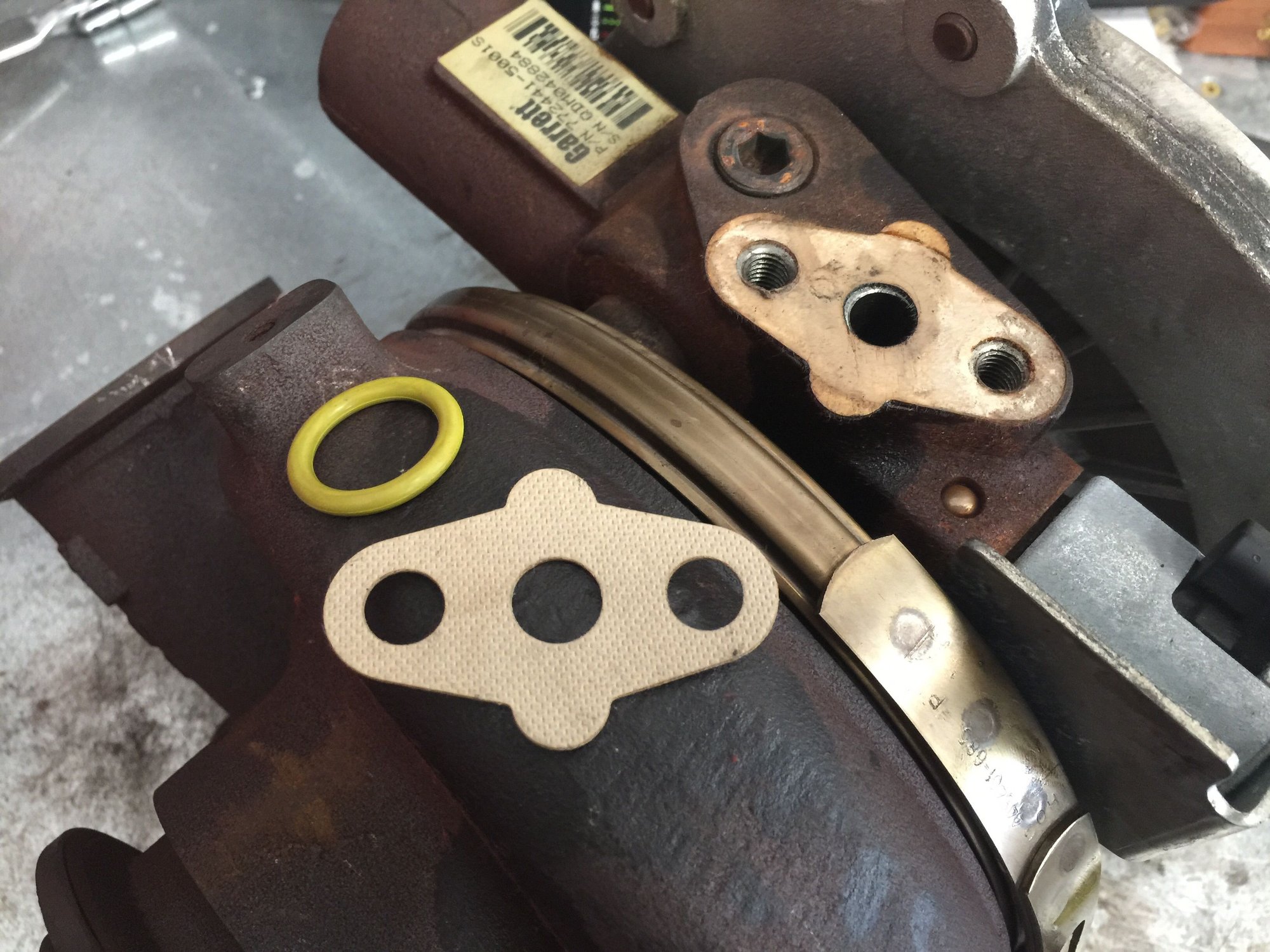

So I got the turbo out and separated. I will clean the vanes regardless but can someone tell me if it looks like one or more have been sticking. Feedback is much appreciated.

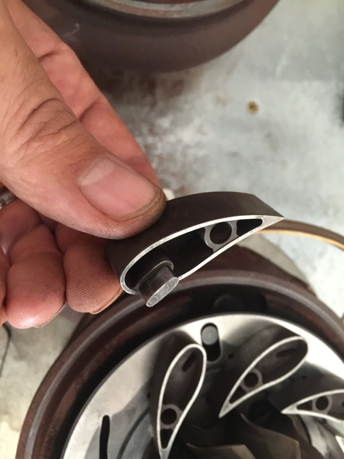

In the second photo it looks to me like some of the vanes were indeed sticking. So it'd definitely be worth cleaning, especially the vanes themselves. 5 out of the 9 vanes look like they were stuck and not moving too much if at all.

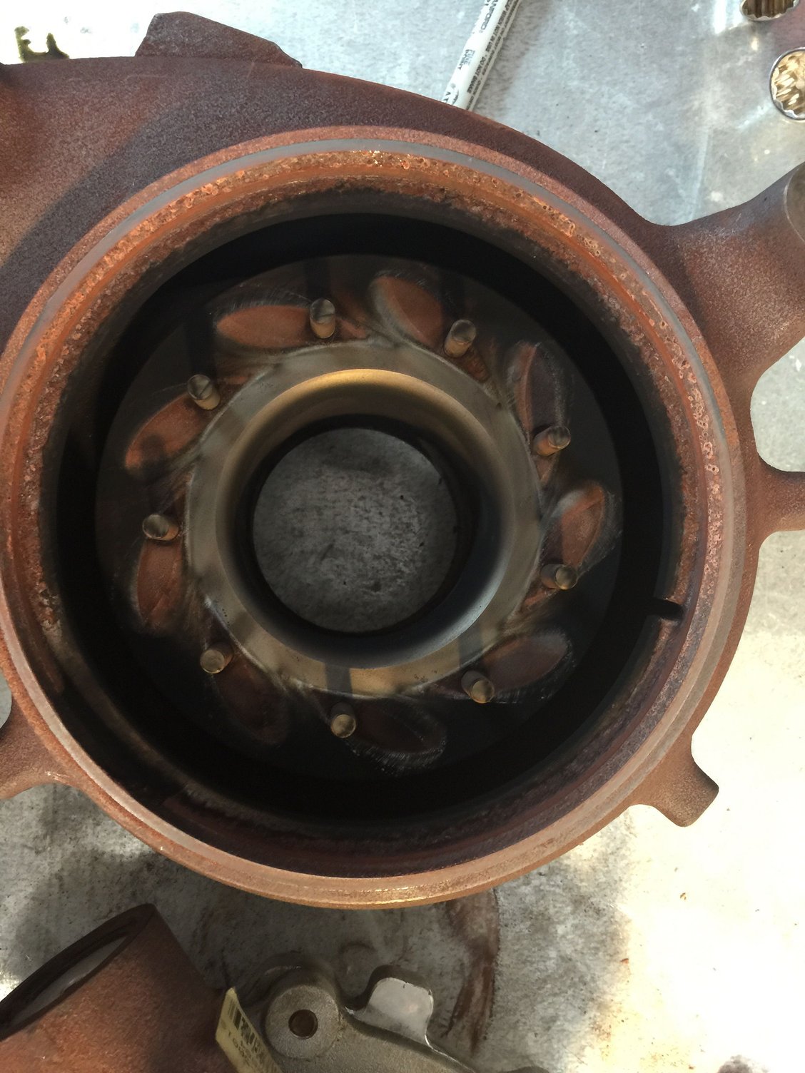

What did the unison ring look like?
Clean and clean some more then. What is the best method to clean?
Forgive my ignorance but what is this unison ring you speak of?

Attached is the unison ring and the kit you need from Oreilly auto parts to clean the turbo.

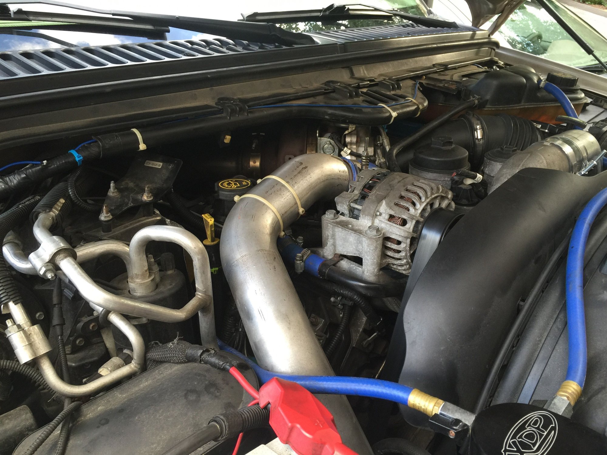

Well. All put back together and went for a test drive. Back to square 1, the same noise is still there.
At least I can comfort myself with that the turbo is clean, all the boots are fresh, the cold tube backdated to metal, the exhaust is leak free.
Pics of the progress this far.
