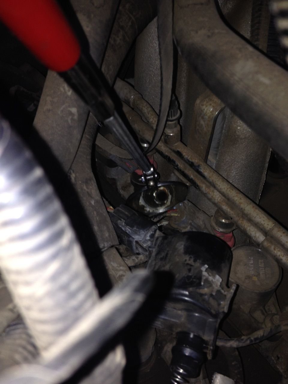

The usual ticking noise for weeks before the blow. (Thought it was an exhaust leak, or maybe a lifter.) Blew on the freeway under normal load at 65mph. COP broke.
Plug still in the hole, but pulls out. Didn't try to see if it'll screw in. The plug's porcelain center section spins freely in the outer metal case, and moves up and down in there about 1/32 to 1/16". Never saw a ground insulator do that before.
Need a few questions answered.
What is the proper 4.6l plug torque? 11, 15 or 28 ft lbs.? (may re-torque the others)
If it backed out enough to come free, is it worth trying to torque a new plug down?
Being the 3rd plug back, on the passenger side, will a Time-Sert tool set work back there, or is it too tight?
Is the 4.6l really less-prone than the 5.6? I read that from a long term member in here. I thought those heads were the same.
From the Time-Sert page:
++ TIME-SERT, problem FORD 1L2E heads use p/n 5553 ++
"If you are repairing a RF-1L2E or RF-2C5E head, this is a Romeo 2001 and up PI head. Due to a countersink problem with the head design, a special counterbore tool P/N 55518 is needed to give the hole clearance for the repair."
"If looking down from the passenger side it should be located just below the oil dip stick.
If looking down from the driver side it should be located further back near the firewall."
I looked at the pic, and read the directions. I could not locate this casting number. My dip stick is on the driver's side, not the passenger's....
I could use some help determining what heads I have. There was a sticker on the front of the driver's side head. It has this on it "6K 2L3" and the rest is unreadable.
Here are some pics of the hole and the engine compartment. Hopefully someone can tell me what I have so I can get the right kit, if needed?
Thanks guys....

By 2003 there where no more blown plug issues on either the 4.6 or 5.4 as an ongoing issue.
Likely your plug had come loose.
Your photos show a Windsor motor as far as I can tell..
To be sure, the valve covers had a different amount of hold down bolts between the two versions.
If you look at your VIN number, the 8th digit from the left is the engine code.
2= a V6
W= a Romeo 4.6.
6= a Windsor 4.6.
L= a 5.4.
The year of the motor is the 10th digit.
V= 97.
W= 98.
X= 99.
y= 2000.
1= 2001.
2= 2002.
Good luck.

Hi Bluegrass 7
8th digit is a W - so Romeo
10th is a 3, so a 2003 from the looks of the progression.
Well, if I can't screw it back in, then at least I know it's a Romeo I'm dealing with.
Thanks for helping me figure that part out.

Very strange, Bluegrass. You ID'd the engine as a Windsor. I read in another post that Windsors have the oil fill on the pass side, which mine does. Yet I have a "w" code in my VIN, 8th place. Engine has never been changed. 11 bolts on the valve cover are Romeo, right?
Seems there was some sort of oilf fill and dip stick location swap for '03?

Ford labels everything as if you are seated in the driver's seat facing forward.
For a V-engine, not transverse mounted: Start at right front, count to rear. Go to left front, continue counting.
For an inline engine, not transverse mounted: Start at right front, count to rear.
For a transverse mounted engine, mentally rotate the engine 90° CCW as viewed from above (or rotate your perceptive the opposite), then use the above scheme.
BTW, I do have a rental 5553 kit available, PM me if interested.
The Windsor/Romeo differences are something I've never gotten into. WTH Ford hasn't standardized the engines (maybe they have by now) between those plants after decades is beyond me.

I cleaned up the OLD plug. The threads on it looked good enough for a test. All I wanted to do is see if it backed out a ways before blowing out. Since the center electrode and porcelain insulator spun freely within the ground casing, I imagined that the casing could have spun free most of the way before coming out.
I painted the threads and seating surface black with a Sharpie, and ran it in the hole. It got stiff. Pulled it out and saw that the black had come off some of the threads and the seating chamfer. Did it again.
Results:
It took only TWO turns to seat the plug. Sounds like at least 4 threads are toast, meaning, Time Sert. Going to try to find a shop that uses it, since I have a jacked-up left arm (tendonitis) and a recovering blown disc in my neck. I used to build engines up til '97. Not sure I could even work that reamer back in that hole now....
Anyone know of a good shop in Manteca, CA? Time to research....

Time Sert has been in since Monday, and new plugs, too. Runs just fine. Paid $309 for the TS installation and they installed my plugs for me for another $50.
