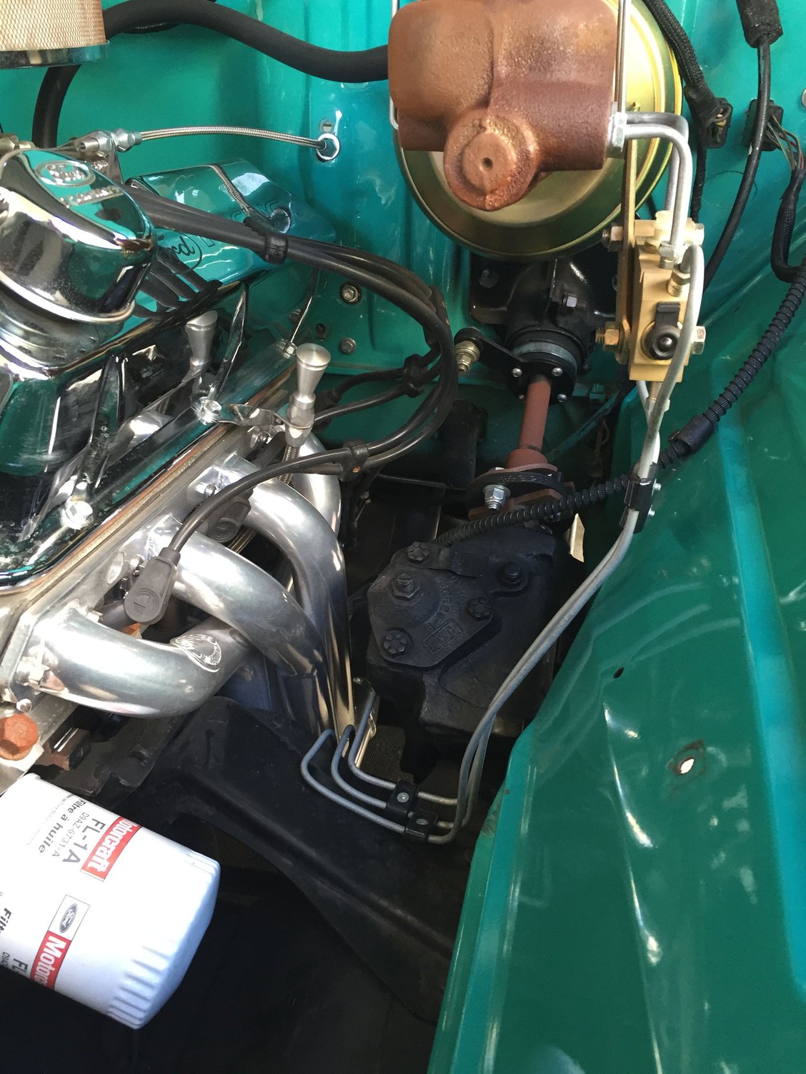

This is a photo of me engine compartment.
Thanks, Vince

Nice and clean Vince. That is a standard Bendix gear, the power Saginaw gear has a different config up top that will move your shiney bolt connector 2 1/3" closer to the firewall. You can cut your existing column or swap in a matching shorter column from #2 post.
We have |-x-----| & change to |--x----| The distance from 1st | to second | remains the same. I suggest go yarding & get everything needed from pump bracket including spacers and bolts, pump lines gear and column.
