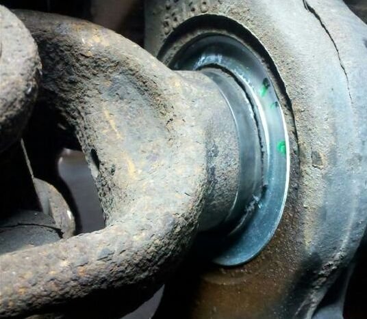

Yahiko, sounds like you're talking about inner seals which are the farthest from the ujoint. He said the ones by the joints..
If you got this :
And want to replace it with this newly designed version:
You need this part number:
Ford AC3Z-1S175-A
If you got this :
Ford AC3Z-1S175-A
That one only keeps the dust out and not the oil in.
EDIT : added quote info and photos.
He said that he was loosing fluid. OIL?
If that is the case that outer seal only stops dust.
It's the inner one that is the one for the oil.
This one has the exploded view >>> 205-03-1 Front Drive Axle-Differential
I though that I had the part number for the dust seal but guess I don't
have it hear. I can tell you that they are $21 for one and your going to also
need a knuckle seal set when the axel comes out.
Also your price may not be the same as mine.
Sean
