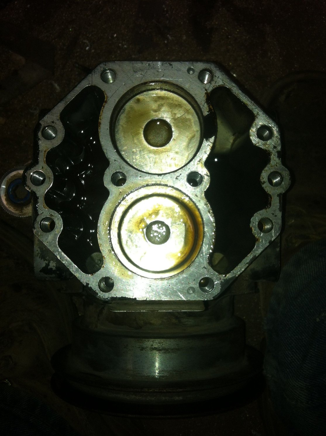

Air compressor
What do you think

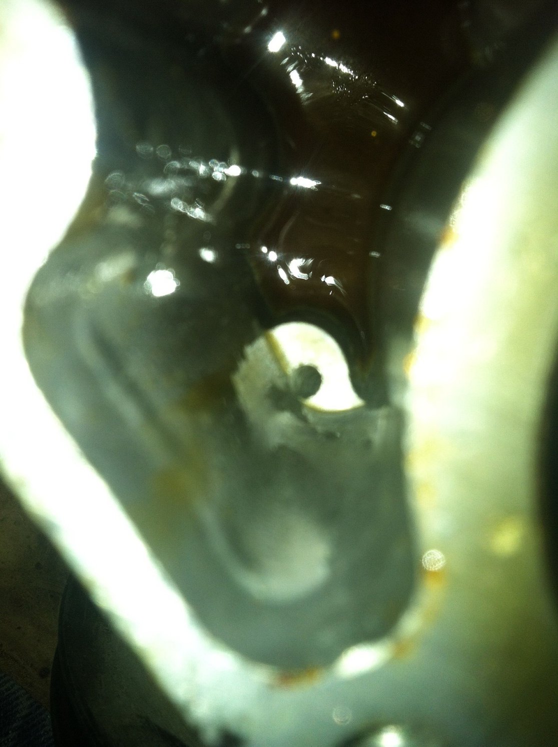

You have to plug this hole once you get the compressor apart till it looks like the other picture otherwise it will lubricate everything the compressed air goes to

From what I can tell you need a way to get oil and water out of the air even with that hole plugged you get a bit of oil loss into the air
