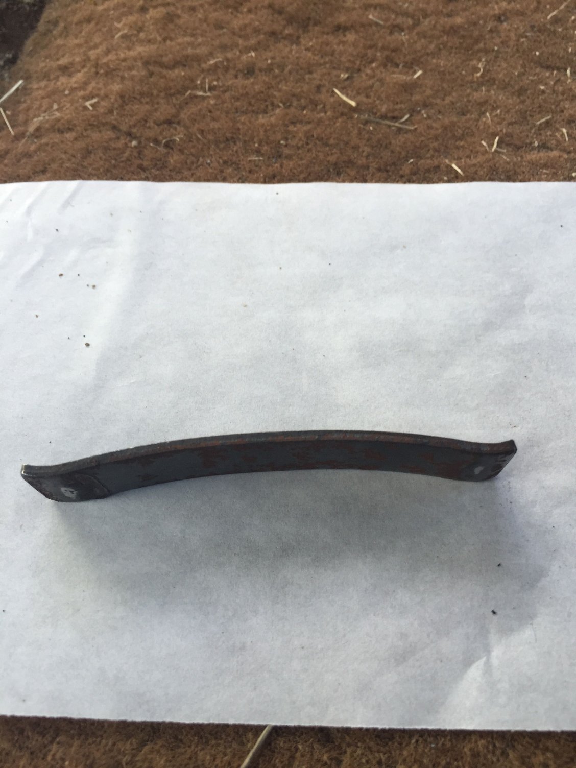

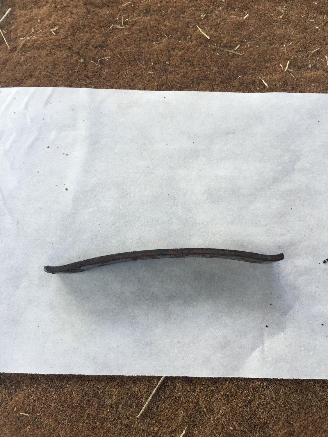

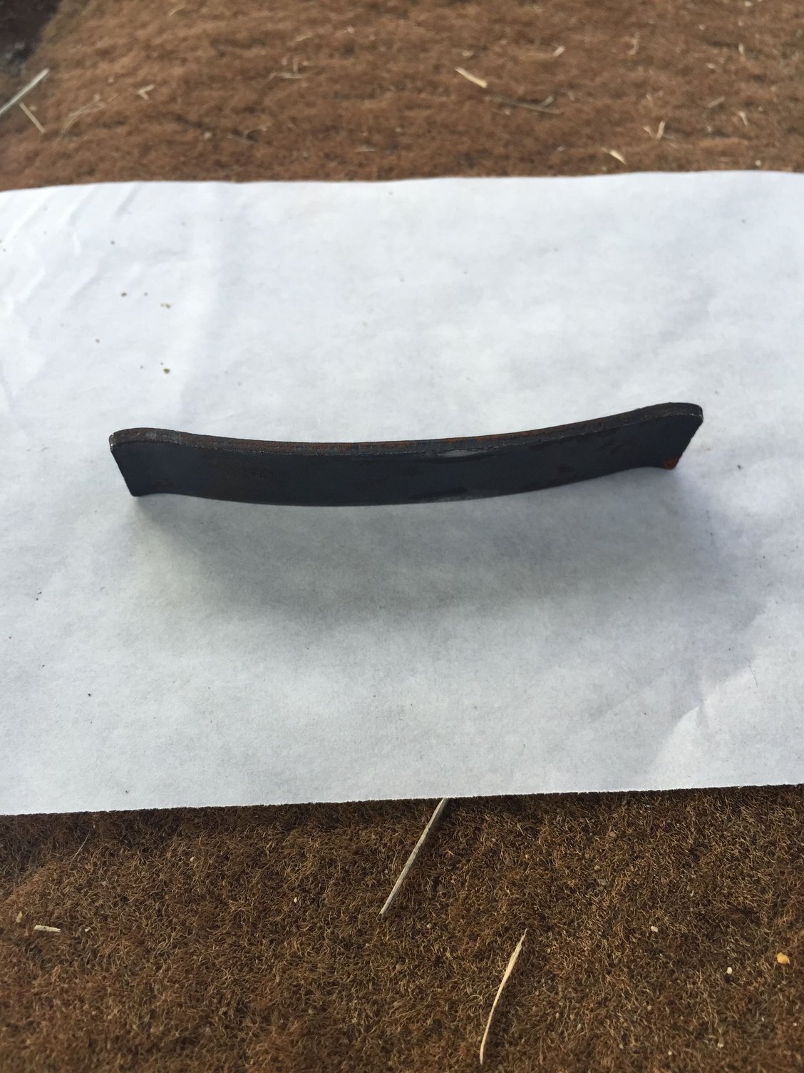

In my haste, I pulled out the shaft all the way out. And out came this flat metal piece (about 3" x 3/4"). It is has an arch.
I am assuming that it goes into the notch on the shaft itself to help center it.
Do I just put the peice in the notch with the arch facing outward and keep it there while I put the shaft back in? There is no fastener.. it just sits on top.
Is this correct? Any help would be appreciated.

Some pictures would be helpful.
Old Jul 30, 2015 | 08:05 PM
kennyfzj80's Avatar
kennyfzj80
Joined: Jul 2015
Posts: 150
Here it is....

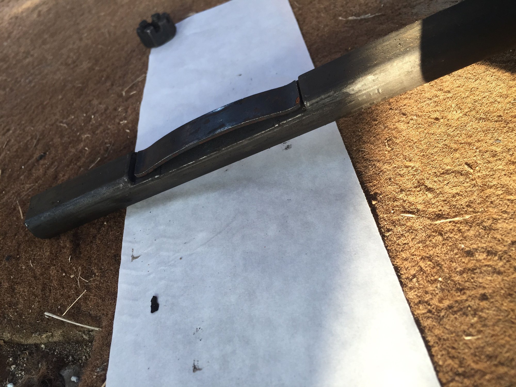

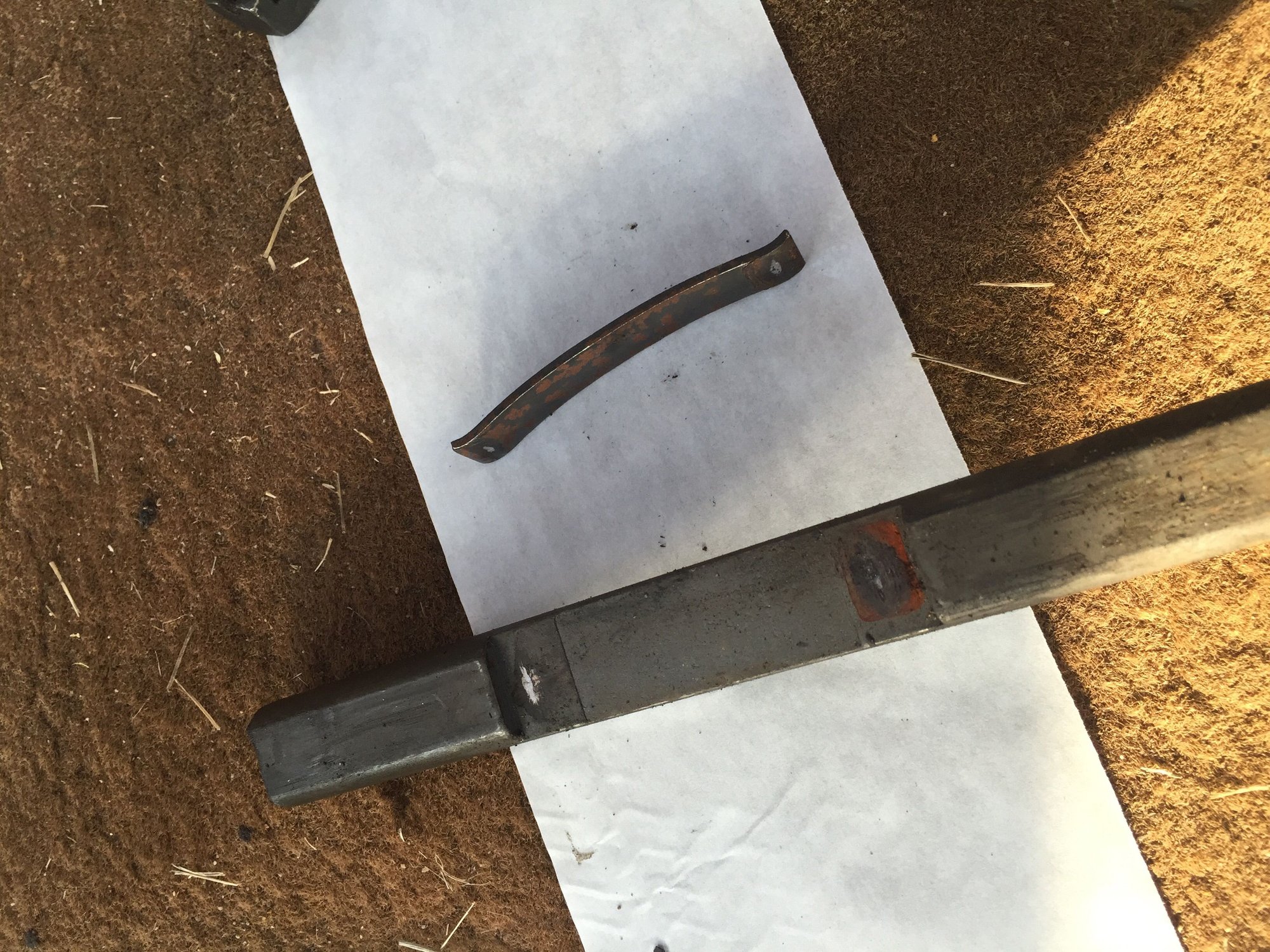

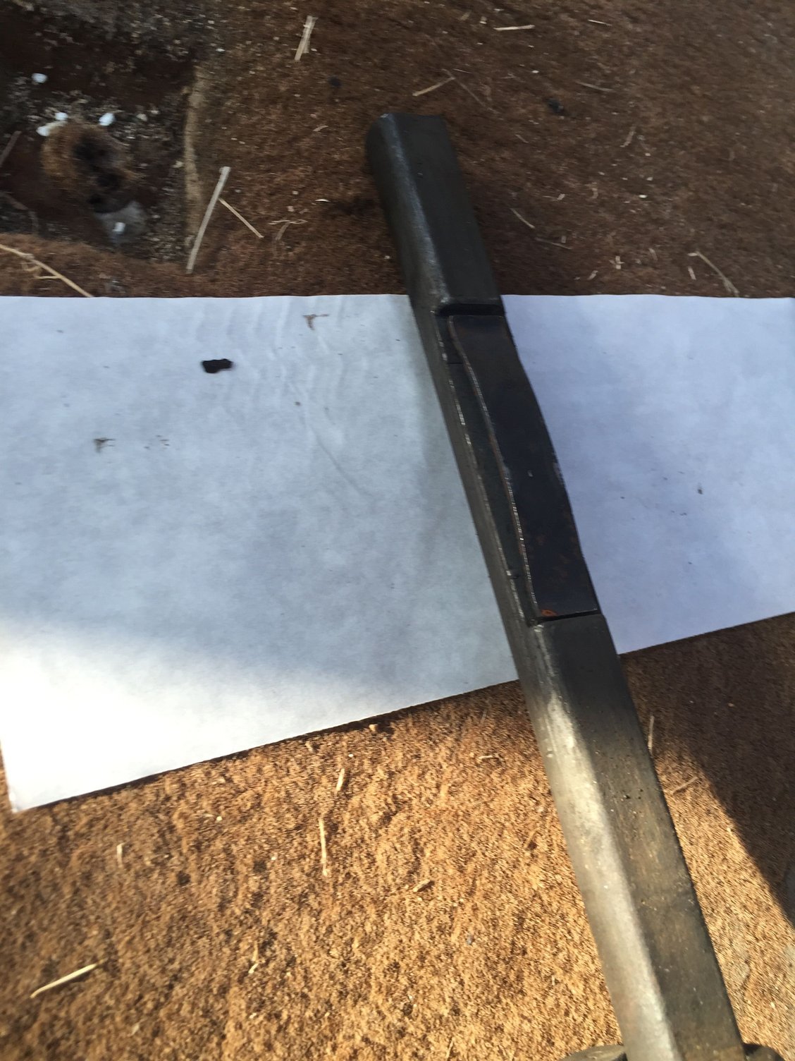

And one of the offending shaft?
Old Jul 30, 2015 | 08:36 PM
kennyfzj80's Avatar
kennyfzj80
Joined: Jul 2015
Posts: 150
Here it is. I had to remove everything again.
Looks like that's where it goes. Was it welded on there at one point or does it just simply sit on top while I put it back in?
And what would one without a welder do? JB?

There might be a database error because that 2nd pic isn't mine.

It looks to me like the metal piece exists to provide a little resistance so the telescoping portion of the shaft doesn't just fall out when disconnected from the gear. If it were my van I would put it back together without the piece and not worry about it. Or just slide it in with the piece in place; it won't go anywhere unless you remove the shaft again.
If you're concerned about it you'll want to replace the shaft. I wouldn't be though.
