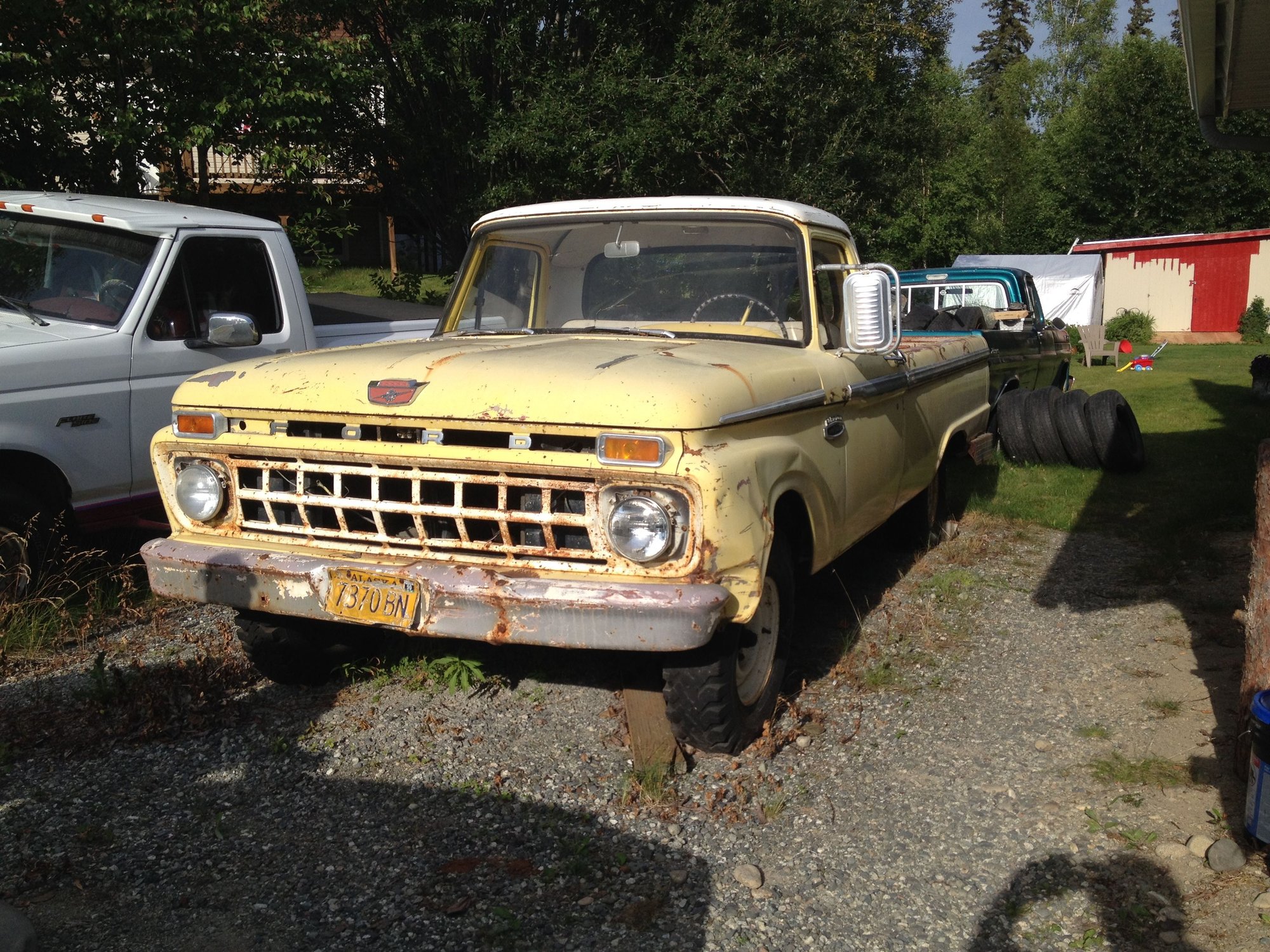

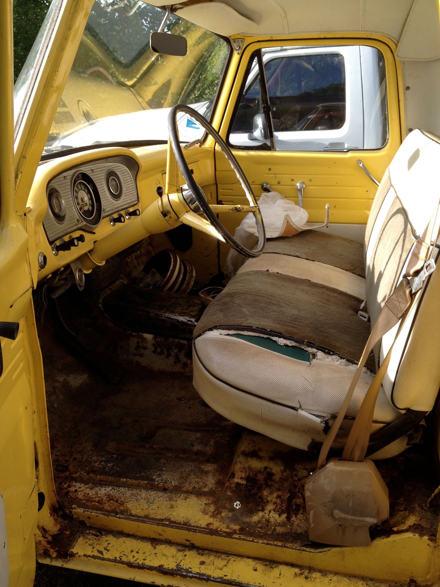

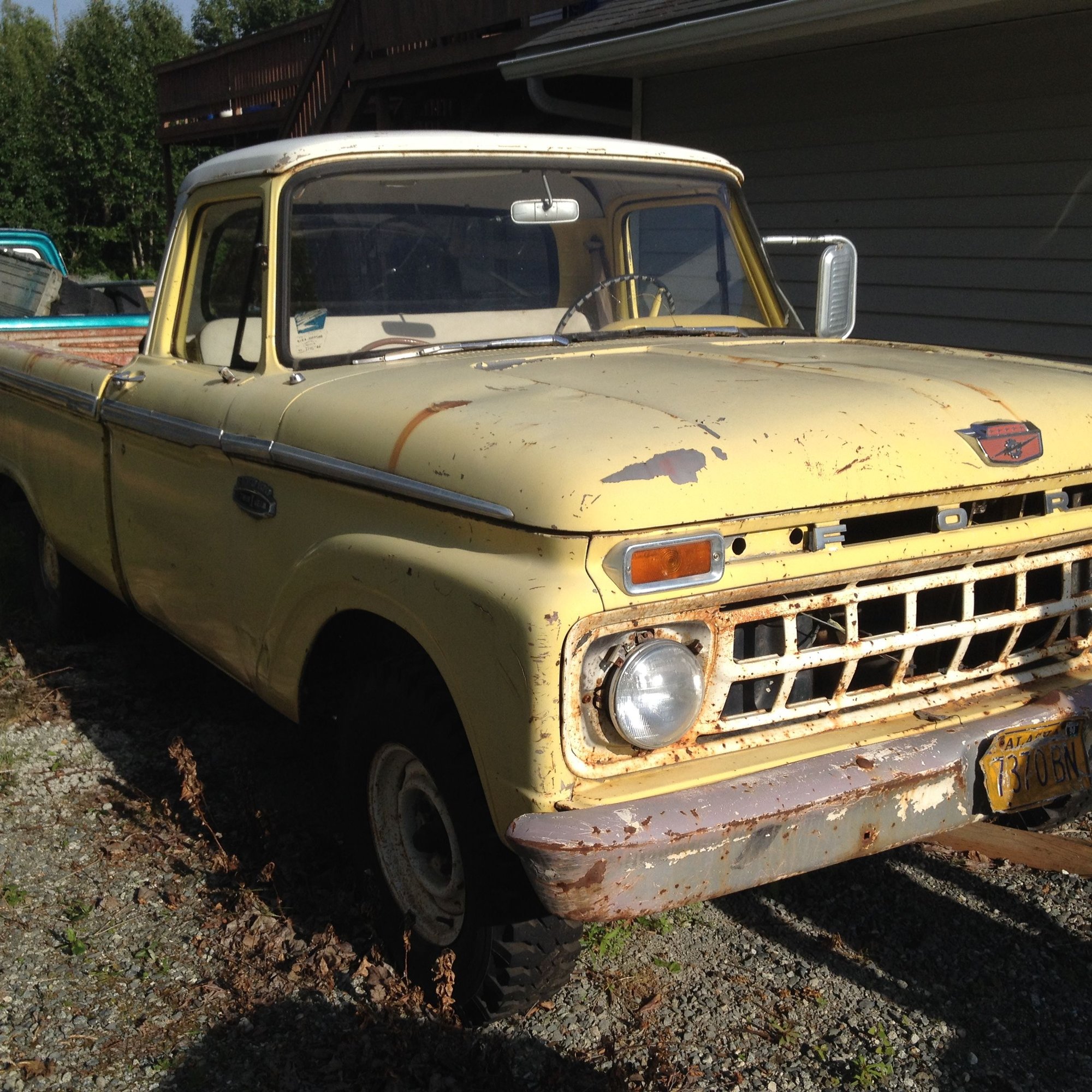

Hi All,
I looked at a possible parts truck today for my 65 f100. But it has potential to be restored itself. Im wondering how it came new. What can you guys tell me about it?

Originally Posted by Grape Nehi
F10 = F100 2WD
B = 300 1V I-6.
R = San Jose CA Assembly Plant.
687534 = 1965 .. assembled April 1965.
129" Wheelbase.
M = Wimbledon White.
F100 2WD .. 5,000 lbs. GVWR
381: 3 = Medium Green Crush Vinyl & Medium Green Wicker Pattern Vinyl / 81 = 81A Standard Cab.
F = Borg-Warner T-18 4 Speed Manual Transmission.
08 = Ford 9" Rear Axle / 3.50-1 / 3,300 lbs. Rear Axle Capacity.
5,000 lbs. Gross Vehicle Weight Rating.
150 net HP @ 3,600 RPM
74 = Seattle WA Ford District Sales Office, where the original selling dealer ordered the truck from.
