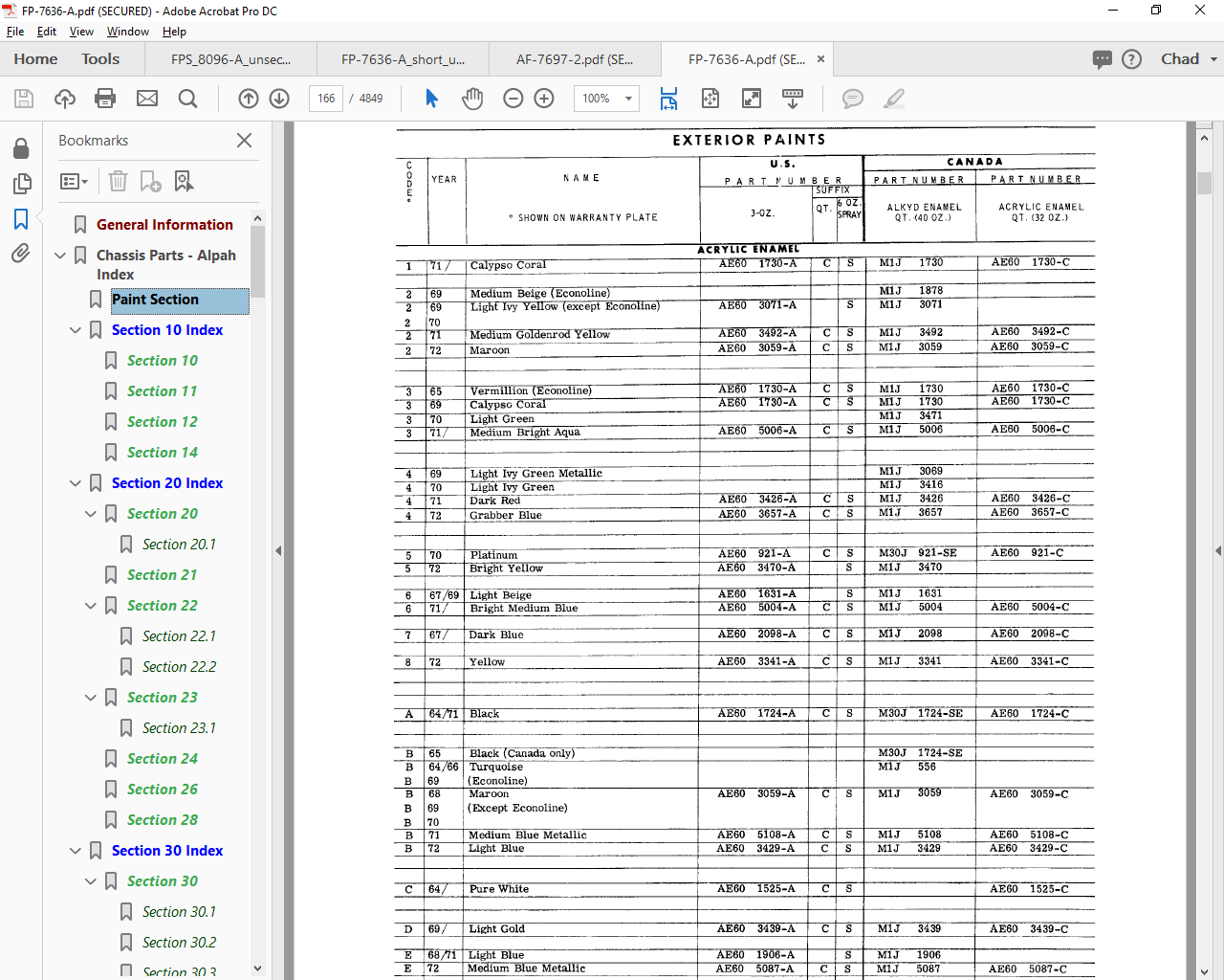

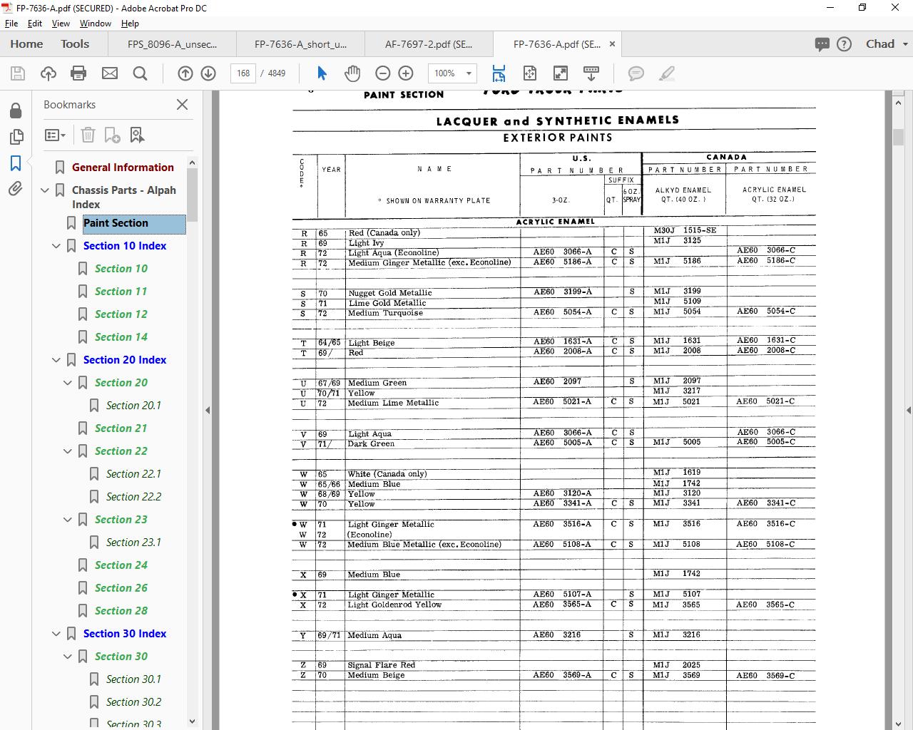

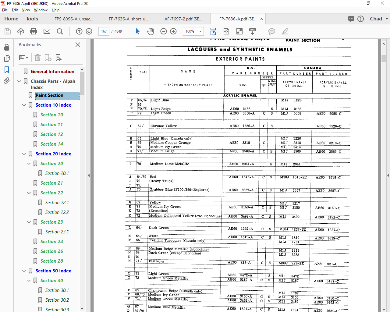

Here's the info showing C as Pure White (U.S. and Canada) and the L showing as Dark Green (U.S. and Canada)
Might be sort of small to read real well, but you can hopefully see that C is Pure White and L is Dark Green. Canada did have some variations from U.S. like Rangoon Red is R (RR) instead of J. Canadian trucks also called out a two digit code for exterior paint. If the two letters are the same (CC) then it was a single tone paint job on the outside. If the letters were different than each other (i.e. UH) then it is a tu-tone paint job.
