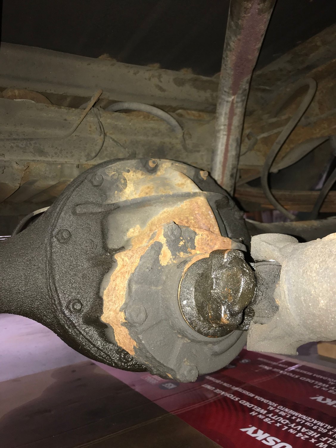

My vin says I have a Dana44 but isn’t this a Ford 9 inch?

I'm getting ready to do some work on this rear end, such as new gasket and maybe change gearing and need to be sure of what rear end I have. Thanks,

I'd like to have 3.73 possi.
that is definitely a 9”
