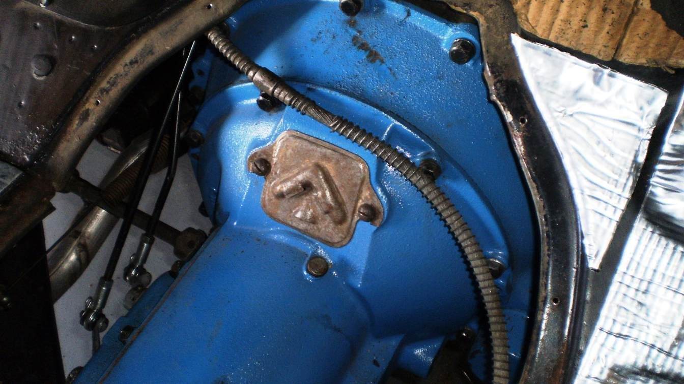

So here is my rear axle and the only tag I could find. The truck is really low geared. Are there ring/pinion sets available for this axle?
Also I have clutch engagement chatter and adjuster rod all the way to the end of the threads. So looks like a clutch job in the future, will the tranny only come out through the floor or can it be removed from underneath?

The tranny drops down easily.

Your rear axle is a 3.92 ratio if the tag is correct for the axle. Not sure about the '51 - '52 vintage but I think the rear axle is the same as my '49 and '50. If that's the case, then no after market axle gears are available. I do have a 3.73 axle though on my '50 which was available back in the day. If you find one of these that is not worn, you could install that.
The fact that these gears are not available in lower ratios is why people swap out axles for Ford 9" and 8.8 rear axles which are more popular as well as newer.

I took my 51 rear with 3.92 gears to Randy's Ring and Pinion in Everett, WA. I had it changed to 3.73 gears. A little more pricy as they had to replace the carrier as well. They also sell parts for these Dana 44 axels too.
RANDYS Worldwide Automotive
They have distribution centers in California and Tennessee too.

Actually, the 48-50 trucks came with Dana 41 rear ends. And, yes, the vast majority seemingly were 3.73's. The 51-52 trucks were equipped with Dana 44's. There are indeed some available aftermarket R and P swaps for the Dana 44's. But none of us have been able to find any replacement sets for the Dana 41's, AFAIK.

You might be able to get the trans out the bottom but it would be a total PITA compared to removing the seat and tunnel cover, and lifting out the top. If you have the light duty 3-sp (column shift) it weighs maybe 50 lbs, easy to manhandle out. If you have the HD 3-sp or the boat anchor 4-sp, you can use a cherry picker thru the door. Last time I pulled mine, I had it out in an hour and a half, not really trying hard.
