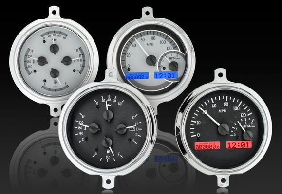

I ended up shelling out the cash for the Woodward series 3-in-1 kit. Speedo with 2 gauges and tach with 2 gauges. Close to $600 but they seem very well made and its a Michigan company about 15 minutes from my house. New Vintage USA

I have a set of Classic instruments in my 56 and a set of Nu Vintage in my wife's 52. I like the Nu Vintage much better. Just my .02

Those gauges look nice. Ive been real happy with Dakota Digital in the past. They are pricey too, but also made in the USA. They are more modern looking which is good or bad depending on the build. I'll be using them for my 53. I think I like the ones you picked better though for your year. The DD gauges for your truck the tach is sort of small.

I wanted a traditional large speedo and tach. I stumbled on these when I was looking at the ones in my original post. I like Dakota digital but the NVU fit my truck a bit better as far as styling.
