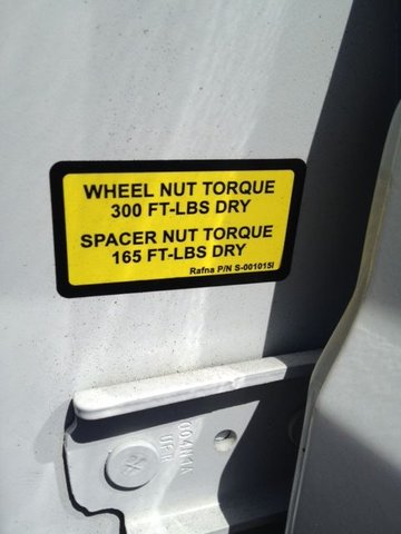

I just purchased a 2011 f350 xlt SRW with 18" aluminum wheels, and notice it has a yellow sticker on the door pillar stating that the wheel nuts should always be tightened to 300 ft lbs...
Now this seems a little extreme, I don't believe my torque wrench even goes up to 300...
Is this bona Fide? Assuming not, then what is the recommended torque setting for SRW aluminum wheels?
Pic or it didn't happen
Okay, here ya go:
