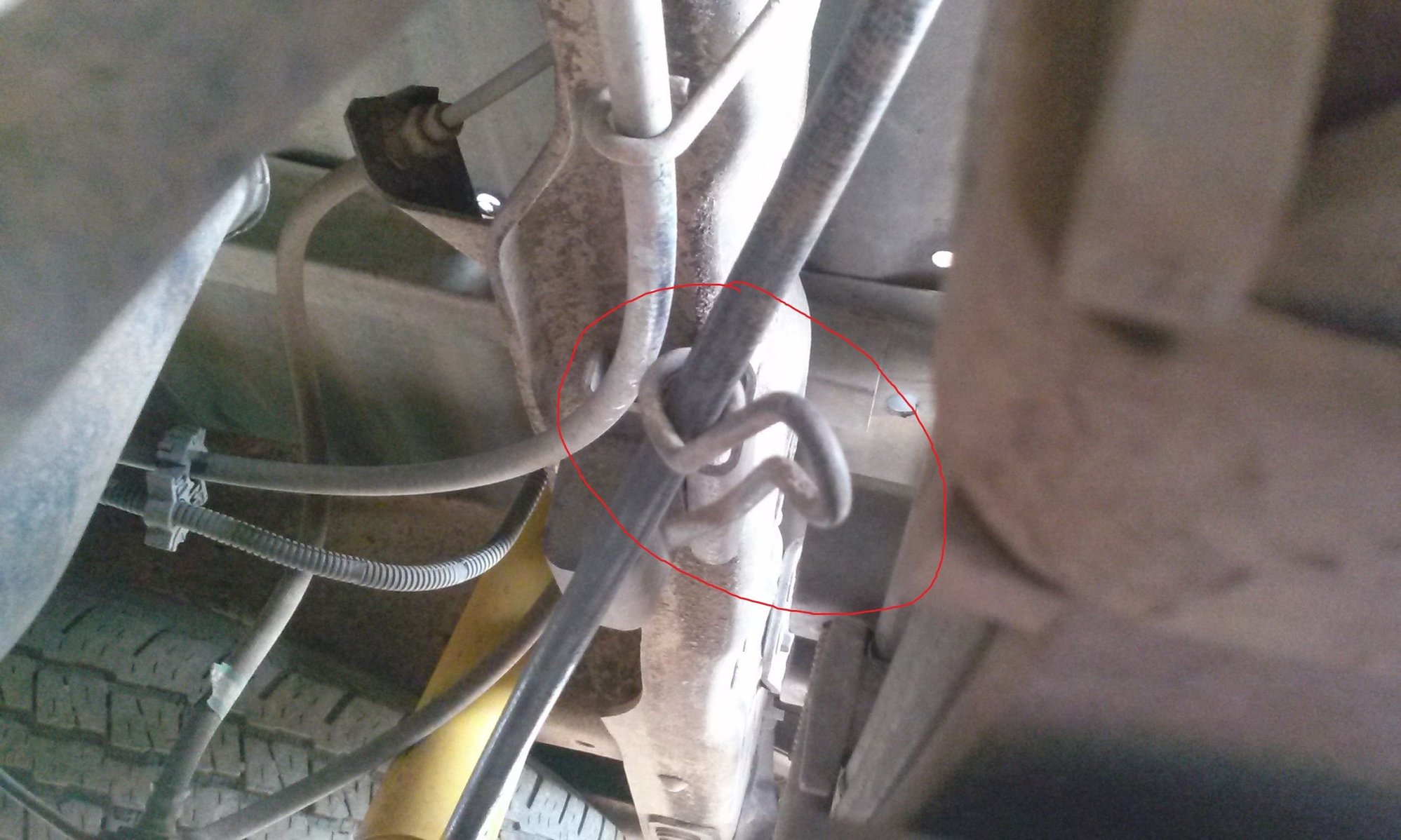

Ever since I have owned this truck I have had a metallic rattle every time I hit decent sized bumps. Sure sounded like it was coming from the front. I rebuilt the front with ball joints, shocks, tierods to fix other issues. Still rattled. I inspected all the bushings, push, pulled, banged on just about everything under the truck to reproduce/track down the rattle. NO LUCK. Over the 4th of July weekend we went camping and had to travel down many dirt roads. Of course the rattle was there but I determined it was coming from the rear. Today I was bored so I crawled under the back end and started checking the leaf springs, overloads, shackles to see if they were the issue. While under there on the drivers side, I noticed one of the parking brake cables was between the overload spring and the perch. That didn't look right so I moved it to the top of the perch. As soon as I began moving it it rattled! Hot dam. I found this metal bracket loose on the brake cable. It was banging against the leaf springs. Not sure how it attatches, maybe clips the two cables together, I don't know so I just zip tied it so it won't RATTLE! Woohoo!!
I know there have been other posts on a rattle so I hope this helps someone. This was way to simple for something that was making me NUTS!

Great find, I have that same truck with the same rattle that has been bugging me from day one, I have been under my truck so many times looking for it. I'm not sure what you found in the picture you posted though

Top left brake hose bracket?

This bracket is supposed to hook the two parking brake cables together.

Got it , Thanks for the update
