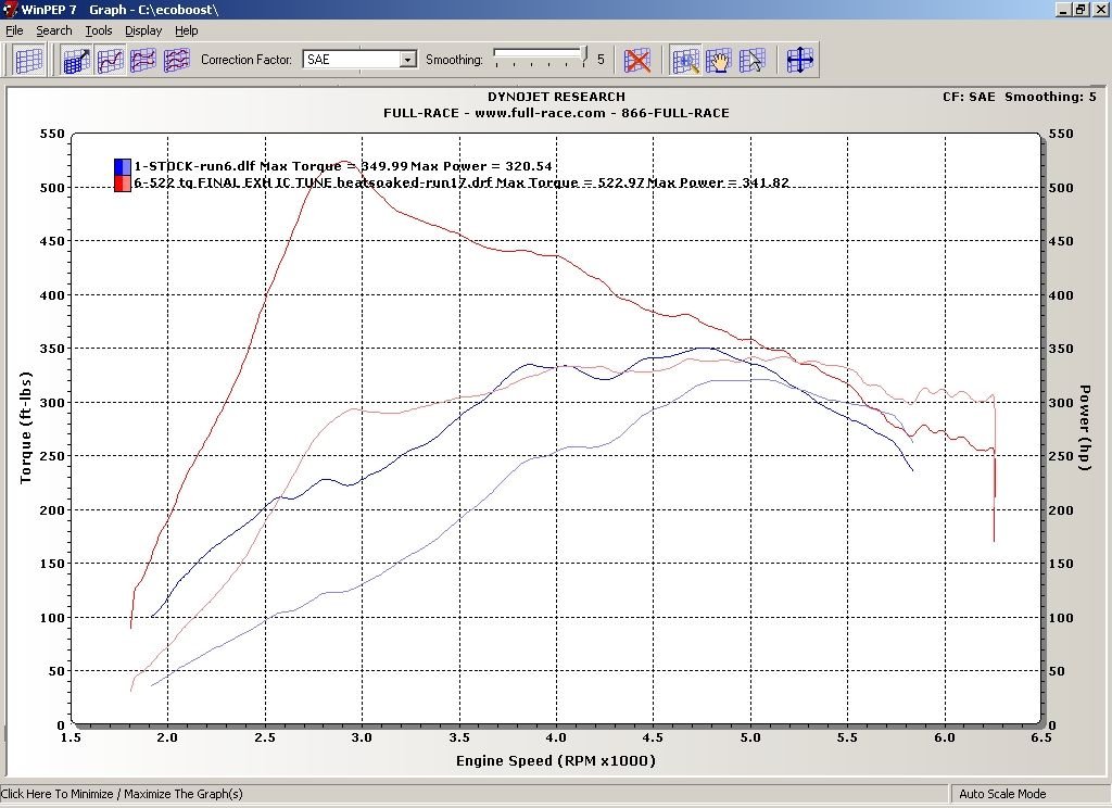

As far as comparing a DI-T diesel with a gasoline engine, the only points I make are that they are both DI-T engines, and that the torque curves I've seen (especially after mods) are very similar to my diesel, except that the EB curve shifts higher in RPM (as expected). That's why when I first looked at & drove the EB back in 2010, I immediately recognized how the truck "felt" like my diesel. Seeing the dyno curves later on confirmed what my SOTP (seat of the pants) dyno told me... And before anyone says it, I am purposely looking at mod'ed & tuned numbers because I never intended on leaving mine stock.
My 7.3L from 2010 (mod'ed & tuned):
Typical 3.5L EcoBoost (stock vs. mod'ed & tuned):

One thing just occurred to me looking more closely at the graphs that is quite interesting, and call it apples to oranges if you like. But my 7.3L mod'ed & tuned was at a bit over 1000 ft-lbs at the wheels. The 3.5L mod'ed & tuned is a bit over 500 ft-lbs at the wheels. Half the displacement, half the torque just about to the digit in an almost identical curve. That math is nice.....
