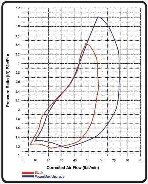

This is a supposed to be compressor map comparing the GTP38 (Red line) and GTP38R (Blue line) I found it on another thread on this site. Can someone explain to me how this is read?
I am going to school to get my bachelor's in Mechanical Engineering and would love to work on diesel engines or turbines one day. One reason I've been very active on this site lately. Also I would love to learn the basics and read things like this add if it were a children's book
So back on topic. (Completely disregard the red line for this)
To me I see that the GTP38r makes max boost at pressure rating 4 and pushes 53 lbs/min of air. But I also notice that at 2.3-3.1 it pushes about 73 lbs/min.
Would this be the range of the turbochargers efficiency? If im reading this correctly that would relate to my post saying you can make more power at a lower psi? If I'm reading this wrong let me know.
I don't understand the left steep line and the right curved line. And would love to learn.

I think the P2c/P1c ratio is in reference to inlet and outlet pressures of the turbo compressor. I don't think I've ever seen a graph quite like that but what I think is going on is the bow on the right side is the turbo spooling up and the drop off on the left is when the drive pressure stops and the turbo starts to drop off.
