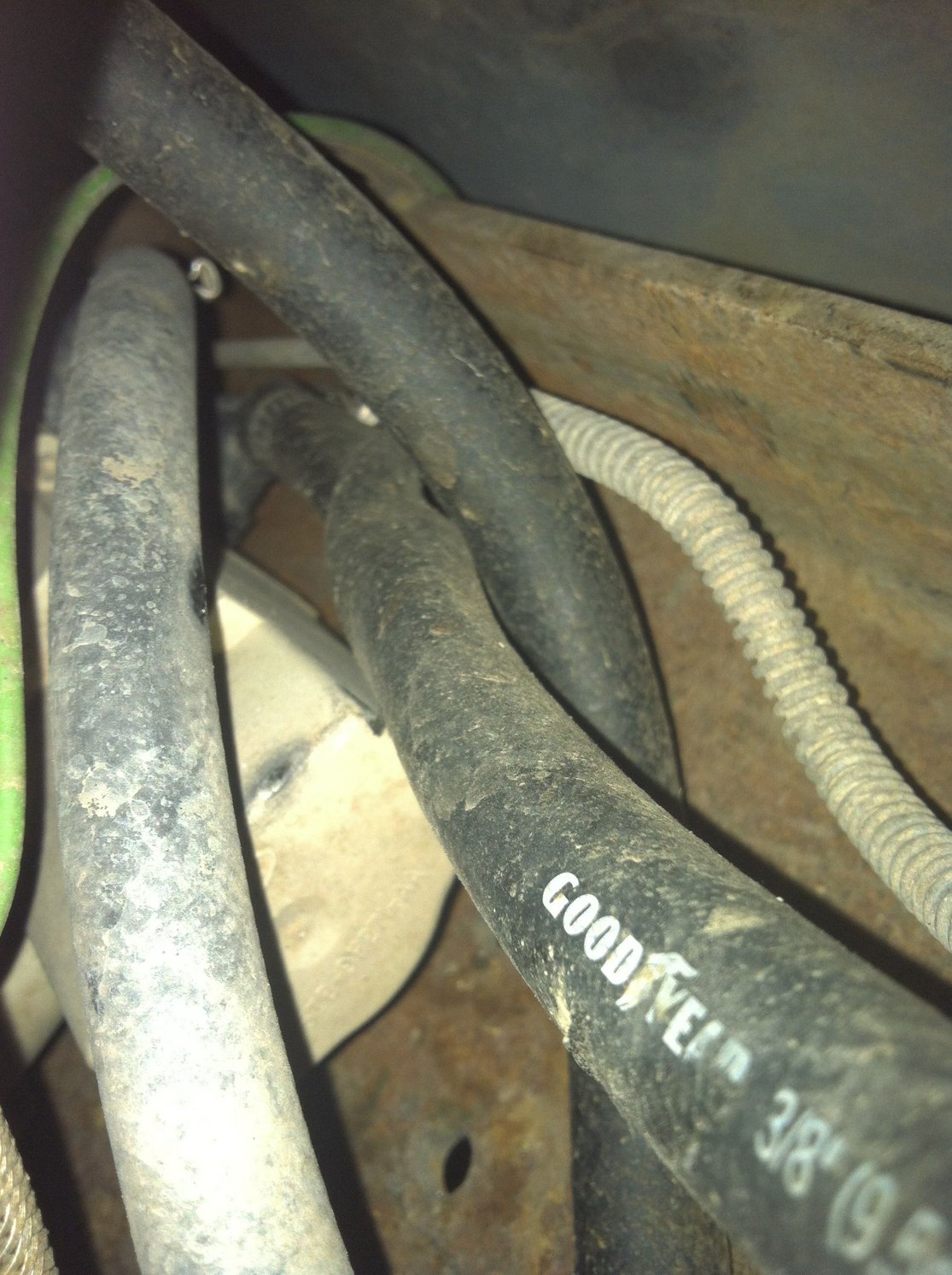

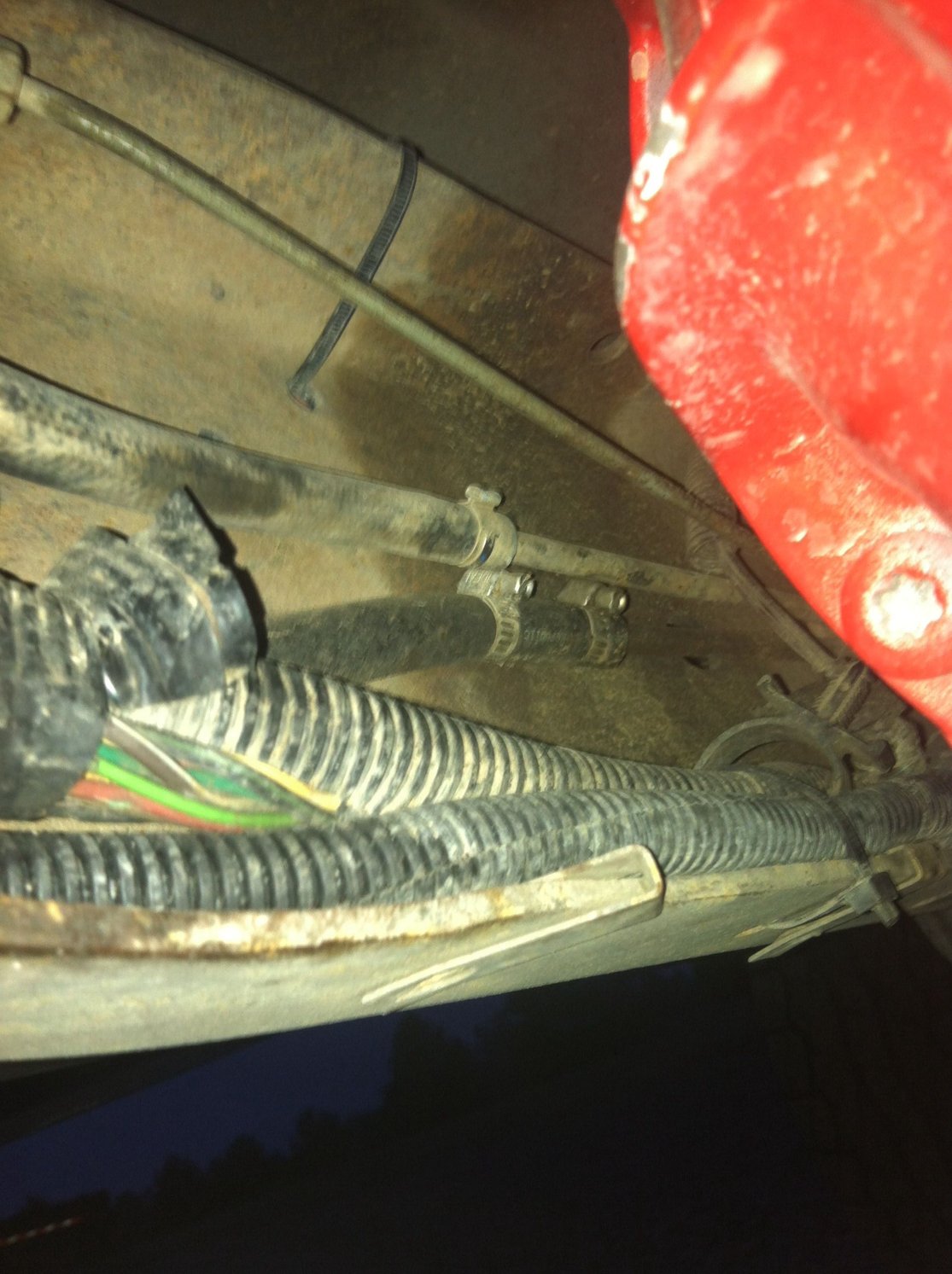

First thing I noticed was the pressure didn't bleed off. Both 044s went to zero right after the pump turned off. This one holds pressure and does not bleed off, after a couple minutes, yes. Do others systems built by others on here? I keep second guessing myself on my hookup. My feed from the pump hits the bottom OE steel line on the frame rail,return is the top. Suction side is to the selector valve fitting on top closest to frame. Return is on the other. After reading countless threads I don't think I could have screwed it up....but I'm a dimwit too! Up top of motor I know I'm good.

Pic for reference:
First is my feed post secondary filter going into the bottom fuel rail.
Second is my suction to pre filter on the inside fitting of the selector, outer hose away from frame is the return.
