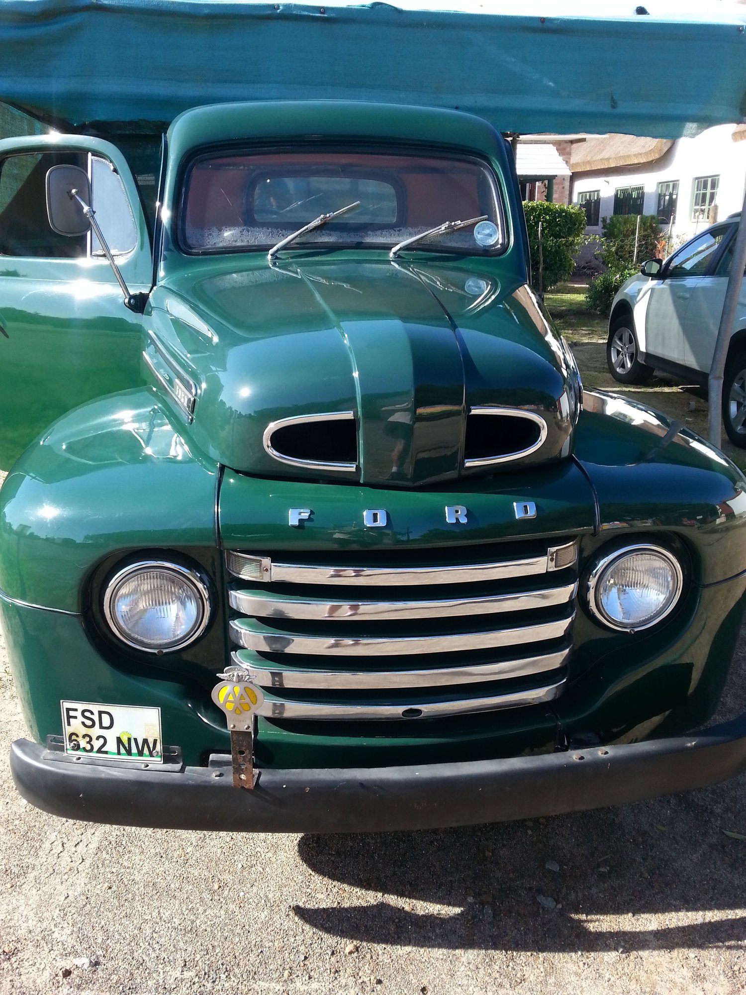

Thanks for the reply FortyNiner but I have a wiper switch below the speedo. Will take a couple of photos of the dash when I get a chance. The truck that was on ebay was sweet.Bobj49f2 do you know if it sold and if so for what price?? Mine is also missing the bonnet catch and from what I understand they are quite difficult to get hold of. Herewith a pic of my baby..

Interesting to see a right hand drive F-1.

That's a good looking little truck you've got there. I like the dark green. I would guess that somewhere along the way somebody modified the wipers (probably switching over to electric) and put the *** in a former choke/accessory hole below the gauges.

Welcome to FTE, White Lion! That is a sharp looking truck you have there. I love the dark green.

That is beautiful!
