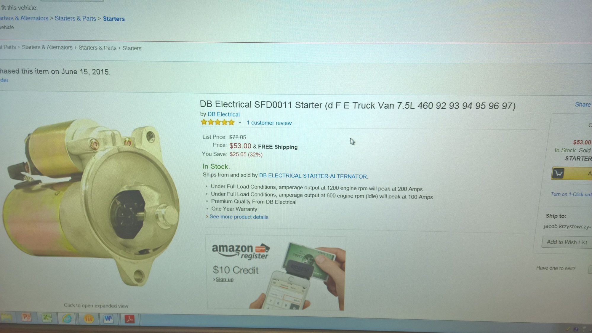

Originally Posted by Alexz265
I highly recommend it. Big difference with my 460.
Fyi picture of pmgr for 460 manual. Exactly what I ordered.
Say something about this photo
In case anyone doesn't know, to wire the pmgr, move the starter power cable to the hot side of the solenoid on the fire wall. This then runs to the power terminal on the starter. Then take the correct length of 10 or 12 gaugewire (I used red) and crimp loops on each end. One goes on the starter solenoid on the fender where the power cable to the starter used to connect. The other goes to the solenoid on the starter. So you wire it so the starter always has a 12v power supply and when you turn the key, the solenoid on the fender sends power to the solenoid on the starter to start cranking.
