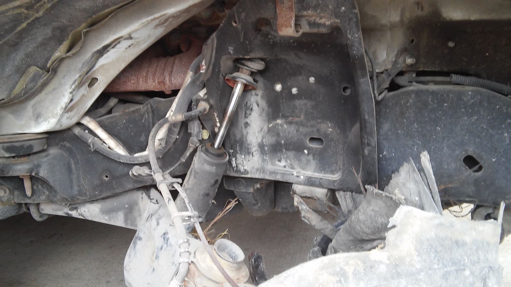

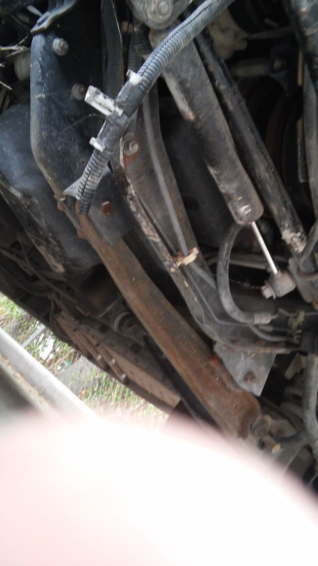

Well, progress has been slow. Just got the body shop to start on it today. All I've authorized is repairing the suspension and steering. Found a used I-beam for $125 and the rest of the parts are under $400 new. Shop doing the labor for $450.
Here's some pics of the damage. Bad news: the body shop's tow truck wasn't long enough, and he didn't figure that out until if was off my trailer and halfway on his bed. Couldn't get it back on my trailer from that point without a forklift. Ended up crunching the oil and tranny pans a bit.
LH wheel well. You can see the up-bend on the top of the frame, just to the left of the shock.
just a sideways shot showing the missing LH I-beam
back of the wheel well showing where the body has lifted up off the frame.

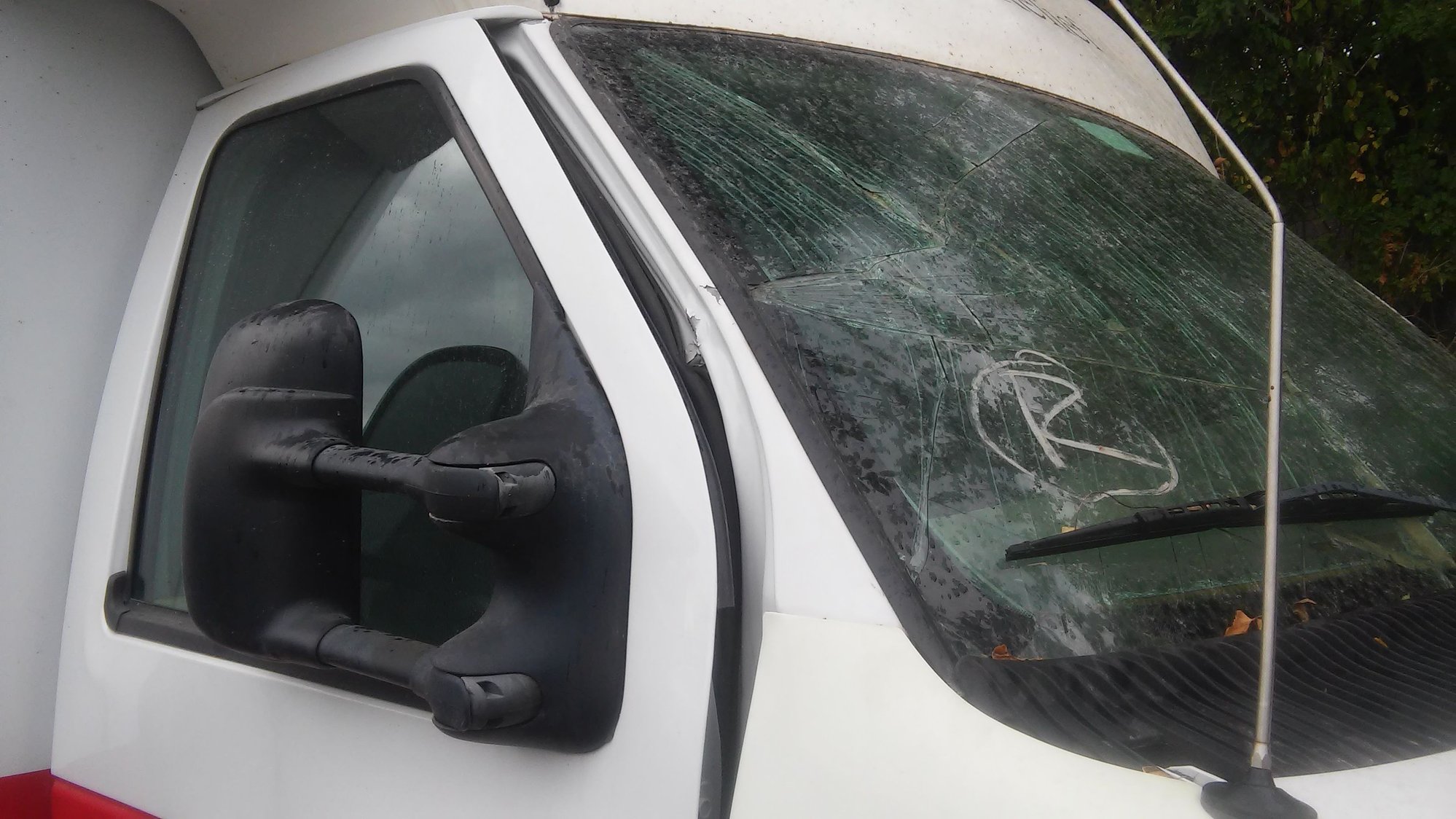

the pros knew immediately that the frame was bent when they saw the bend in the door frame right above the mirror mount. That cracked the windshield. Told me cars aren't designed to bend there, so they knew the frame had to give.
