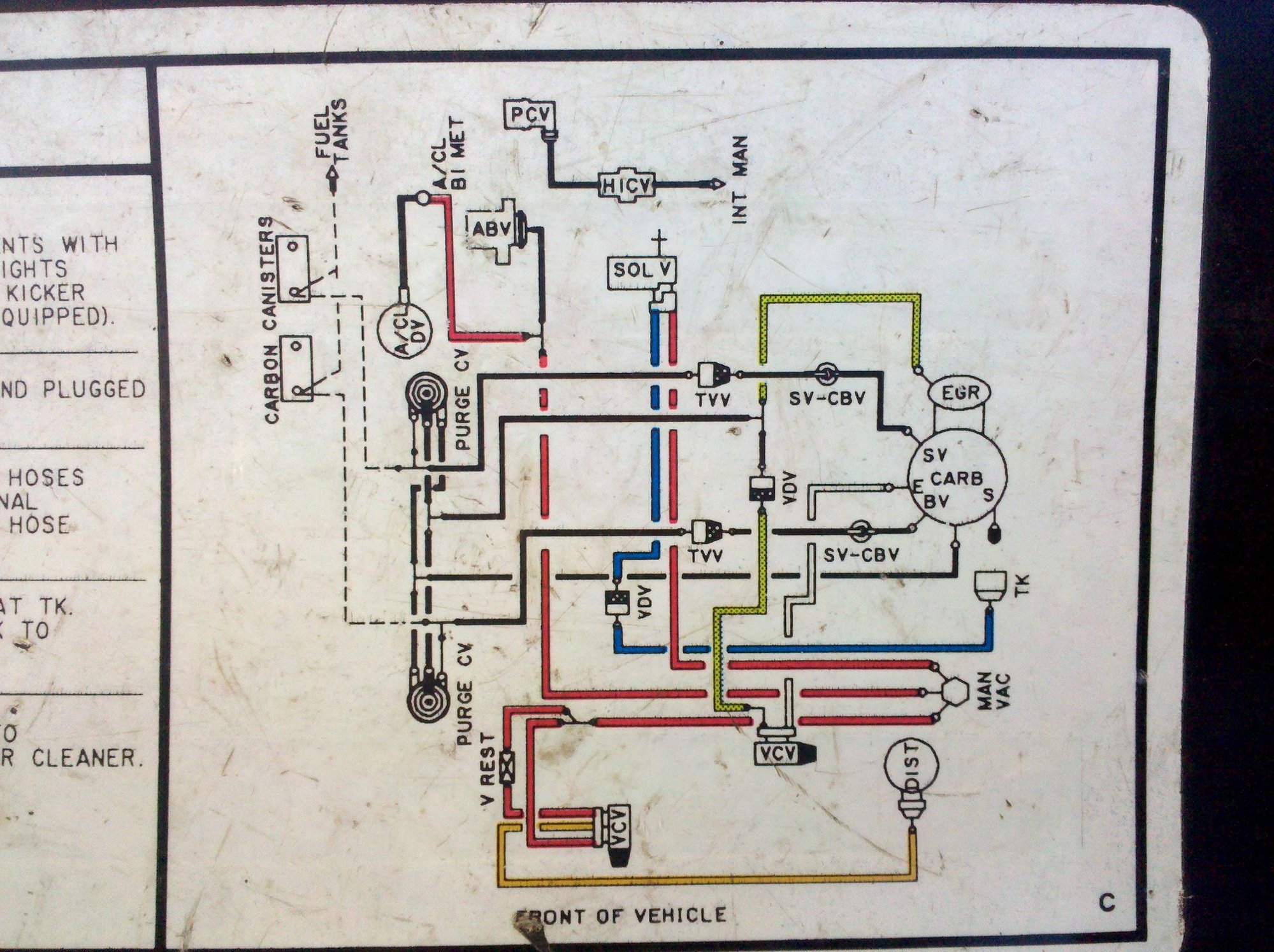

The way my engine was setup .... stock .... according to the vacuum diagram is that it runs full manifold vacuum to a temperature switch that gives restricted manifold vacuum to the dizzy under normal conditions and switches to full manifold vacuum when the engine gets too hot. I have eliminated the temp switch because I installed a new thermostat housing (old one cracked) and could not salvage the old temp switch. I have the dizzy running through the restricted line to manifold vacuum so essentially it is the same as it was and it is the way Ford set it up. Now my issue is that I think whoever owned the vehicle before me messed with the dizzy too much because even with vacuum advance at idle 32-34* was too much (in my opinion) .... so all I did was dial down the dizzy spring so the total base+vacuum advance at idle is 22* now. Still idles high but not as bad ... and it still follows the factory setup. I guess my only reason for posting this was to get opinions on what I did and if 22* at idle is a better number than the 32-34* .... basically just asking someone with more knowledge to 'check my math' I hate these damned CA emissions setups but I have to keep it this way if I wanna pass smog in October.

Since you have a manual transmission you could go either way on the vacuum hook-up. I am suspicious though that something is still not correct with your hook-up, but I don't have the diagram for your engine handy and if I remember correctly, the one I saw was pretty complicated. What I don't understand is your reference to a "restriction" in the path to the distributor. In my mind a restriction would definitely slow the reaction of the device it was controlling, but over time you would end up with the same vacuum as manifold wouldn't you? Unless there was a way that it bled the vacuum off?
I would try the ported vacuum just as a experiment. I don't think it would hurt your emissions, it actually sounds like it would help it. Getting rid of that timing will let you open the carb back up letting more air in, and giving you better adjustment on your idle air mixture screws.

Here is the vac diagram under the hood. You can see the vacuum advance is run to a valve on the radiator thermostat housing and connected to manifold vacuum... one line out to the dizzy is full manifold vac while the other has a small in-line restricter but is still manifold vacuum. As I understand it the reason for this is that at normal operating temp the dizzy gets the restricted manifold vac but when temp rises above the valve set point it switches to the full manifold vac to raise RPM's further to help cool the engine by way of more advance.... I have removed this thermostat housing valve and have the dizzy hooked up to manifold vac through the restricted vac line so essentially it is the same as stock. The only thing I have done in addition is dial back the spring screw in the dizzy vac pot to bring the additional advance from vacuum down to about 12* for a total advance at idle of 22* (10*base+12*vacuum advance). However .... before I installed the remanufactured 4180c carb I was able to get the idle down further by using the curb idle screw .... now I have the curb idle screw all the way backed out and I am still getting to high of RPM's at idle .... and that is with less advance at idle as well so that confuses me even more ... I thought since the advance at idle is about 10* less than it was when I had the other carb and was able to get use from the curb idle screw then it would actually result in lower rpm's now but that is exactly the opposite of what I am experiencing confused as h*ll over this one at the moment
