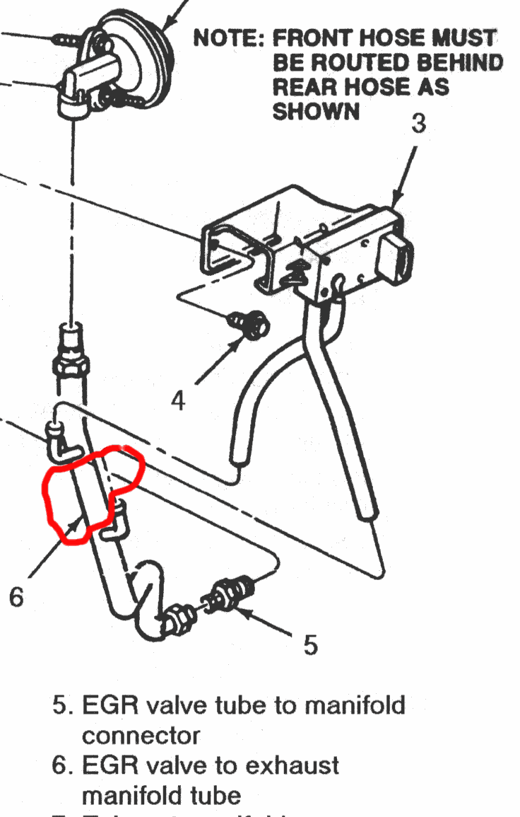

Did replacing your EDPF (Exhaust Differential Pressure Feedback sensor) fix your problem? No. 3 in the diagram below:
No. 6 in the diagram below:
The reason I ask is that I have a similar surging that's pretty bad, but only every morning when the system goes from cold (open loop) to hot (closed loop). When the temp gauge gets to a certain point, the surging is bad for maybe a mile, then as it warms further the surging becomes nearly undetectable -- I can only feel it occasionally for the rest of my commute.
I've replaced the EDPF sensor, made no difference in my case.

There is a small orifice in the EGR tube in between the 2 spigots that feed the DPFE sensor aka EGR transducer.
The orifice plugs up with carbon for numerous reasons, short distance driving etc.
Tube is NLA from FoMoCo.
Clean orifice with small diameter stiff stainless steel fishing wire and Chevron Techron Concentrate.
I replace the EGR valve and the DPFE sensor with no cure, cleaning the orifice brought mine back from bronco bucking.
Is it located here?
Old Jul 11, 2017 | 10:57 PM
96_4wdr's Avatar
96_4wdr
Joined: Apr 2005
Posts: 5,720
From: Washington state
Yes, enjoy the contortionist workout and busted knuckles. Typical under hood Aero job.
